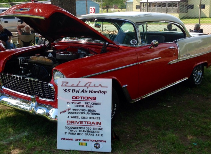

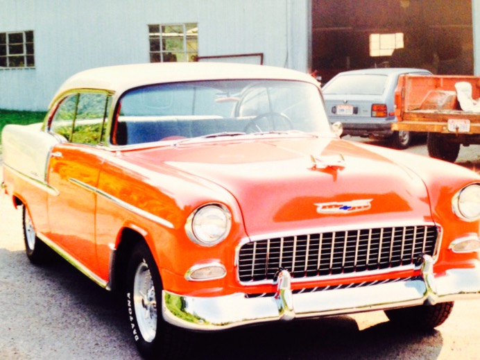

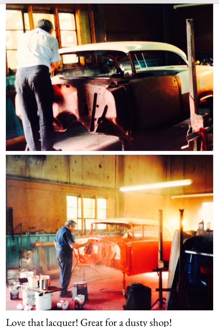

    28 year old lacquer job on dad's ol' 55. Dusty old gm dealership body bay. Looks as good today as ever. Binks #7, Dupont Lucite, used retarder to lay down last coats, 1950s Souix polisher with huge wool pad, 202s & 101s Dupont rubbing compounds looks like new any time I feel like polishing. This stuff lasts great when applied properly. image.jpeg took from post "our 55 then & now" image.jpeg Added cragars 20 years ago
    image.jpeg Sir I would definitely buy your lacquer for my future projects! Flux

    Sometimes I wish more people wouldn't think I was a paint guru and I could enjoy a day with a cell phone that goes straight to voicemail! Lol
    A job like that, you don't need to hire anybody else! Looks great!

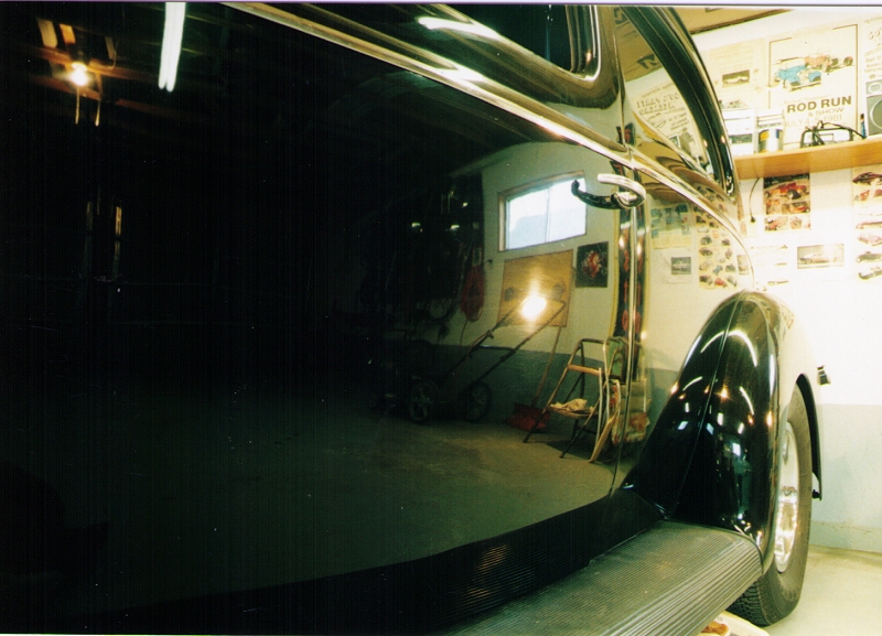

    Back when lacquer was "good" you could cut it so fine without excess paper build up that it could be buffed with final glaze and a Souix 1211 bonnet/pad. My glaze when I started doing this was, and still is, Meguires #3. Before the intro of 3000 paper I used to save worn out 2000 for that purpose. I'm not certain of the molecular structure except what was told to me by my tech guy, the removal of what he called trace metals. As mentioned before in some topics that became tutorials of sorts, the use of mild soap for additional lubrication helps prevent the dreaded "squeek" of melted material scratching your hard work. In it's best days most lacquer, with the exception of clear, wouldn't build up even without soap. Just a steady stream of water and it was all good. Going way back, old timers used corn starch as a swirl remover but we have a cornucopia of such product today and many of them do really well. Whatever has to be done to bring that characteristic back and be able to market it in our environmental PC world should be a winner. I was also told by my tech guy that many base coats are nearly the same as lacquer in it's early days of base/clear use. True, false, or something in between? I know there's only a finite number of plasticizers, binders and solvents in the industry so I thought it might contain a mode*** of truth.
    Hey Darrel, diggin the Motor wheels. Don't see those very often.
