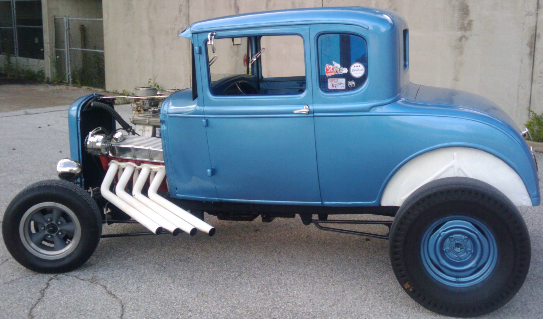

    my old school 40 stude coupe g***er setup

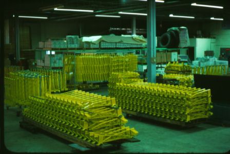

    someone say ladder bars?
