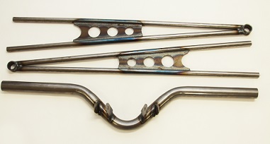

    The T/A's i make are used on cars that have the rear located by links (not leafs), so we have very little fore/aft movement of the linkage as the suspension goes thru it's travel. We've had as good as 1.3sec 60' times with one, but if the car has that much power, the tunnel's gonna need some reinforcing ;)
    Handles nice and goes straight, but goes around corners too.
  4. CalGasser
    Joined: Apr 11, 2005
    Posts: 793
    CalGasser
    I like the idea of a shackle in the front in lieu of a slider at the housing, especially if you have a car already together.
    My questions is has anyone tried this shackle setup on the track? :confused: I'd think under load, there'd be a lot of action going on and a lot of stress. Theory is good but would love to hear some actual proof. If you've done this, how thick material did you use for the shackle? Thanks!

    Neither will them being parralel and mounted so far apart i'm afraid.

    The shackle plates are 1/4". I've been building these solid axle TA conversions for years, to replace the IRS in customer '86-'91 Maxda RX-7's. Use one in my personal OT street/strip car too..5500rpm clutch dumps, drag radials, trackbited/gold dusted tracks... http://grannys.tripod.com/20102.html

    why are all these ladder bars pointed up so high?
  9. grantzky
    Joined: Jan 31, 2012
    Posts: 2
    grantzky
    from toronto
    use the trans mount crossbar for the forward mount

    You're right! S/S Ford teams used them back in the early 60's. They were more of a "reverse traction bar" and seemed to work quite well. The F/X Fords used the ladder bar style. They were rectangle tubing that were fairly long, about 48" I think they used a shackle up front to stop the bind. bowtie40...

    One of the million sets of Lakewoods. Did'nt have shackles or floaters and they were binding. So I changed to the *******s

    Those "welds" are truly scary. I'm not talking about their appearance alone either, but by the looks of 'em, I see inadequate penetration. They need to be repaired...

    This is what a decent and SAFE weld should look like ...

    I have been a master mechanical engineer for 20-years, a certified pro welder for 27-years, a welder for 36-years, and most importantly a welding inspector for 15-years.
    Your welds are not safe. You are placing yourself, and everyone around you in danger, for the sake of foolish pride.
    Hurling insults is the behavior of a small man.
    Rise above, and fix your welds.

    I have first hand seen those pretty welds brake on ladder bar brackets welded to a rear end housing at the track.
    And I have seen welds that don't look pretty that you could not jack hammer apart.
