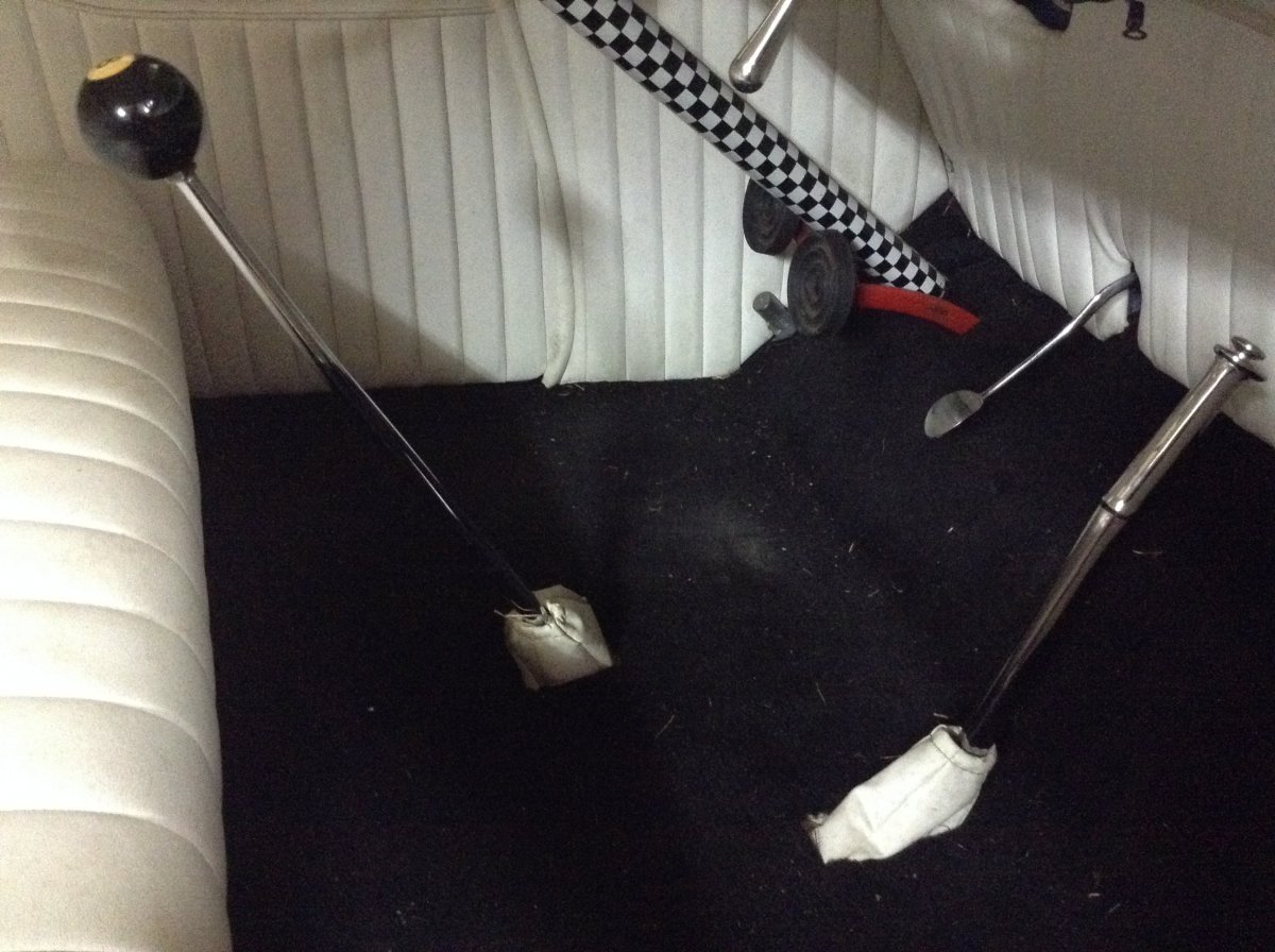

    Looks like I got your attention with my heading.i have a 30 model a coupe.on 32 rails.sbc .question is I'd like to run a Muncie.but don't like shifter location.is there any other ******s
    That would have a better shifter location?ie not so close to seat.i read t&f used to make a top mount shifter for Muncie,but no longer made.

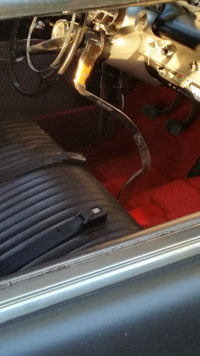

  7. C69A
    Joined: Jun 6, 2008
    Posts: 90
    C69A
    image.jpeg image.jpeg If you have a Muncie you can just move the shifter forward like I did in my 32

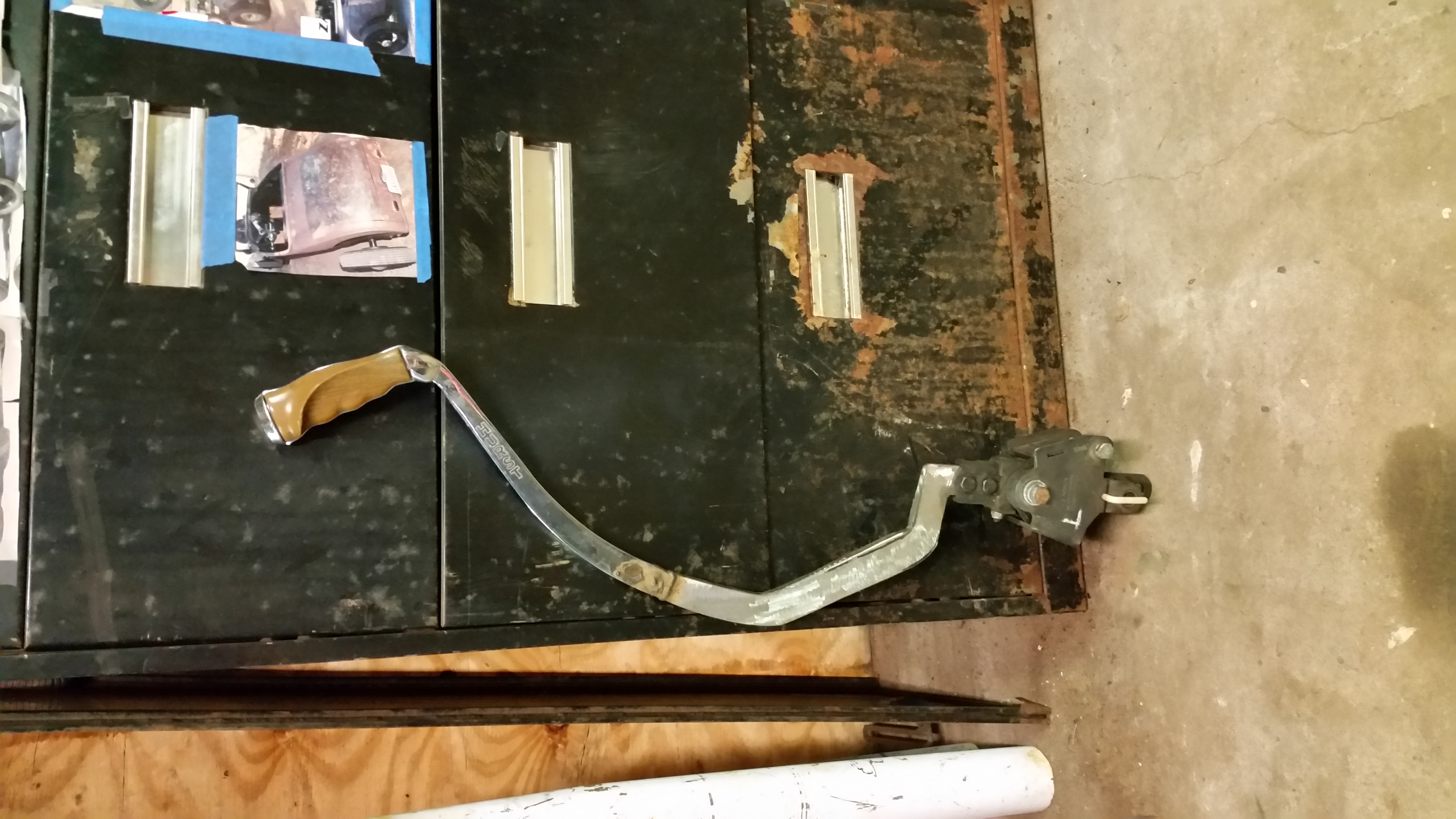

  8. Hurst shifters have some adjustment, they can leaned forward or back.
    The slot on the lower left is the adjustment.
    A link to Hurst shifter sticks.
    http://www.hurst-shifters.com/product-category/?slug=shifter-sticks-service-parts
    lothiandon1940 likes this.

    I've gained room on a few Hurst shifters by rotating them forward five to ten degrees.
    Some are easier than others, depending on whether the mount is a flat plate or the stamped steel version, most have enough adjustment in the rods for this.
    Leave the big center bolt slightly loose then rotate forward and transfer the other attachment bolt locations and drill and tap the mount.
    On the stamped steel type mount I made a threaded insert and welded it in at the new location.
