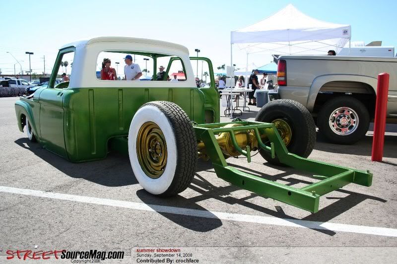

    the taste thing doesnt bother me, i could care a less if people like what it looks like ebcause i love how it looks. But i felt like you where directly trashing me and that pissed me off.
    But in just. The design is going to change slightly. Im going to keep my front bag mounts. and the rear isnt going to change at all. But the Ibeams are going to come out for sure. Im going to build my own IFS, using heims instead of ball joints, so if anyone has a good write up on how to do that and/or advice let me know. I was going to do them out of 1 inch DOM 120 wall.
    For the bag mounts im going to build an "upper cage" I dont really know what to call it, but when they tube the front of a factory stock car and it has the tube going on the side of the engine and infront of it. Thats what im going to do, but its not going to come from the firewall its just going to come up from the frame infront of the fire wall and wrap around the entire front of the engine bay with a few peices connected to the frame and the bag mounts to add stregnth. I want to move the wheels in about 1 inch so that i can turn it when its lower. and be ok But i am going to try and use the spindles i have since ive invested so much money in them. if thats a bad idea, and there are a cheap set of spindles i should pick up with a power rack and pinion let me know. im just going to modify everything around my factory crossmember because to me its not worth cutting the front half of the frame off and redoing it, unless i can find an insanely cheap crossmember off some other car. nearly free.
    im not discouraged, i was just pissed off because i had a lot of positive feedback untill just the otherday when i got all that negative feedback it was hard to take. But anyways, the project will move on i have a few other things going on in the shop right now. 04 ranger i just pulled the front A arms out and wrapped them with some nice bag cups on them and sleeved the frame spring cup out with 5 inch OD pipe and made new bag cups. THe previous owner just had the air bags sitting in the spring cup bolted with 1 bold to a peice of pipe.
    anyways heres some pictures from the show

    I've read this post from the beginning and here's what I think you need to step back and look at closely...
    "Feeling" the front mounts are ok and it "looked stout" is going to lead to problems.It might hop now,but what about the guy that buys it and is showing off to his buddies?
    "the rear upper bag mounts seem to be stout as well", up until they fail at 50mph.
    "But i have so much invested at this point its not a financially correct decision to fix everything i would like to because ill never get it back out of it."
    Now might be the time to suck it up and fix what can/will fail.
    "But, it was the first vehicle i ever modified. and this far im happy with how it came out. Live and learn, was anyones first build perfect?"
    Probably not,but when you posted on here looking for advice/comments and you get replies from some VERY experienced builders that have "been there/done that/tried that",you might want to step back,and re-evaluate where the build can be modified for safety.
    You have built this to sell,hopefully the person that buys the truck is happy with it and doesn't have problems. But what about the "next guy"?
    Are you prepared financially/emotionally to have the guy come in with a horror story of something breaking and he loses control of the truck?
    Your name is going to be associated with this build for good or bad.
    I/we hope it goes well and you have a problem-free build.
    It is your build and you have the final say in the outcome.

    First off I will say that I dig the truck man... cool project and you do have some talent for a youngen. Now I will give you the advice column :) Twisted left you some pretty damn good advice as well as several others so I will try to not be as redundant as possible.
    front suspension.....
    Good execution, bad idea. Keeping those brackets the way they are will result in you eventually replacing the brackets and filling the holes in the frame where your tubing rips from the gusset and the frame. If you are going to keep the design up there, all you need to do is build you a reinforcement bar... kind of like a big shock hoop on a 4wd truck. I would run that gusset laterally and attach to a fender/ strut brace bar. like what you would see on a strut style pro mod car. That will help distribute the sheer load over a much broader surface.
    If you are going to try to fabricate an IFS into the front of the truck ( which is the ultimate way to go because i beams suck twinkies) I would suggest that you fabricate it off of a known platform. That way you can base it off of proven existing geometry. You can get into so stupid wicked problems when you start screwing with bumpsteer and ackerman issues and essentially make that truck not worth driving. Believe it or not, if it were me, I would base the front suspension off of a 63-87 Chevrolet C-10. These trucks actually really descent geometry plus there is a plethora of aftermarket and relacment parts available for it. To top it all off... those crossmembers are a complete bolt on front clip which makes them easy to modify and you have companies like Porterbuilt out of Phoenix who are making aftermarket crossmemebers that you may be able to fab in there as well.
    rear suspension...... The way you built and double stacked your tubes, is rockin -roll and you will probably never have an issue with it. Like twisted said, ideally you would want the peak of your truss to be direcly under your load path. You also want to keep those bars with no lateral bends in them ( keep em straight ) The bends look cool but that load force is going to play hell on your bushings because it is going to constantly trying to preload one side of the bar. Even when you do a straight bar, you want to keep your airspring plate as centered over the bar as you can get it. This keeps the load evenly distributed across the whole bushing.
    Airsprings....
    Whenever designing and airspring suspension you primarily have to focus the airspring parameters. Max height, minimum height and most importantly ride height. Your suspension paramemters need to be based on your ride height of your airspring. We all know that you can delfate from there and inflate from there.... thats just the happy coincidence. If you want everything to live a long happy life though.... that is what it needs to be considered. When you are designing your mounts ... again with the airspring at its proper ride height... you ideally want your upper and lower mounts to be on the same parallel plane as each other and you want them to be as centered with each other as possible. Who cares what it does deflated or inflated all the way. One of the fastest ways to tell a rookies is to look at his mounts... they are usually square and parallel with the vehicle deflated all the way.
    last but not least.... the show whole show truck line.... You cant live by that man. Someone else may own it someday plus more than likely, you will eventually get in the thing and make a blast down the street.... dont make yourself a statistic just because you didnt want to take the time to figure it out man....
