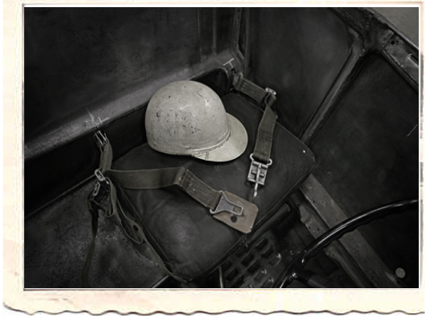

    Anyways... Here is the series of shots on the seat belts
    The goal through out this build was to have the body removable... so, we attached the brackets to existing tube that supports the gas tank... first the mock up...
    then the placement center brackets will be shorter because a relief was set in the body
    The ends of the belt will go through the body

    The individual plates were welded on both sides as they were added... then a tube was welded in to maintain the proper space shown above (replacing washers used in the jig)...
    Overview shows belts attached... slots were made in the rear body panels for the belts to fit through
