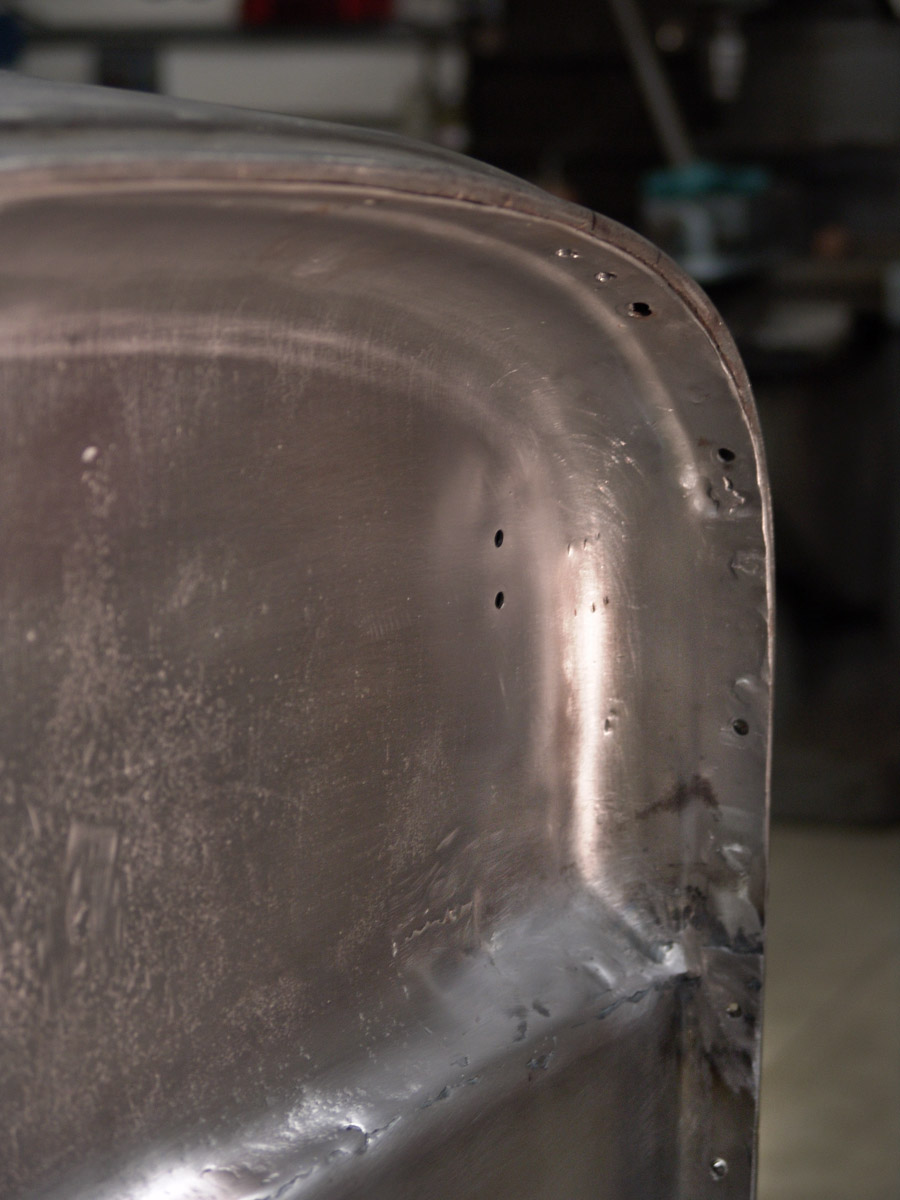

    I thought I'd post some pictures from behind the scenery (Whippet shell)... first it is an optical illusion... Ford suspends the radiator on mounting tabs off of the vertical tank side straps... from what I can determine the Whippet lays directly on the sheet metal... so we did it a little differant... a formed 10 Ga support becomes an extention of the Model A front crossmember... the radiator sets above the support and the shell below it... so if the axle wouldever come in contact with the frame it would protect the radiator... the frame horns were then cut off and visually all you see is the shell
    Additionally, thanks for the critical eye and comments... it doesn't pay to miss anything that wasn't thought of during the construction stage... and if ya look close you will notice that the center of the three point suspension is inline with the crank and the frame center is the water pump/fan shaft... gotta love those Y-Blocks

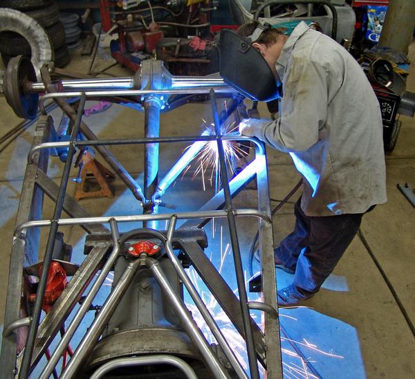

    Side panels and lower firewall in... now back apart to hammer weld the firewall and louver the side panels

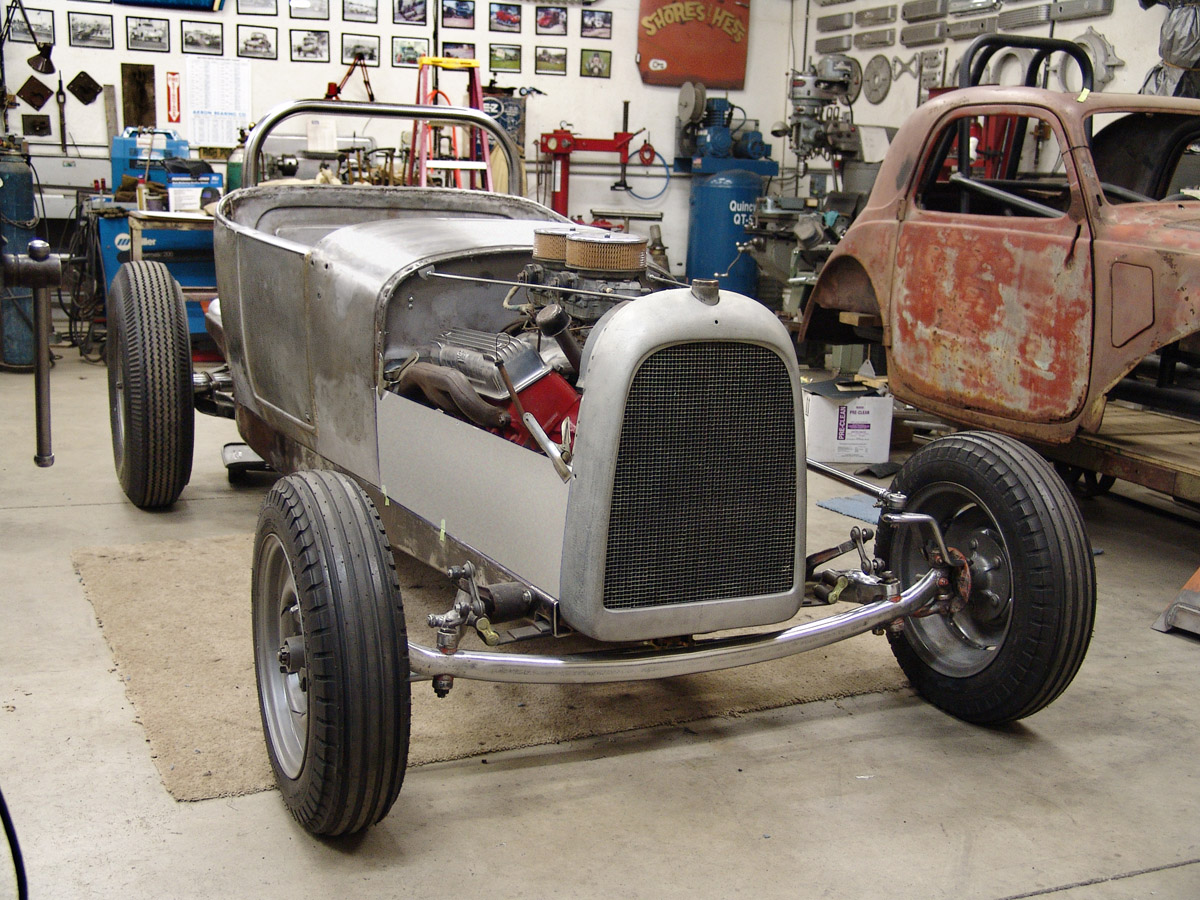

    Well it back apart so it will just be detail shots for awhile... here is the unfinished front Belly pan section leaning up against the backside of the shortened 18 T turtledeck... a overall shot to give a perspective of size - 95" wheelbase and it sets pretty low for untilizing a three point suspension and non-dropped axle... then we have guard dog checking out todays progress!

    More Pixs... Hey Brent if the T is as nice as the A your putting together is will be a nice ride

    Detail shots of the front Whippet radiator support and side view

    Starting to rework belly pan

    The louvered center panel were welded in which wasn't the best way to go... the side panels were formed, drilled/tapped, and attached with button allens... more work better finish, future access, and repair if someone gets crazy
