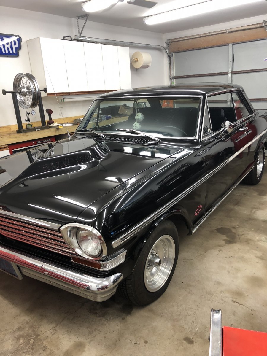

    Here it is

    Sorry to hear those are the cir***stances. Glad you were able and willing to keep it in family the best you could.
    ...and it is pretty effing sweet.

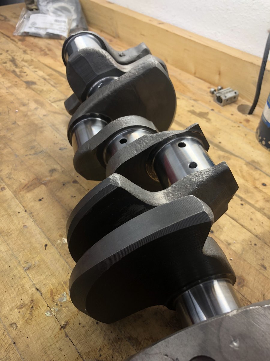

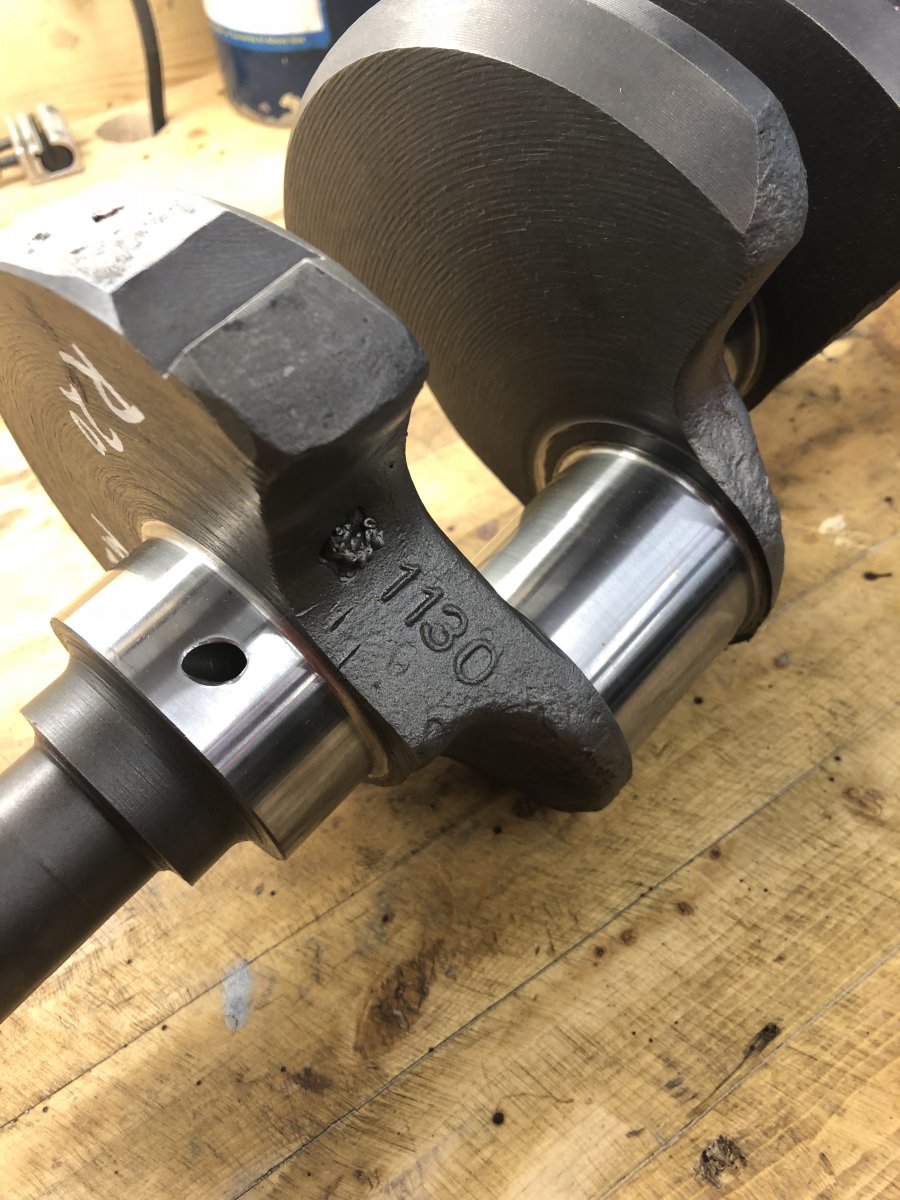

    So I got the crank yesterday but have some questions. It was sold as being forged but not sure if a forged unit would have the full 3951130 number on it as this one only has the “1130”. It has the wide parting line and other forged characteristics though. Thoughts?
    1Nimrod and Deuces like this.
  21. Deuces
    Joined: Nov 3, 2009
    Posts: 26,856
    Deuces
    Not sure if GM cross drilled the large journal 327 forged steel cranks..... Might be something to look into......

    I just found your old Post. I have the same crank 1130 is cast into the crank not the full # so it can be confusing but the thick casting line tells what it is. Here's picks of my 1130 Forged steel crank. Hope you get your 327 up an running. I owed a early Chevy II back when I was younger it had a 400 with a 4 speed muncie and 4:11 posi I traded my 56 Chevy 210 with a 454 in it for the 64 Chevy II I'd like to have them both back but long gone now. I crashed my Honda into the side of a cube van back in 1985, I was in the NCU for several weeks so I traded my Chevy II for a nice stock 84 GMC pickup I was afraid of speed for a few years after crashing my Honda. I later put together my 79 Z/28 and that was my last Hot Rod back in around 1998 until I bought my 63 C10 pick-up in 2016 now doing a 327 I've posted about it and the not so good speed shop doing me wrong but that's in the past now. But I can't find a picture of my white Chevy II maybe I'll find it someday?? But here's pics of the 1130 crank an my 56 Chevy 210 and my 79 Z/28. Good old memories LOL... And my 63 C10 pick-up, needing new Windshield in Pic with my youngest Granddaughter & me. Have fun with that sweet "Loose Deuce"...
