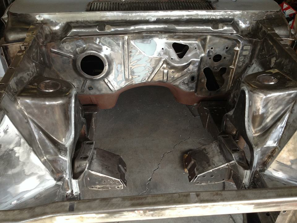

    Looking to buy one and a 289 looks tight,I was planning on using a 351-w that's presently in my 55 Sunliner so will headers be a problem and would a 390 also fit.

    Yeah, FE fits alright.

    351 Windsor is 1” wider than a 289-302. If you’re handy with a welder you could easily trim back the shock towers and fill it back in.

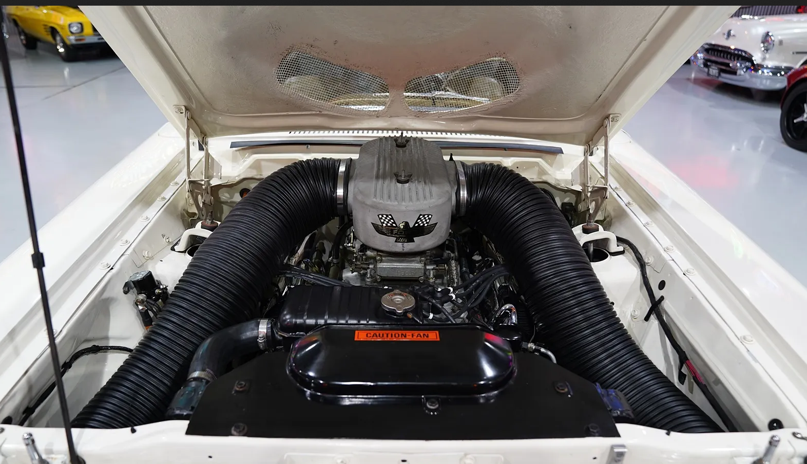

    They came stock With 427 side oilers.

    The 351w should fit without modification although spark plug access is limited. I had a Boss 302 in my Comet without any modifications. (The Cleveland heads make a 302 block quite wide)
    Fairlanes have a larger engine bay than a Comet/Falcon.

    They weren’t stock, as in built on an assembly line.
    They were dedicated race cars built by Dearborn Steel Tubing, if I remember, under contract to Ford.
    Nevertheless, it shows that it can be done, given enough skill and resources.

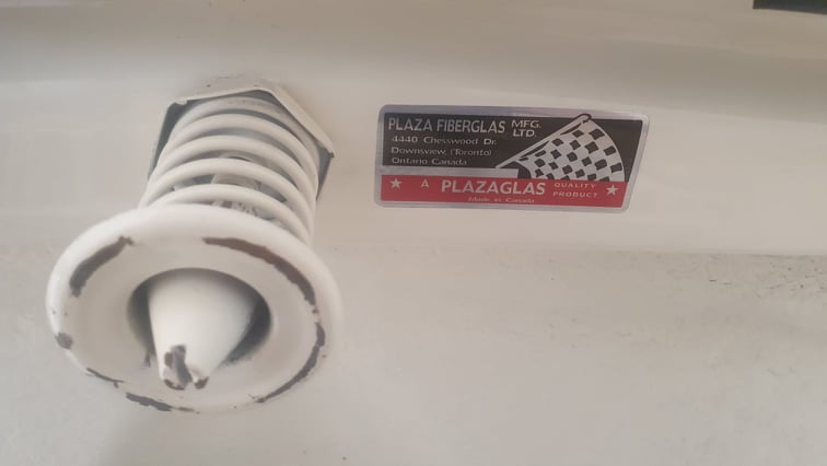

    Correct, Dearborn Steel Tubing modified Fairlanes into Thunderbolts and Comets into A/FX’ers. (Calientes in ‘64 and Cyclones in ‘65) All the fiberglass parts were supplied by Plaza Glas in Toronto.

    Yes, anything can be made to fit with enough time, money and talent, but why bother? Today's built stroker 302"s will make all the power you need.

    If I get one I was planning on a stroked 351 since I have three in the garage but do have a rough 65 Galaxie with a 390. I know the FEs would require some surgery so I will stay with the small blocks.

    You can fit almost anything into any car, providing you've got the skills to do the modifications to make them fit! And the modifications to the chassis and drivetrain to handle the power those bigger engines can put on the car itself.
    I was told I couldn't put a BBC in my '63 Falcon gasser, but it worked, and handled the 550 hp 464ci BBC with some major frame mods, and good drivetrain.
    I did have to modify the shock towers.

    The purple '63 Fairlane stuffed up against the wall of my shop came from an old friend who passed on. He had originally planned on stuffing one of those ridiculously wide 4.6L SOHC motors in it from a mid 90's Lincoln. The shock tower to mod motor kit is in the trunk, I just had to weld it in. I plan on putting the 351W sitting in front of the car into it, and sold the 4.6L a long time ago. My point being, if you can get a 4.6L in there, a 351W or FE, will be a piece of cake.

    A buddy of mine had a 64 Fairlane with a 351C in it, until he sold it a few years ago. It bolted right in but took some clearancing on the headers.
