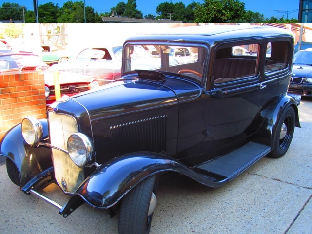

    I know this is an old thread, but there is,i think more than a tire rake going on here.Anyone know? dropped axel? how much. How do you get this stance? I"m looking a a 32 sedan, and thats prolly the perfect stance
  11. Malcolm
    Joined: Feb 9, 2006
    Posts: 8,189
    Malcolm
    from Nebraska
    I'm only guessing here, but I would say a dropped axle for sure and quite possibly a 'flattened' front cross member or a Model A cross member in it's place.

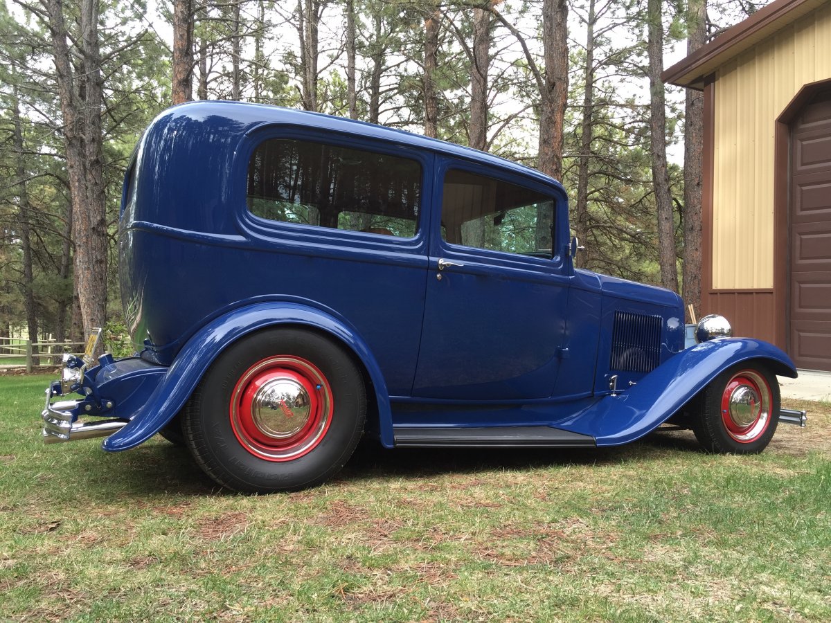

    This is my sedan. 4" dropped axle, mono leaf spring and a model A crossmember. In my opinion you need a big tire out back to fill the fender. My rears are bfg 255 70 and the fronts are 155. IMG_0752_2.JPG

    Maybe a notched frame as well?

    thats pretty wicked looking also!! thanks
