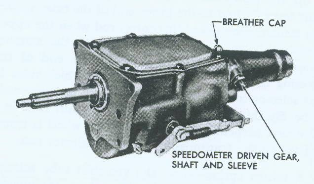

    The pic is from Revheads link...this trans dates back to at least 51 on the Olds. Ahh, the infamous selector :)
    There were other GMs that look identical, including the top cover and main case, but they had smaller shafts on input/output.
    If you can find a 37 Buick bigger series trans for it's donor case and top=shift cover, I can do a tech on how to swap all the guts from the above picture trans, into the 37 case. Oh boy, looking for more rare **** :) ...ain't this trad stuff a little frustrating at times, due to all the junkyards being gone?
