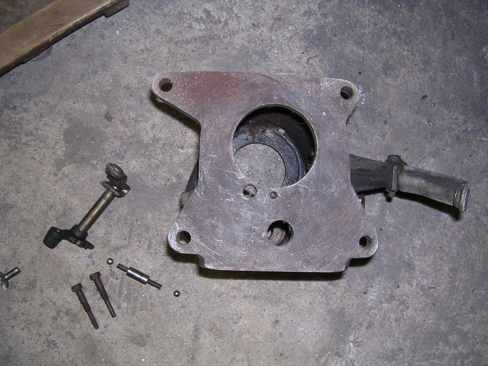

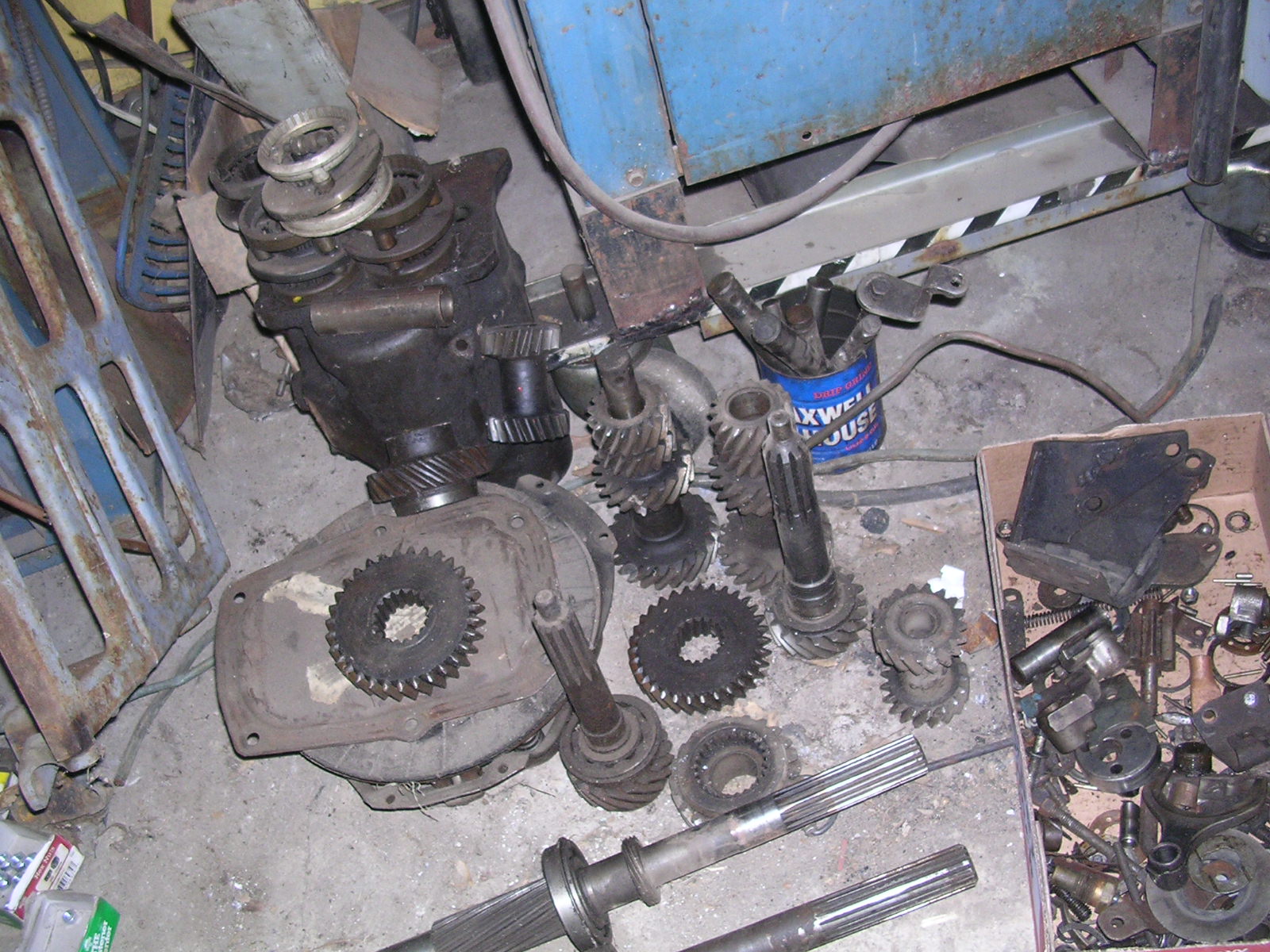

    Ok L.W., here are pics of the 50 Olds case and stuff. The case looks good. Both shift rods/levers are there. Internal shift stuff is there except one "fork". see below
    See the 2 pics with the yellow pencil; the small part in my hand is the rear shift fork and it goes in that hole where the pencil is.
    the other fork (front fork) is missing and I don't know what it looks like. That fork goes into the hole where the pencil is pointing (inside the case picture)
    one pic shows the ball bearings/sleeve which is the interlock/detents that goes inside the trans, right between the 2 fork levers. Easy to put together.
    also in that pic are the 2 hard to find bottom "long" cover bolts that keep the reverse idler shaft and cluster shaft in place.
    Also pics of misc trans parts all mixed up: some are selectors of various styles, and likely some LaSalle stuff, but I can't ID any of it. The 2 rear mainshafts are slightly different and may be selector stuff.
    Let me know ...

    Frank
    Is That suppose to be like that ?? Just noticed it ..My shaft has it as well ,,I thought it as a part that was chipped .

    The T-85 was also the basis of the T-10 four speed! Same case, rearranged innards, reverse gear housed outside in a new tail casting.
  17. all four of mine have the same thing. Whatever it's for, it's factory.
