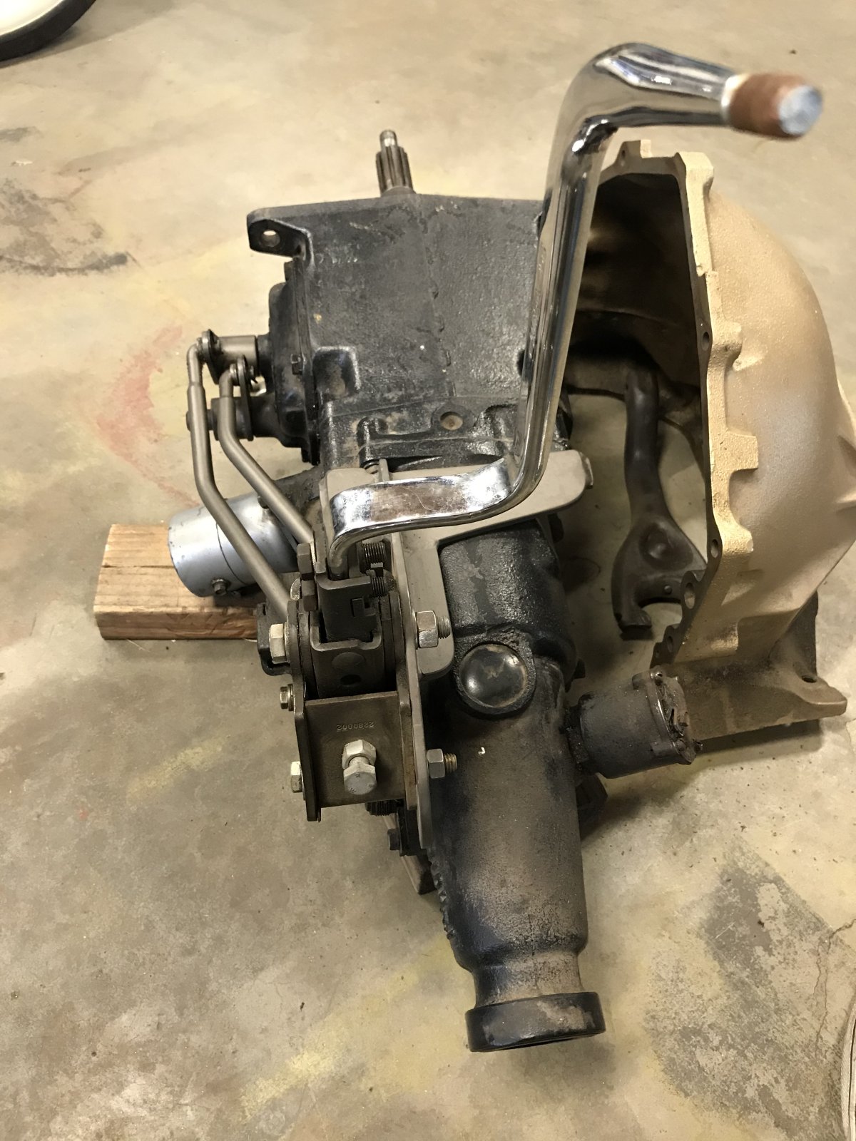

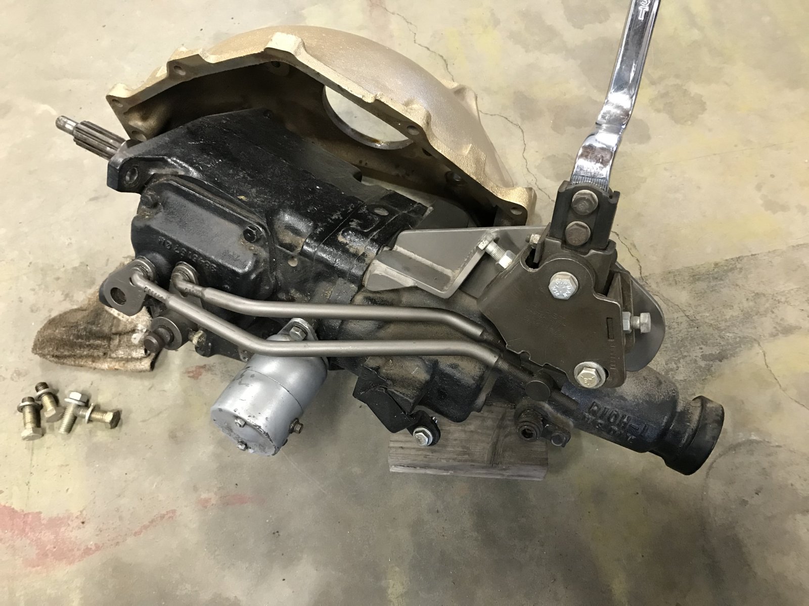

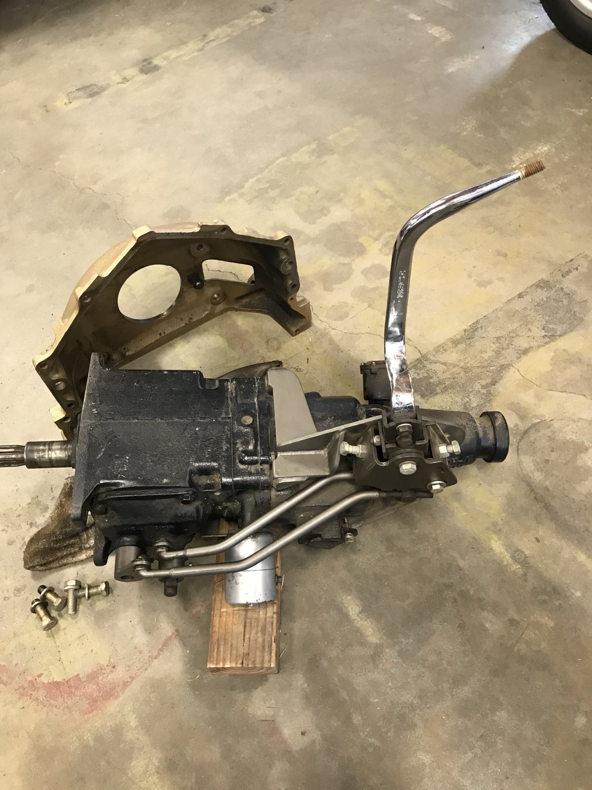

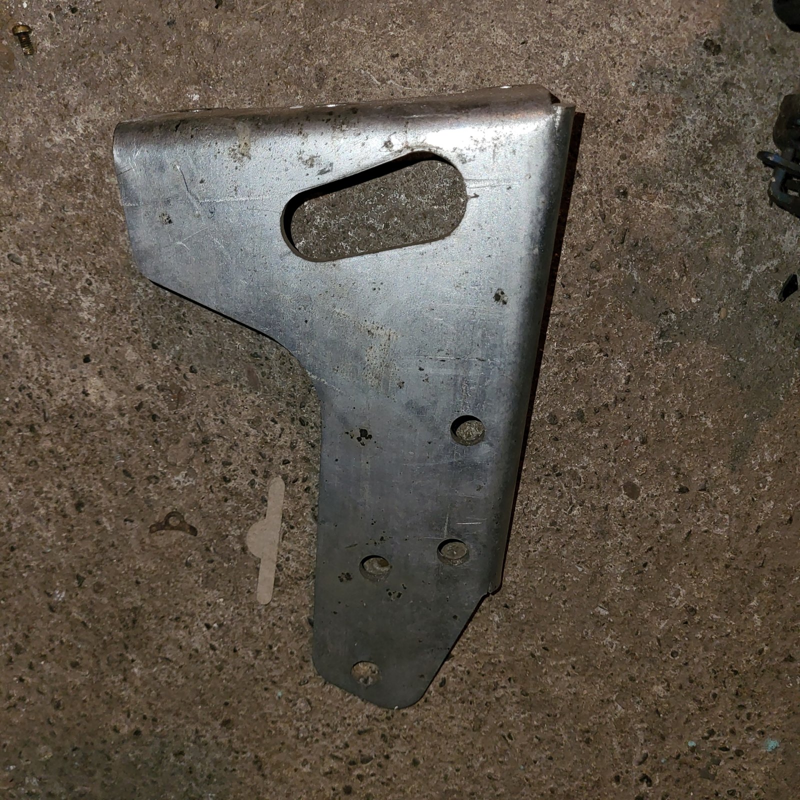

  8. I sold a NOS Hurst side shift conversion a few years back. Still kind of kick myself for letting that one go. I've got a side shift LaSalle with Hurst shifter on the shelf.
    Will try and remember to grab some measurements and pictures for you.

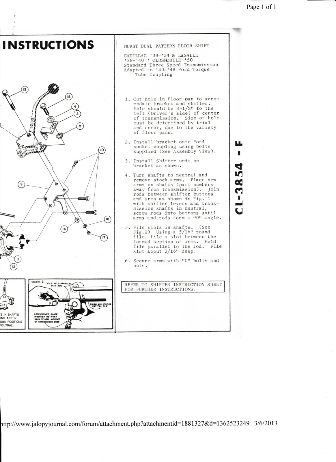

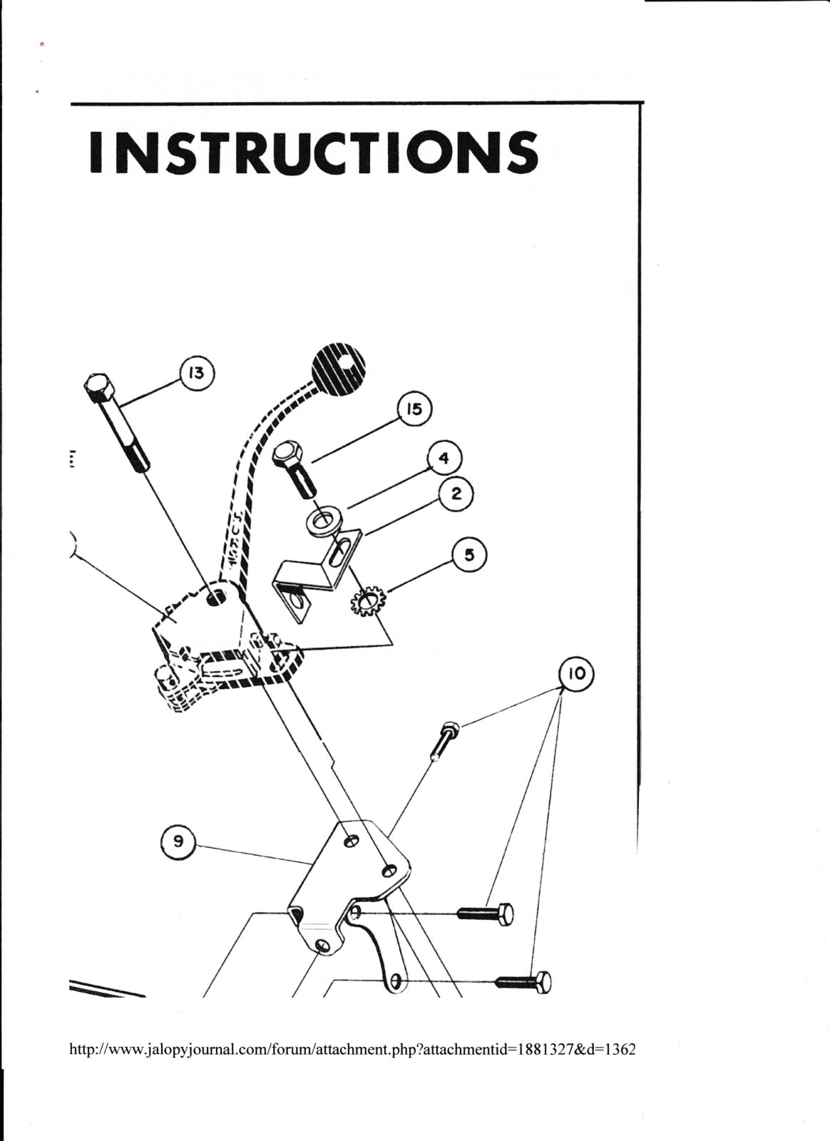

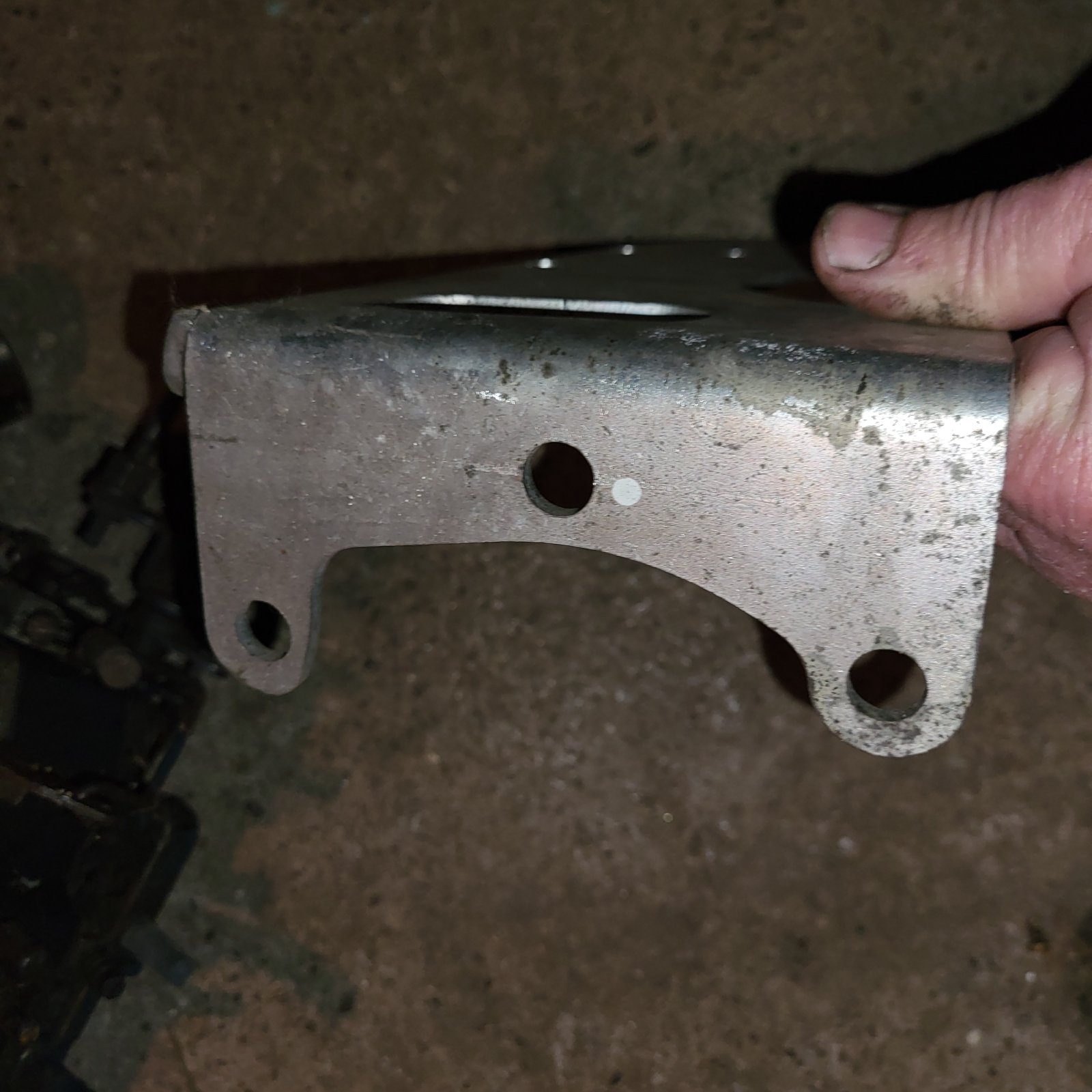

    here is all I could dig up in my file. Gives you an idea of the bracket you could make. Of course this shows it for the closed drive line application but I am certain you can engineer around that. There is also a support bar made from flat stock that connects the bracket to the trans bolt into the bellhousing. I have one somewhere. I will get a pic to you of it.

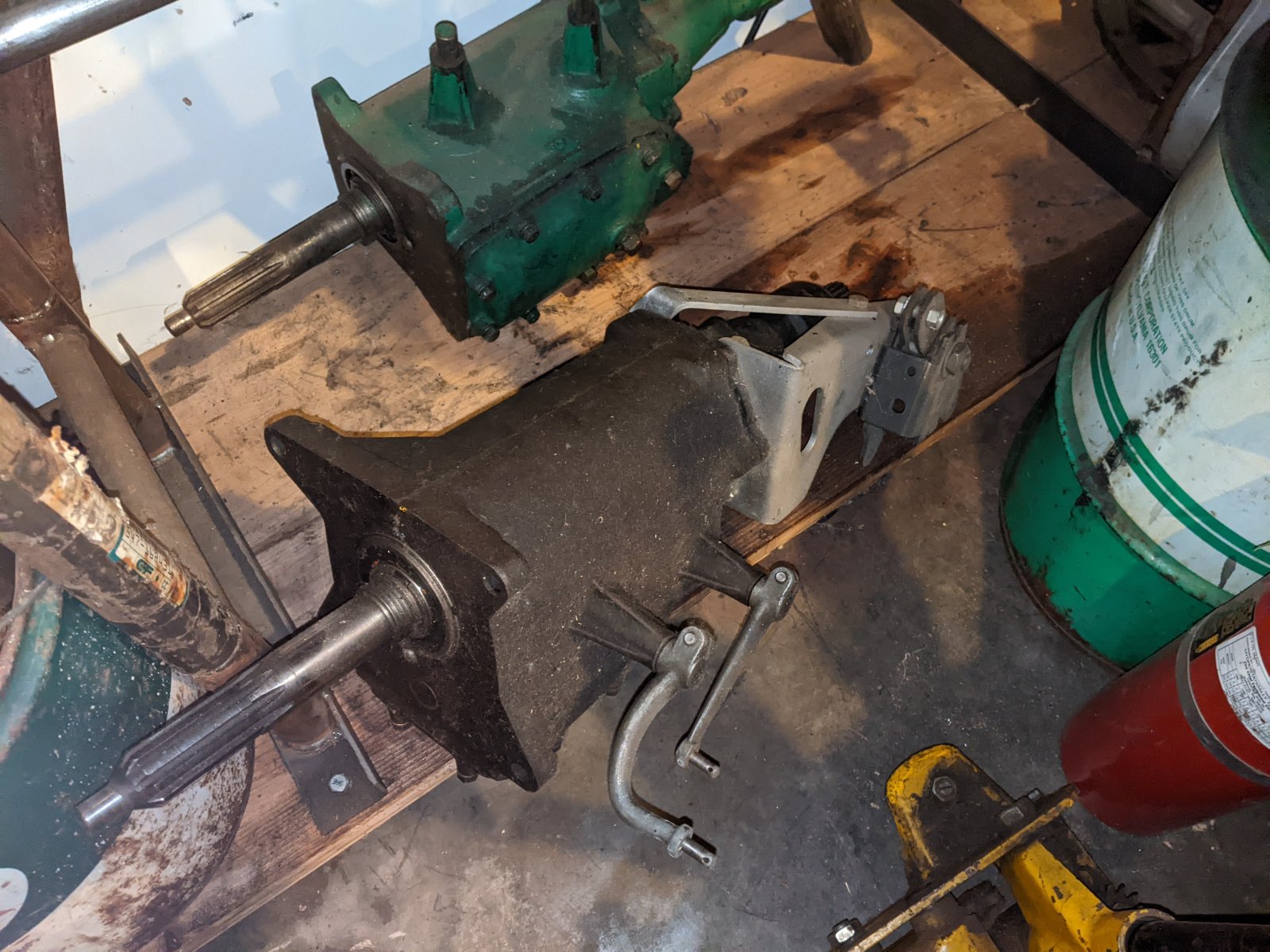

    here's a snapshot of one on a spare transmission
    I have correct rods, arms and stick somewhere..

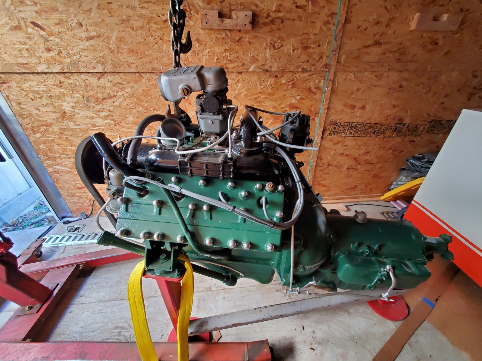

    Thanks again guys. The images will be very helpful for me and others. It gives me a good picture of how I can go about it. The most unusual part of my plan is I’m hoping to actually put it behind a hot rodded Cadillac flathead:).

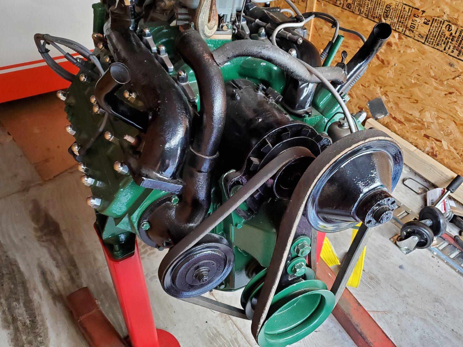

    Looks like something went awry with the picture upload. Note the water pump facing backwards. There were two of these side by side facing backwards in the tank. They sat at an angle so the carb mounting surface on the intake is canted. I badly wanted to mount the engine in a car on an angle, take it to a show, and wait to see if anyone got the joke.

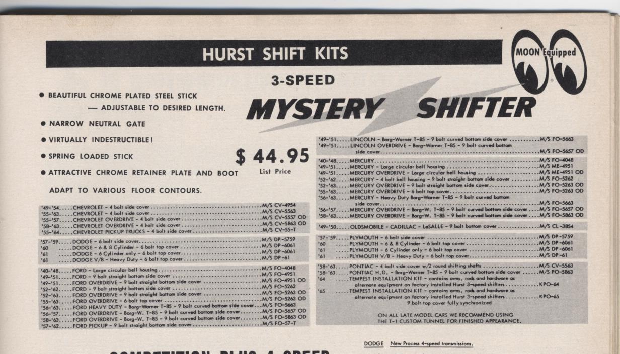

    '49-'50....Oldsmobile-Cadillac-LaSalle-9 bolt bottom cover....M/S CL-3854

    my neck hurt so I fixed this for ya
