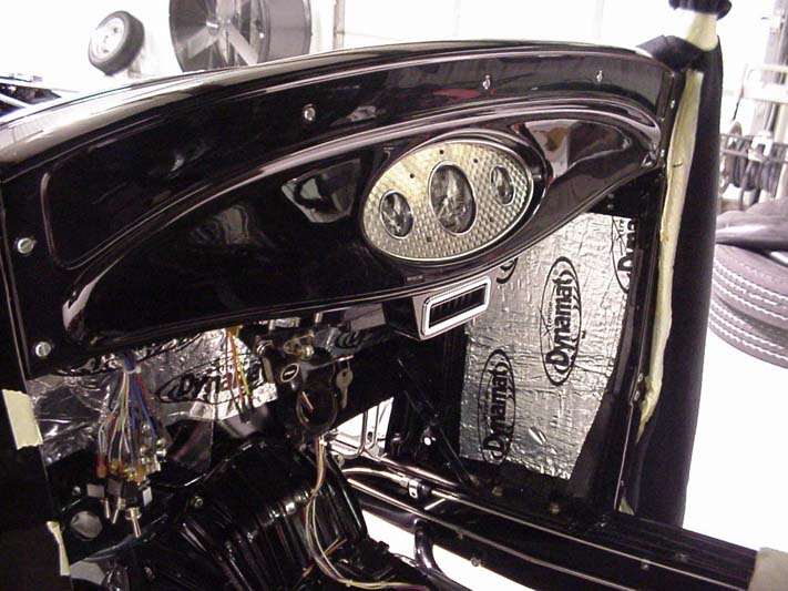

    this is the coupe i'm building for a customer.fired it up about two hours ago for the first time ,the 383 sounds killer.
    bass- how do you post a picture without it being a attachment?i don't know how to get a big picture on my posts.
    -danny

    Aman
    from Texas
    That's beautiful! What color is that? Looks like a dark red or maroon. It will really look good when you get some shiney wheels on it.

  19. hot rod pro
    Joined: Jun 1, 2005
    Posts: 2,709
    hot rod pro
    from spring tx.
    it's black,baby!
