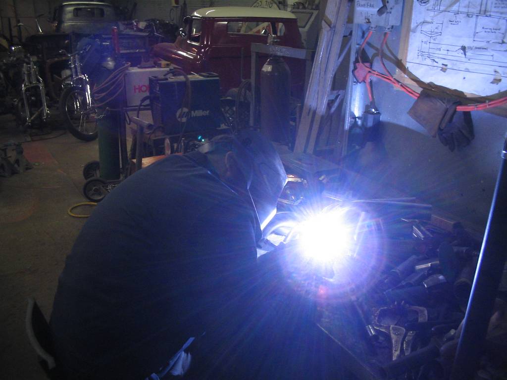

    Here is a couple of pics I took with Bass in action on his headers, along with a few others pics of the build up. Watching the build of this car on a daily basis has been awesome.
