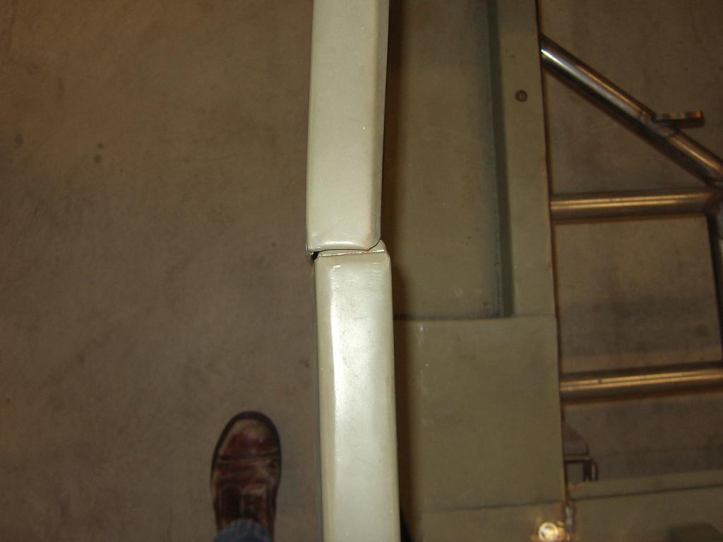

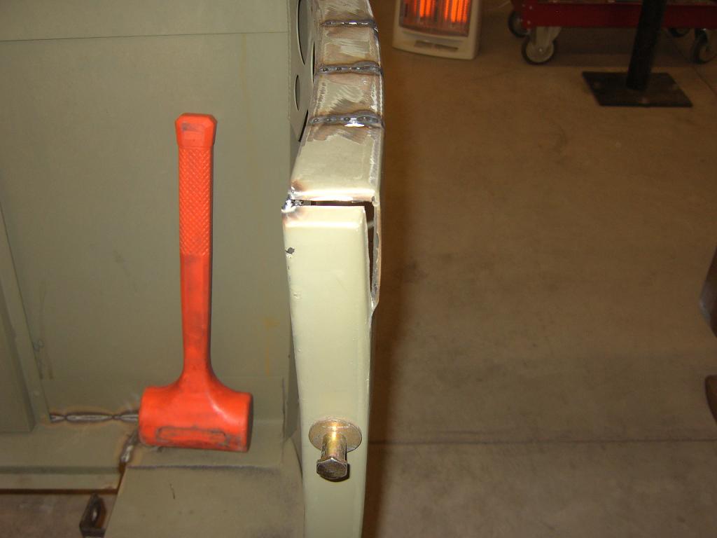

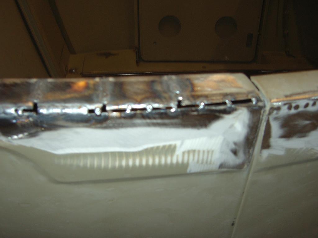

    Warning, warning, danger, danger! I bought a rpu package a while back. At first glance i was happy with my last refuge purchase but 300 hours of work later I would not do it again. Sorry to tell ya if you don't already know but that cab is primered for a reason. IT ALREADY HAS A GALLON OF BONDO IN IT! as for the welds and radius work on the frame, cut them open and have a look. Mine had NO penetration and sprung open under load. I also had to re-work the cab as it was asymmetrical. My bed measured perfectly diagonal and level but looked seriously crooked against the cab. I centerlined the cab and it was 1 1/4" wider from center to p***enger side than center to driver side. To sum this up: Norbert, stick to making truck beds. That's what you're good at! A Brookville stretched 30-31 cab is ready for paint and I would have been much better off and already on the road. Man my chest feels better! Thanks.

    I didn't accuse. I stated facts.

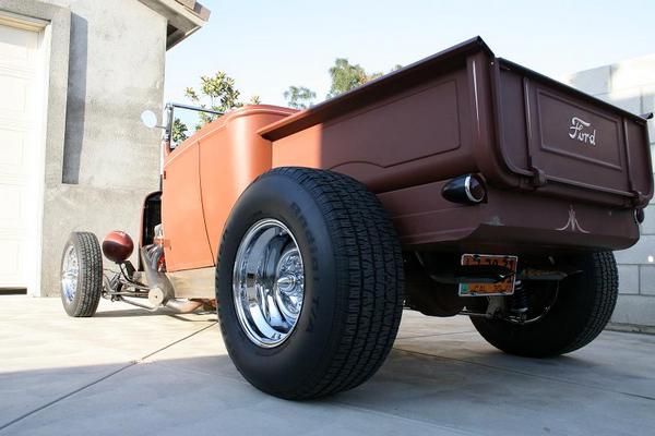

    This is the first rpu I built. It was a brookville. It was expensive to build and I agree you do get what you pay for. My post was to give prospective buyers some insight as I have now built both. I know the amount of work it takes. I bought the last refuge because the picture looked really good and the price was right. I should have found a cheap basket case henry ford body and patched it up. It would have been the same amount of work. I would have purchased the last refuge truck bed. They are nice. My posts were not meant to be a smear job but I do have experience both ways and hope someone can benefit from the expensive & time consuming mistakes I've made.
