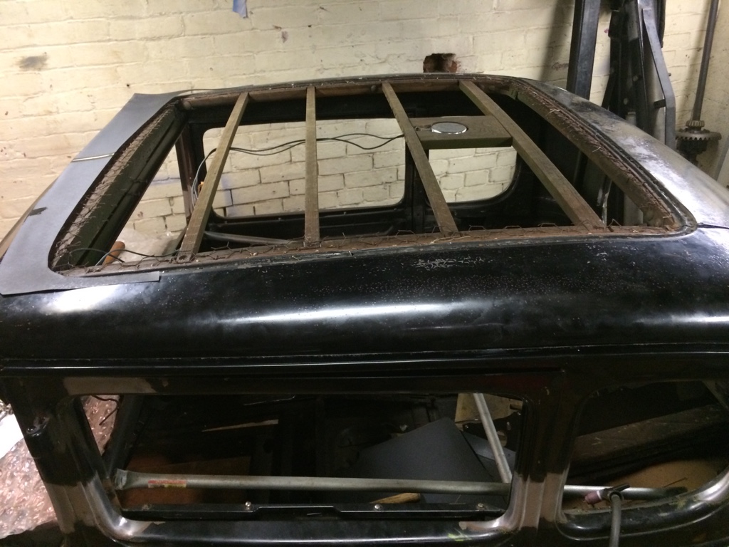

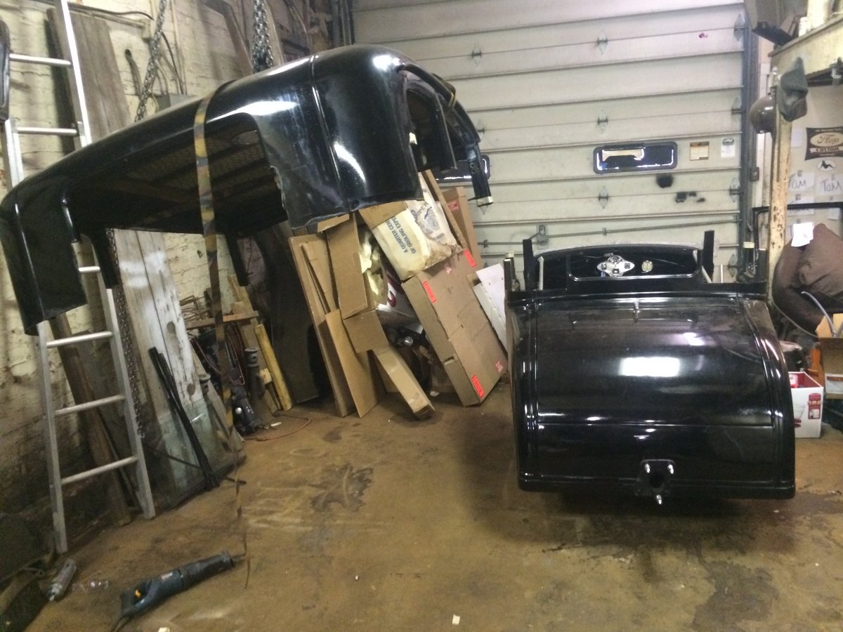

    never had such a hard time getting the doors off a car
    1 man shop problems
    as the ***le says ... mild chop on a beautiful late 31 coupe with no patch panels in the body !

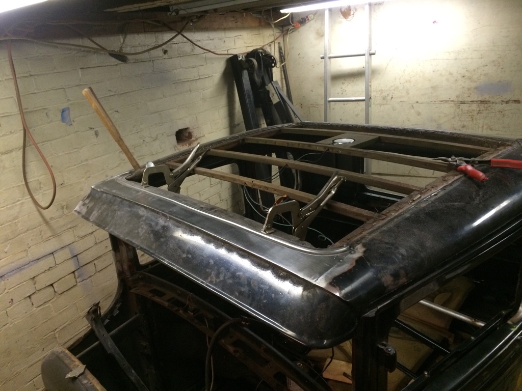

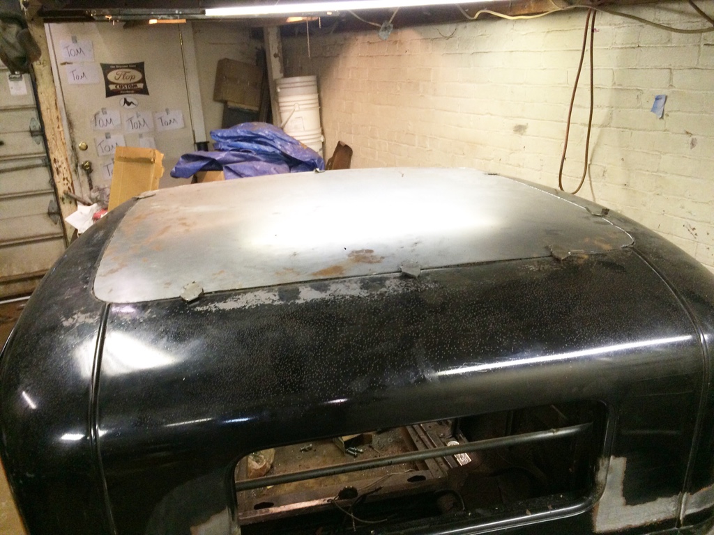

    roof back on

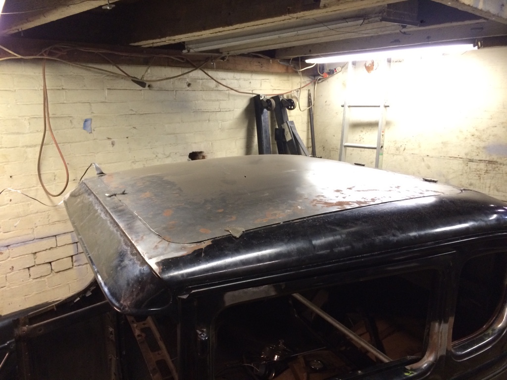

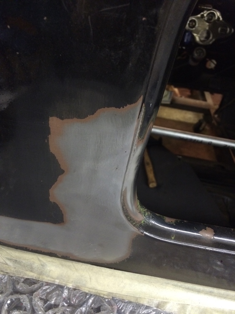

    Made up this piece so it's like a 32 styled insert since the visor was welded on ages ago

  7. EW_
    Joined: Apr 10, 2008
    Posts: 82
    EW_
    from DFW
    Wow, looks like it was made that way!

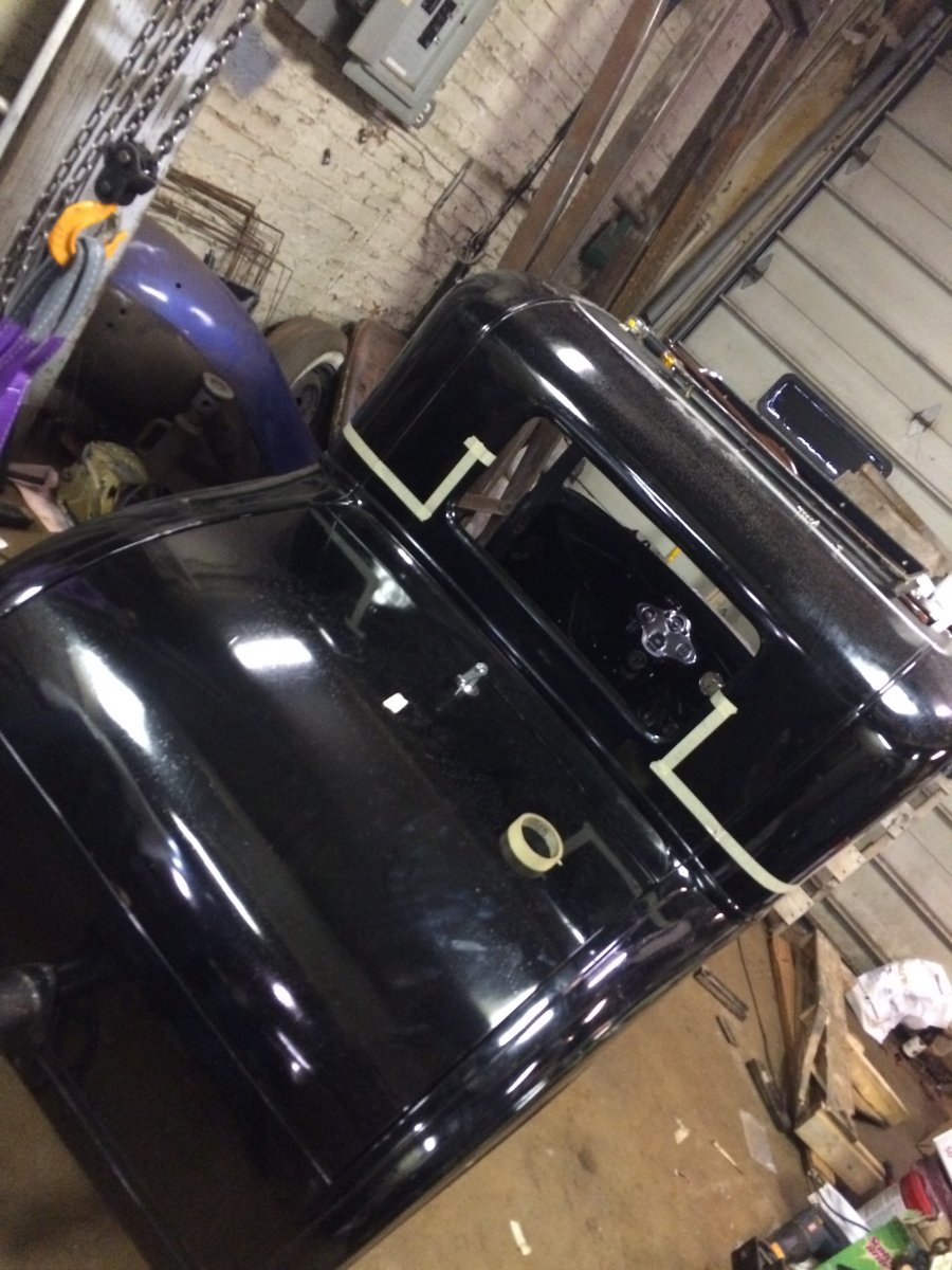

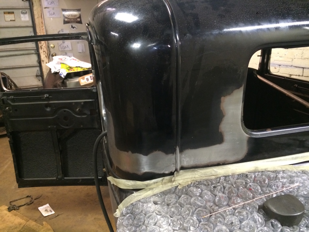

    still some work to go cleaning up the chop a hair and adding fasteners to the walden insert so it will be removable

    Great job, how much did you take off ?? Very tasteful chop.

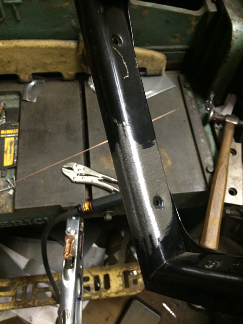

    I just noticed that you weld lumps onto the door to cowl hinge screw "heads / slots", then weld nuts to the lumps...
    very... very good idea... consider it stolen !
