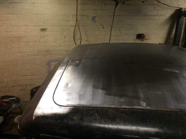

    Great job as always. I'd be interested in the details of making the roof panel removable, or more crucially the attachment method!
    Chris
  23. Never2low
    Joined: Jan 14, 2008
    Posts: 1,181
    Never2low
    That's what I was wondering as well.
    My first thought was simple threaded studs welded underneath, that would slip through holes drilled into the ribs, then nuts and washers.
    It might not look super clean, but should function, depending on headroom.
  24. 31 Coupe
    Joined: Feb 25, 2008
    Posts: 542
    31 Coupe
    We use PEM type clinch studs for this type application in our sheet metal cabinet work.
    Probably not ideal for a painted panel (could crack the paint when tightening them) but they would be excellent for a vinyl covered one.
