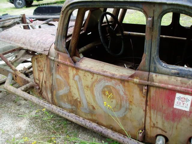

    Been a member here for a little while, but just decided to start posting. I picked up this old modified last fall, and now that other projects are being finished up, I'm itching to get working on it.
    We think the car started racing in the mid 60's and only raced up until '68 or '69, or so we have records for. I'll have to sit down and record some of the other history of the car, and how I got my hands on it, but that's for another night.
    I'm not real firmiliar with antique iron this old, so I was hoping you guys can help me identify some things with it. Here's some pictures of it, and maybe someone knows for sure what the body is (My guess is a '33 Plymouth):
    Different frame maybe? (I think the car used to run a flathead Ford V8)
    Thanks for looking, and any help identifying the body/frame is greatly appreciated!

    Looks like a 33 ford 5 window coupe. A shame if you keep it in the current race form. From the pictures it looks like a great start for a hotrod!!!

    from the looks of the condition of the car it was not raced.. Note no damage to the body. No dents in the rub rails, no frame repair from wrecks. Or maybe it was so fast that it out ran everybody and no one got close enough to hit the car. If you dont want it sell it to me. I have cash in hand and will travel.

    looks like a 1933 or 34 willys 5 window coupe

    Body reveal line tells me it's not a Plymouth or Willys. From what I can see, the 33/34 Ford choice is about right. Given that, it looks like the whole bottom of the body is gone. That would be one tough bring back, but not beyond the capabilities of some people here. It would not be for the faint of heart, however.:(

    Thanks for all of the replies guys! And thanks to Dyce and tubman, looks like it is a '33 Ford, and probably the original frame from what I can tell.
    The car hasn't been rolled or wrecked too much, but I think it was because it was always towards the back of the pack haha. Though the side bars (and roll cage) are all made out of heavy 3" black iron pipe, which would be pretty hard smash in compared to what most of the guys ran.
    The body itself is really just a shell, and would be extremely hard to bring back to use as a regular body. All of the interior panels have been gutted, and it's really only the exterior panels left. Not to mention it's welded shut everywhere, the firewall has cuts everywhere and quite a few big dents throughout.
    I worked on the car today, and almost have the body ready to come off. A couple more bolts, and disconnect things like the steering and such, and it should come right off. The frame looks like it's going to be the worst part... There's quite a bit more rot on the back of the frame.

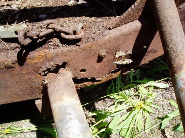

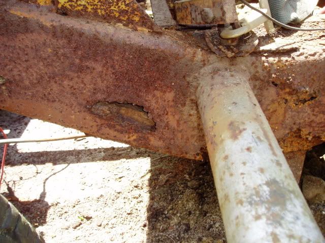

    Well had some free time this morning and made some more progress:
    More frame rot:

    It was a race car perhaps from the 1970s but that frame is so far gone with rust and holes I don't know how you could fix it up back to race track condition. If you could though I would recommend restore back to its racing days. It would look very cool.
