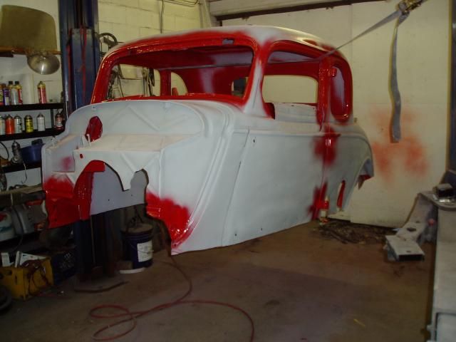

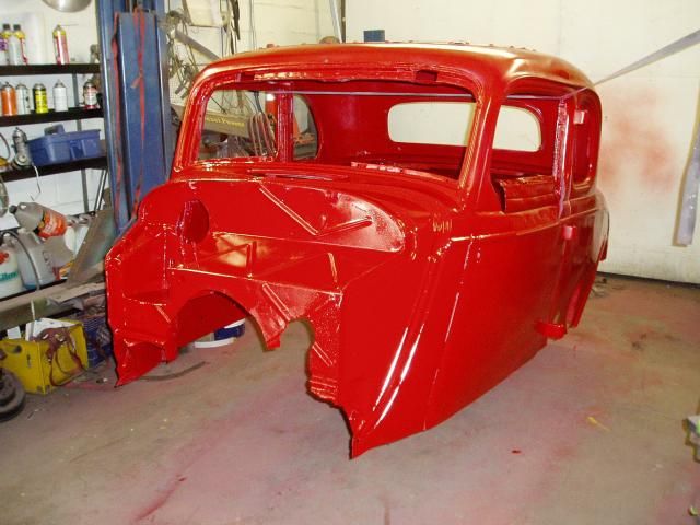

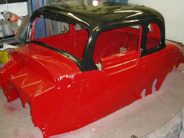

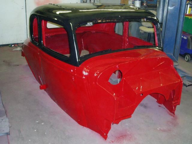

    Anyone notice a change??

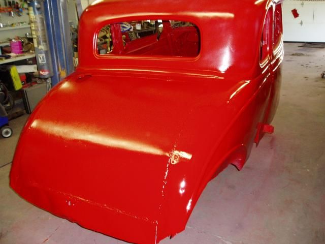

    Been a while since I painted a vehicle (or at least the actualy body that you can see)... Think the last time was when I was 17 and had a borken wrist!
    Came out pretty good actually... Just went with a simple Alkyd Enamel, in Case/IH red (afterall, I wanted to keep with the "built out in the barn" heritage!). Couple runs in it, mostly on the bottom of the drivers door which I wasn't too happy about- but once it's on, has numbers, etc. I don't think it'll be noticeable. The black roof should be done this week some time!

    can't wait to see that thing after ***y
    the red is *****in' cool

    Thanks! The flash makes the red look a little brighter then it is, but I think it'll still stand out pretty good in the sun..

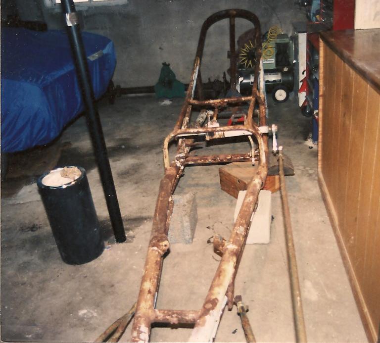

    It was definately nice to finally get some pictures of it from back then!
    I think this photo was from 1971- when the guy in the picture first started driving it.
    He told his daughter that he didn't try too hard to get out in front, because he didn't want to damage his "pride and joy".... It was certainly a sharp car for back in the day!
    You can just barely make out the left water pump of an 8BA from the photo, and can also see that it probably had the tri-power intake on it as well- judging by how far forward the carbs look under the plastic.
    Kind of making me re-think the 283....
    If only I could pick up a 3x2 flathead intake for reasonable, that would seal the deal for sure on keeping the flatty...

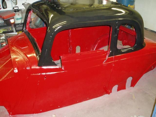

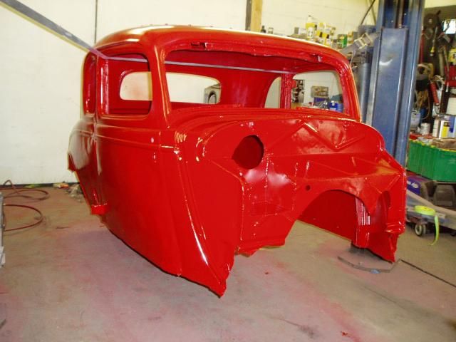

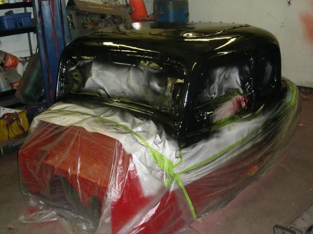

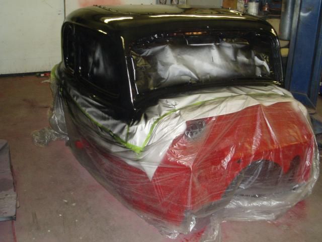

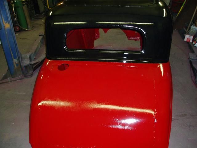

    Really should have waited another day or two to paint the top, but I think we all know how that goes.... Unfortunately there are a few spots where the tape left marks in the paint. Hopefully I might be able to wet sand it, or perhaps use rubbing compound and some wax to help hide it, but oh well- live and learn. I certainly don't think they would have cared that much when they painted it in the first place!

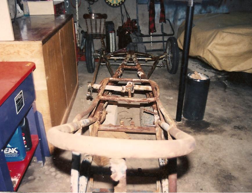

    You're both right! One of the biggest things that has caught my attention is the rear end! I was under the impression that it was changed by the first driver/original builder, but it certainly looks like a stock banjo rear is in there... Can also see the split wishbones from the axle to go directly where the old mounts were on the frame... Guess that answered that question!
    Seeing as how the body had never been removed since it was built (or as best as I can tell- they would have had to cut off and re-weld those side rails) they managed to build that homemade 2 link suspension with the body still on it!

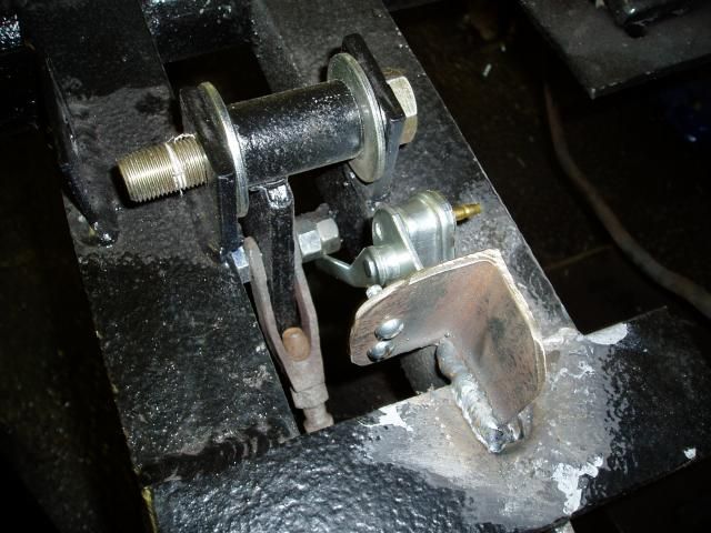

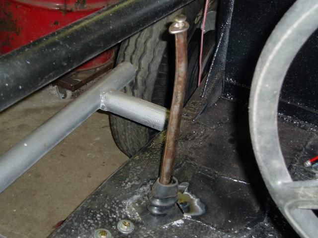

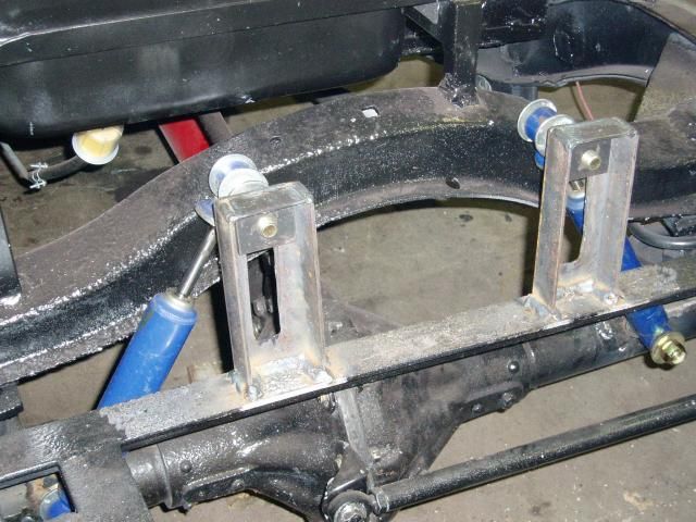

    Just a quick update.... Trying to get almost everything done to the "interior" of the car before I set the body back on... Have to make a shifter, wire the car, and do some finish work/painting, then I should be able to set the body on it for good and move on to the brakes, engine, hood, etc.
    Made a rear-shock set up:
    Parking Brake lever (Need to find something else to use as a boot!):
    Switch for the brake lights:
