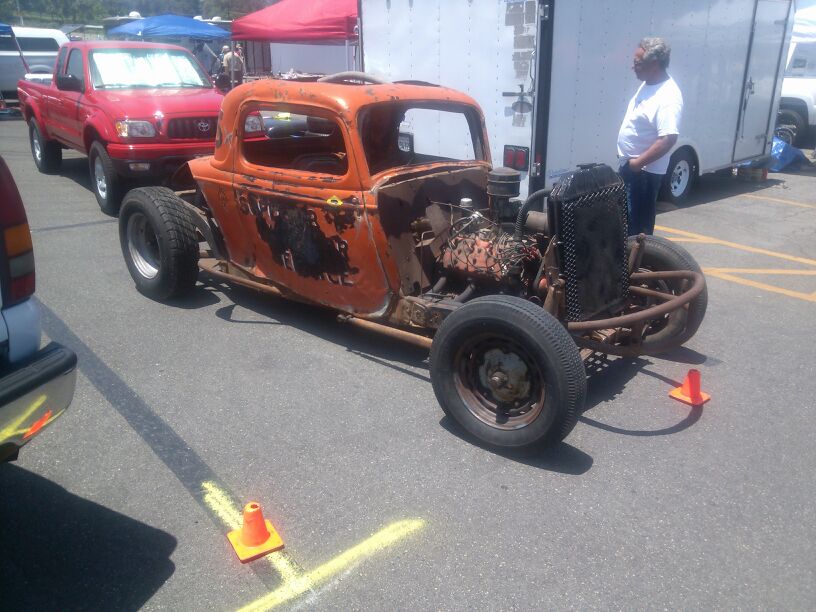

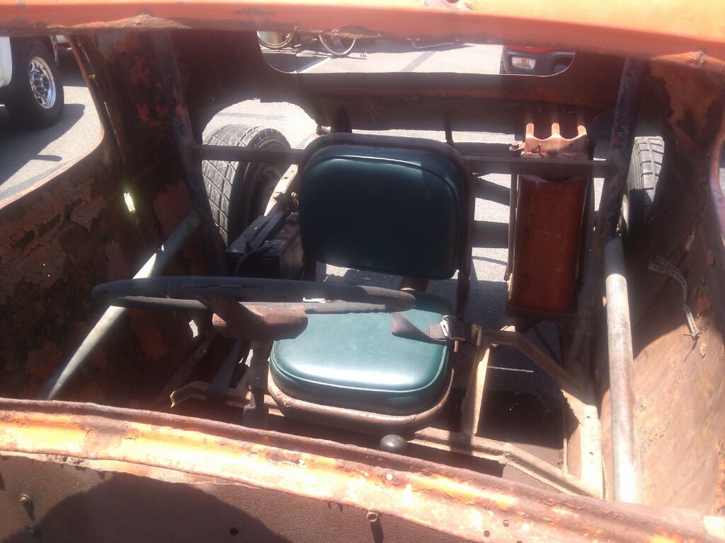

  7. Here's a car that ran during the heyday here in Fresno Bako area of California. This was at LA Roadster show last weekend. Figured you guys subscribed to this thread like me are some of the only guys who get it and appreciate seeing these old racers. The guy who owns the car went through everything mechanically and made it very sound again but retained the field fresh look amazingly well.
    Sent from my DROID device using the TJJ mobile app

    Awesome, thanks for sharing! Real neat looking old jalopy... Really looks great. To be honest I like to look at original/untouched cars then restored ones..
    I wish mind had been in good enough shape to leave it as-is and just go through the mechanicals... But it was a bit beyond that point!
    An old timer once told me "You can restore something as many times as you like... But it's only original once"

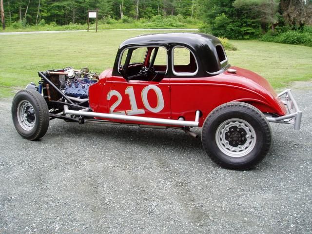

    Go easy on me guys, this was my first time numbering a car:

    And you're worried over the numbering job??!! Damn that's impressive!

    :)Shaun ,That is AWESOME ! I'm glad you did the numbers yourself. You can be proud. .:cool::D
