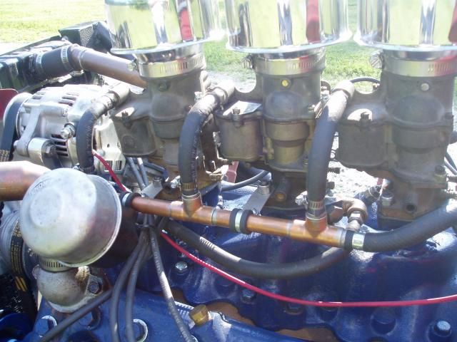

    While waiting for some parts for the trans, I did a side project I've been waiting to do...
    It was tricky getting all the flanges lined up straight and level, and then getting the pipes the right height (it looks sort of off in the picture, but I think it's just from the air cleaners not all the way on). Only have the welding done so far, still have to figure out the linkage and fuel set-up... I got a pair of Holley 94's from a friend that already had the throttle shaft removed so that'll work out nicely.

    More progress! Car is now officially registered, inspected and insured... So now I can drive it wherever! 126 miles so far on it! Still waiting for my real plate to show up though....
    Finished up my fuel system last night- Soldering skills came in handy again.. I soldered the br*** fitting closed on the other two carbs, and then made this out of 1/2" coppers and some 3/8" br*** fittings for "Pex" tubing.

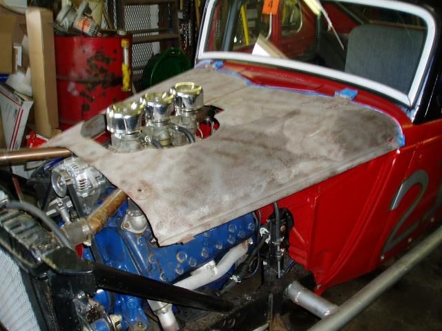

    Hood's going to need some work...

    Tnomoldw
    :)Shaun,I 've been waiting to see the hood in place :cool:,though it does detract from the raw appeal of the car. It's a fine project and great outcome. Thanks for sharing it with us and please continue to do so.:D

    Thanks for the link! I was unaware there was a club for vintage dirt cars.. It is a little far, but if I'm ever out that way I'll have to check it out
    Thanks Bill- it does take away a little from the engine, but I think once the hood it done it will help to "tie" the entire car together a little better

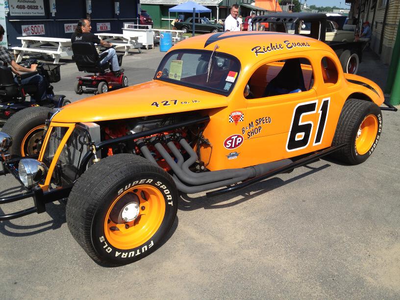

    I was at the Syracuse Nationals yesterday and snapped an inspirational pic for ya...
