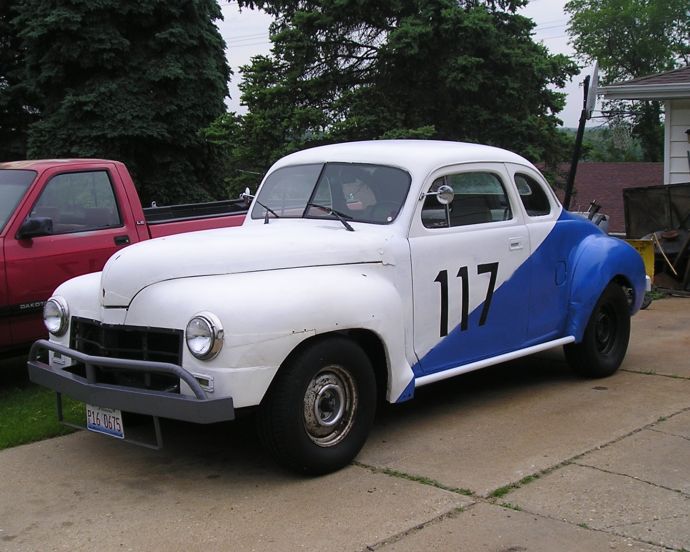

  3. Shaun1162
    Joined: Feb 22, 2010
    Posts: 973
    Shaun1162
    Hahaha, you are definately right there! Always some little project to be working on.. I managed to get the old seal out last night, and it looks like the seal is readily available... Not sure when I'll get mine from NAPA though.
    That's a nice looking car you've got too! Even if it isn't a "true" race car, it's pretty cool in my book..
    Hopefully the pictures are still coming through- Guess I reached my Photobucket bandwidth limit.. Oh well..
    But thanks for re-posting the picture! Actually only the second plate registered in my name... And the other is a trailer, so that doesn't really count..

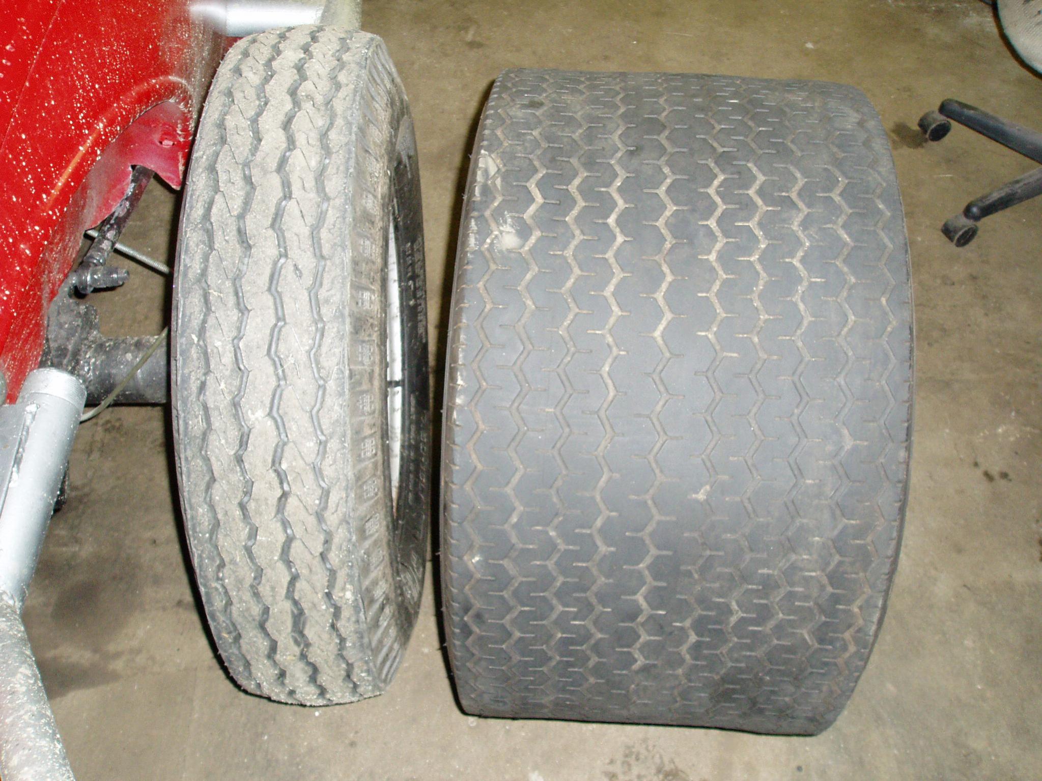

    By the way.. Anyone like my tires? Think they'll be wide enough?
    Hope the flatty will turn them :rolleyes:

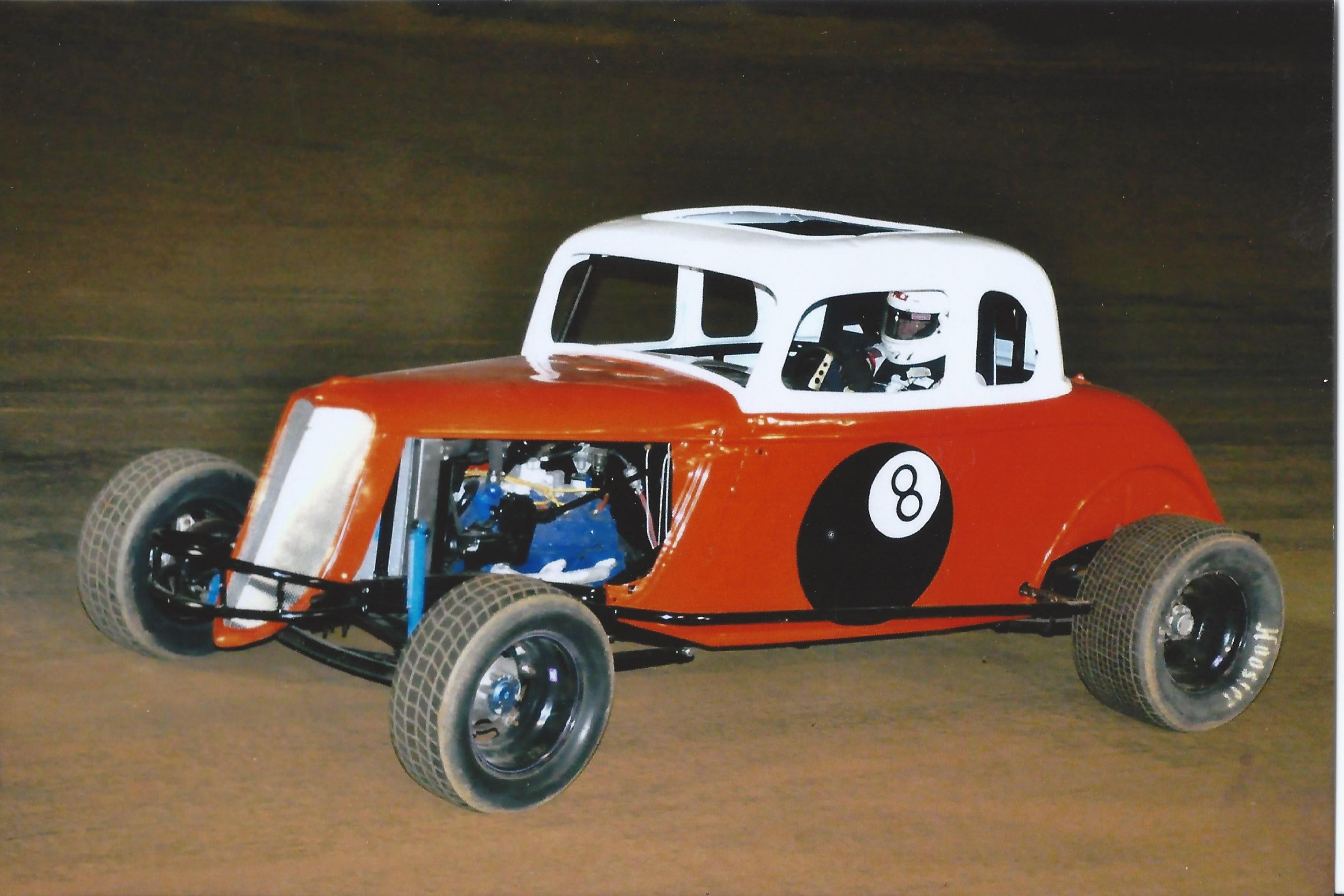

    Shaun,
    This is my last dirt car to restore. I have been racing it but have decided to make it street legal.
    Andy

    Wow, sharp looking coupe! Looks like our cars have alot in common!
    Would love to know more about yours, or see some more pictures of it...
    Planning on running wide tires in the back?

    I am going to run wide tires in back, just got to find some that are DOT legal. The only things added to what you see will be lights and windshield. By the way, if you want to put wide five hubs and drums on the rear end you have, I have 2 original cast iron hubs that will fit. All they would cost you is the shipping. I will stop this before it becomes a book. Good luck to you with your project.

    Hi Andy, sounds like a good plan... I can say for certain that you'll get quite a few comments and looks with it- most people I drive by are waving, giving the thumbs up, or just staring at it!
    Mickey Thompson and Hoosier both make DOT approved tires that have treads real similar to dirt tires and come in several sizes.. Pricey though, that's for sure. Not sure if I'll run the wide tires on my car or not...

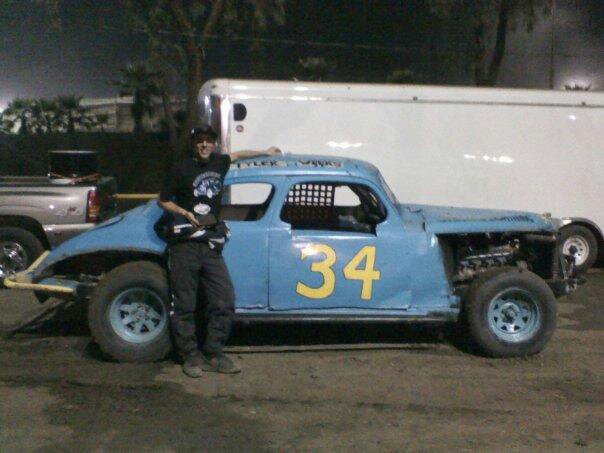

  25. Here's some pictures over the years of cars I have run and won in. An ol' buddy owns most of them.
    Sent from my DROID device using the TJJ mobile app
