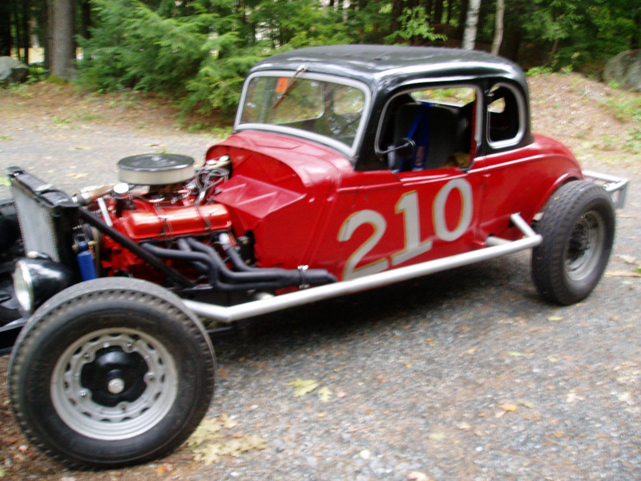

    Nothing too impressive to show off on the old stock car... Lots of little projects going on for 283, but still haven't got it running and driving yet!
    But I've changed the intake to an older style 2BBL, got my adapter, and have mounted the Holley 500 on... Got all the linkages hooked up and all seems good there. Also cut up an old set of SBC headers I got from a junkyard and made up my own using the flange and various cut-up peices:
    The main things left to do are:
    - Reroute fuel line
    - Fabricate some alternator mounts
    - Make my radiator hoses
    - Convert distributor to Pertronix (ya, not needed... But I like Pertronix)
    And some other smaller things... Hopefully have it back on the road within a couple weeks!

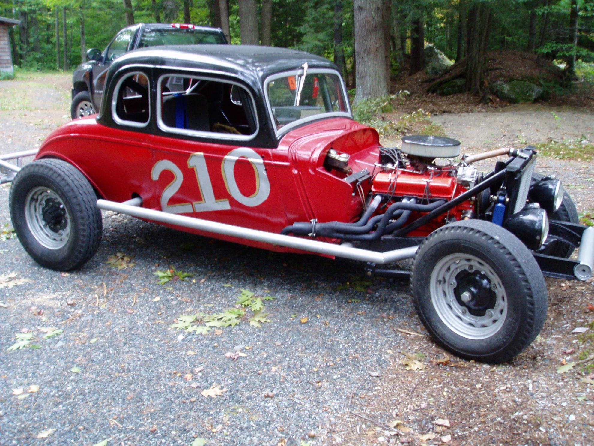

    It's alive (again)!
    Not quite as pretty as the flatty with trips, but I seem to forget all about that when driving it! That 283 sure scoots the car along great- now I understand why guys were yanking their flatheads for SBC's as soon as they came out!
    Open headers really wasn't an option on the road (although I did have to do one short test drive for the heck of it!), so I bought these short 3" sections from Summit. I took a section of 1 and 3/4" exhaust tubing, marked out holes all around it, then took an air chisel with a pointed bit to it. Then I drilled out the little "divets" made by the air chisel and welded them into the 3" sections.... These homemade baffles actually work pretty well! I think it's even quieter then my flathead was- and that had stock manifolds, mufflers, and exited alot further back!
    Also had to make my own bracket to run my mini alternator... Works pretty good.
