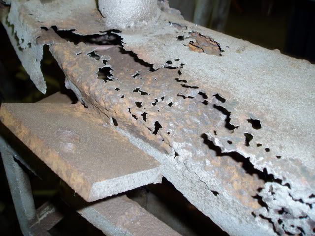

    So quite a bit of progress in the past couple days.... Got all 4 brake drums turned down and painted, got a set of axles for the rearend, might have tracked down a transmission.... Oh and I got the frame back!
    Kind of looks dumb like this, but it's the best way to weld on the frame rails and such..
    Some of the damage....
    Started welding some patches...
    (Welds look kind of ****py but it was hard not to burn through everywhere, no matter the heat)
    I know the patches (and some of the welds) aren't the greatest, but I haven't had much practice lately... And it is after all an almost 80 year old frame, turned into a race car close to 50 years ago, and has been sitting out in the woods for at least the past 30 or so years, so I'm not too worried about having a show car quality frame!
    Thanks for lookin!

    Today's progress.... Still need to do (alot) of grinding:
    Used a plasma cutter for the first real time to cut out the rotten section (outer frame rail first)..
    Then I cut out the inner frame rail section (doesn't look as bad, but it was paper thing and pitted awful)
    Just kinda went around and tacked in the inner frame rail section, when I flip the frame over I'll be able to weld around it better plus I didn't want the outer frame rail patch to hit on the welds
    And then the outer section... I heated up the bottom section and hammered it down to give it a more factory curve to it

    Originally they only welded one side of the gussets for the cage, which is certainly strong enough but I decided what the heck, might as well finish the other side..
    Swiss cheese anyone?
