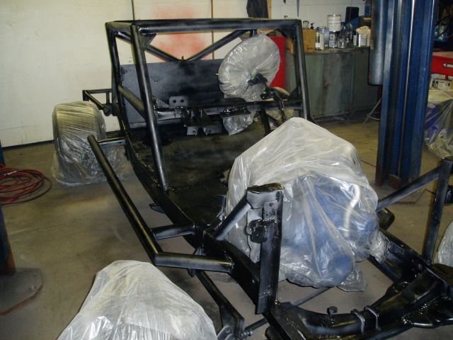

    Just to show that I haven't been slackin off too much...
    This is Monday afternoon:
    And this is tonight....

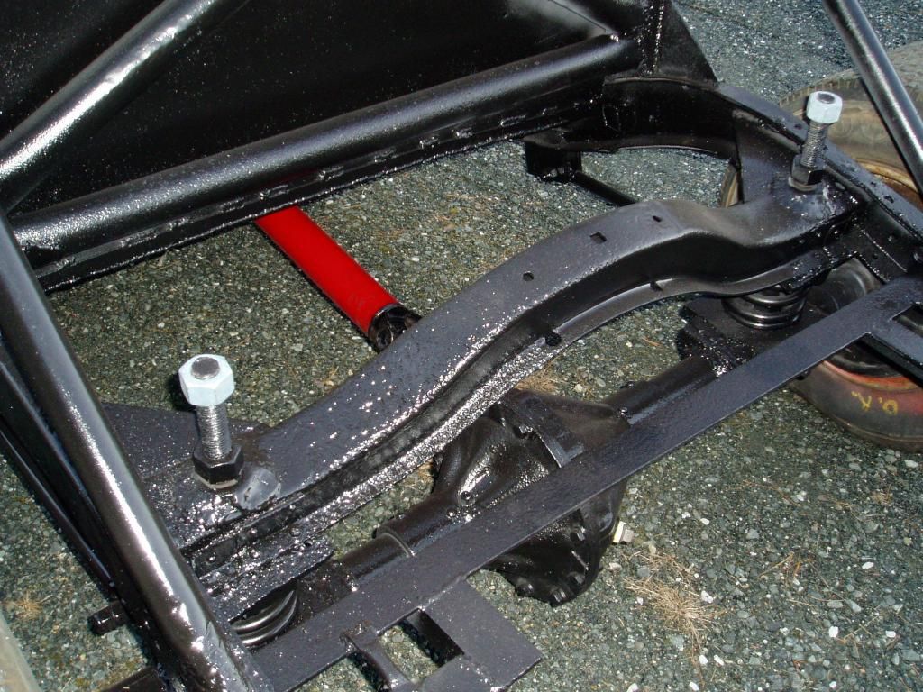

    Been quite a week of progress (especially since I only got to work on it 3 nights) but its alot more motivating to see it back on its feet again
    Ran into a few issues lately that I've been tackling... Bought a 4.10 ring and pinion for it, but of course the part number didn't actually go to this model and ended up with one for a Dana 60 instead. Looking it over and talking with a couple knowledgable guys it COULD have been made to fit... But it would have required alot of machine work ($$$) to make it fit. Then I went to a couple junkyard looking for rears, mostly at Dana 60's, and found one, but then talked it over again with some people and decided just to put the rearend that I have back together again and run it... Can always change it in the future.
    The rear suspension is real funky... Homemade 2 link set-up, which was sort of ahead of its time back then, but they never really went all the way with it.. Here's some pictures to kind of show it:
    When I put it in the car, the rear automatically wanted to twist and the pinion was facing way up and the tires were hitting the side bars. I knew the suspension was going to need some help but the ratchet strap is holding it in a decent position and it should be easy to take out a little more metal to get the pinion level and then weld a plate or a couple thick washers to the top of the crossmember to keep it there. Then I'll be building some radius rods out of aluminum like out of a newer stock car. Not really the most authentic, but hey I have it available and once it's painted black I doubt most will know the difference...
    Also one the rearend when I decided to put it back together, I didn't really want to deal with the welded spiders on the road (especially with how big the tires are going to be on the back) so I started messing with it and found only one actualy weld was still holding it (the rest had broke) so I used a plasma cutter to cut the weld, took the spider gears apart, and then carefully took a die grinder and got rid of the welds. Not exactly the most popular/correct way to do it, but hey this ain't Nascar.

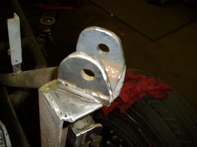

    Also had to deal with the drag link... Originally they just used the stock drag link and cobbed it into the Chevy steering box with only a few threads on the end holding it and of course they were pretty stripped... Hadn't paid any attention to it when I took it apart so that was sort of a speed bump when I went to put it back together. So then my Uncle talked me into just making my own out of the aluminum I had for the radius rods. Never really worked with this stuff before, but it was pretty easy. Might have to do some adjusting with it, but the steering actually seems to go pretty good turning the wheel.
    Also managed to find a transmission a couple weeks back. Been looking all over for one asking all the guys I know, and then I just happened to talk to a guy at a local cruise night and he said he had one. So he brought it with him the next week to the cruise night and I picked it up there so that worked out alright.
    Hopefully soon (meaning tomorrow) I can get the engine/transmission in there for mockup.

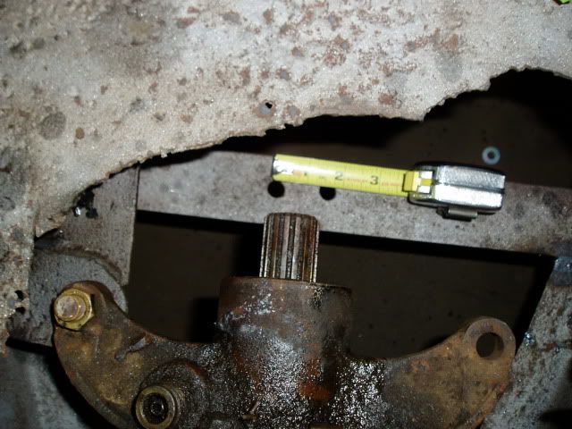

    There was also a fitment issue on the driver side by the steering box...
    Looked like quite a tight fit for even a stock manifold let alone headers
    But then I remembered that with the rubber mounts it'll probably sit up another 1" or so which would help.
    So I took out the motor mounts that were in it thinking I'd have to make some new ones, but then I held them against the frame and moved them forward about and inch to line up with the water pump holes and it looked like they'd fit. So I got out the welder and welded them to the frame but not permanent so I could rework them if I had to. I was able to get the rubber mounts in after that so it looks like those motor mounts will end up working in that position
    (Had to go out and get a new engine crane of course :rolleyes:)
    Hard to tell from the picture but I gained quite a bit of clearance by the steering box. The dipstick tube still hit the box but just barely so I'm sure something could be done about that.

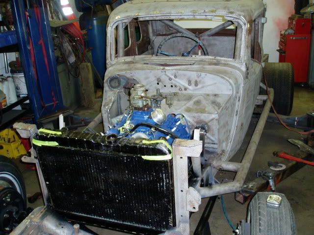

    Looks like the radiator might be a tight fit......

    "For the panhard bar do you mean the bolt coming off of one of the plates? I didn't cut it off of the plate, I just painted over it so it might look like it's gone. There wasn't any panhard bar or even a place where one might hook, so I'm really not sure what their plan was their unless it was a work in progress they never got to. The coil springs are definately becoming an issue. It wouldn't be so bad except I have few good places to measure the distance from, they weren't really too concered about it being perfectly square at the time."
    You will have to make it square. I don't know a a car builder who would have built the car square. Its supposed to be shorter wheelbase on the left or at least have a right side lead.... it went in circles..... they did everything they could to make it turn left effortlessly.
    The coil spring rear end is an awesome ride once you figure it out. The rear end of an early eightys G-Body or "Metric" car will give you all the inspriation you need.

    A panhard won't be necessary for the street... Making it a four link like a G-body will give the car a great ride and keep the rear end stable. If you put it on the track you will need to add a j bar and a panhard......

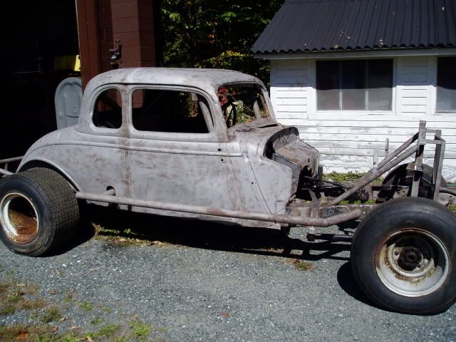

    Had to pull the car out today....
    In order to unload this from the trailer using the lift and then set it on the car after pushing it back in..
    My favorite view (although the photo doesn't really look as good)..
    The hood will need a little "m***aging"
    Aside from the old battery box on the firewall, that is the ONLY rust on the body.... Not bad for almost what 80 years? And I know it spent the last 20-40 of those years in the woods....

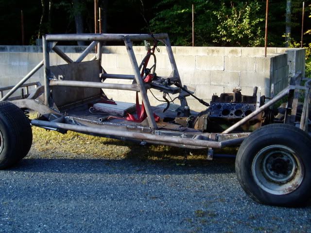

    Rolled it outside the other day and got a couple better pictures of it... Flathead's giving me some trouble now, so not sure what to do about that yet...

    My radiator turned into quite a project after the motor was in... I found an old Chevy radiator in a barn, took it to a radiator shop, but when the guy tested it the core was cracked along the middle. Fortunately the guy has an extra one just the same size, so he added the 2 water necks for the flattie and put on the side brackets that were on my radiator for $80. But one my motor was in, I found alot of fitment issues with the fan and hoses. So after some flipping the side brackets around, notching the frame a hair more then they originally did back in the day, and then making a bunch of brackets off of the the other brackets, I've finally got a radiator that fits perfect (now I just hope it'll cool well enough!).
    Can't really tell much from these pictures, but this is how the radiator now sits, where most of the radiator is between the two side bars, where before most of the radiator was behind these two side bars, too close to the fan.

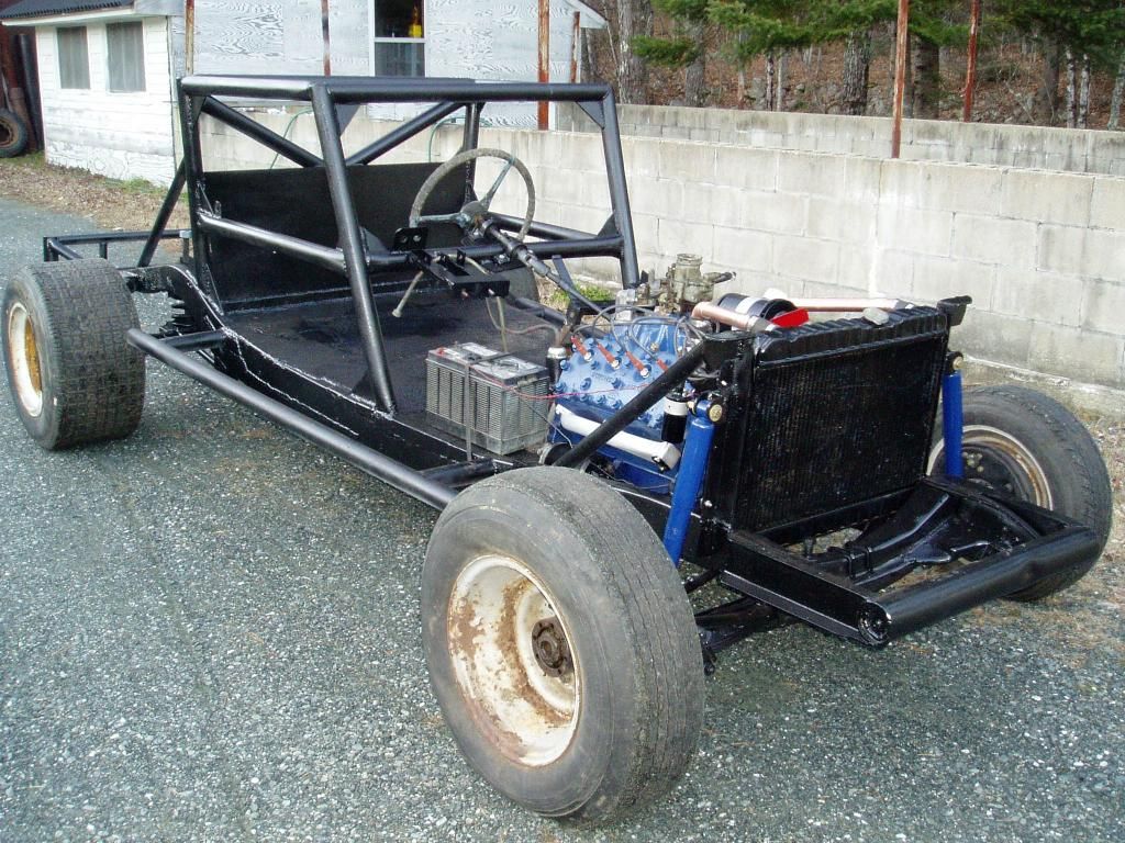

    Haven't had much for updates lately, so I thought today would be a pretty good day to show...
    I'd say it's a milestone for the restoration... For the first time in probably 40 years, the car moved under it's own power.
    Kinda hard to believe it was just a rotted out frame witha body sitting on it 5 months ago....
    Not a very good picture, but here's how the rear suspension kind of ended up:
    Just a real temporary hookup for now... Extra battery for the coil, jumper pack for the starter, and an old oil bottle for the gas can, but at least I don't have to push it anymore!
