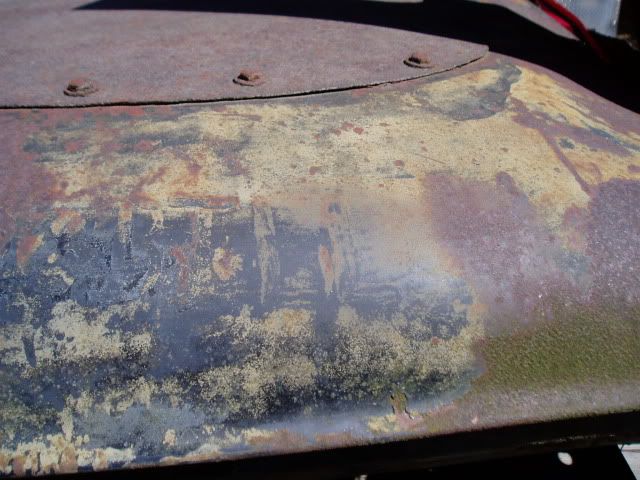

    This photo kind of shows where the red looks "splashed" on:
    The hood looks different in the pictures, but who knows that could have changed at any time... Also the black top on my car could have been added later too.
    Also never really noticed it, but the top did have some yellow to it.... Wether it's paint, or just some sort of mold etc from sitting I'm not sure.
    But then again under these numbers it looks red..... So I don't really know what to think!

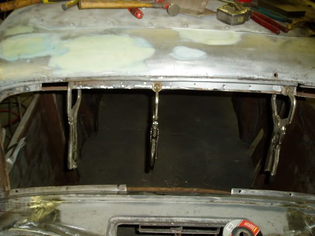

    I managed to pick up a pretty decent windshield frame off of Craigslist, only two towns over for $100. I think I did pretty good on it. The only real bad place was on one of the bottom edges by where the bracket slides in. Had to drill out the screws (of course) to get it apart, but amazingly I didn't break the gl*** taking it apart (its already cracked, but at least I didn't have to pick up off the floor if it had shattered!) and now I've got a good template to have another made.
    I'm sure someone's done it before, so is there any good way to mount the windshield solid to the car? I don't have any of the hinges/brackets, so I was planning on making some brackets to make it stationary, but not glued in place like newer ones. I think it's safe to say this car will have plenty of ventilation without a hinged windsheild
    Also had a chance to tackle some of the bodywork I've been putting off... The cowl vent area had seen better days... Must have had pine needles sitting in there or something for quite a while...
    I managed to cut too much off of the donor panel so I screwed up the gap on the front, but I think it turned out alright. My first real time tying to patch in a donor piece in the middle of a panel like that.
    Got some more grinding to do, but all in all I'd say it looks pretty good.

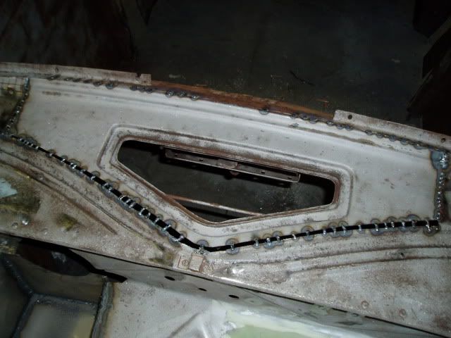

    So after getting the cowl vent patched in, one of the "big" rusty area to deal with was in the upper windshield lip. At first I tried to weld up some fo the pin holes, but it became apparent pretty quite that it needed to be cut out and replaced......
    The bottom overlap of the lip originally had rivets and a few spot welds to hold it in place. Course that type of rivet reall wasn't an option for me, so I decided to drill some holes every couple inches and then plug weld it. I think it turned out pretty good... Still got some welding to do and start grinding, but this was all I could get to this afternoon.
