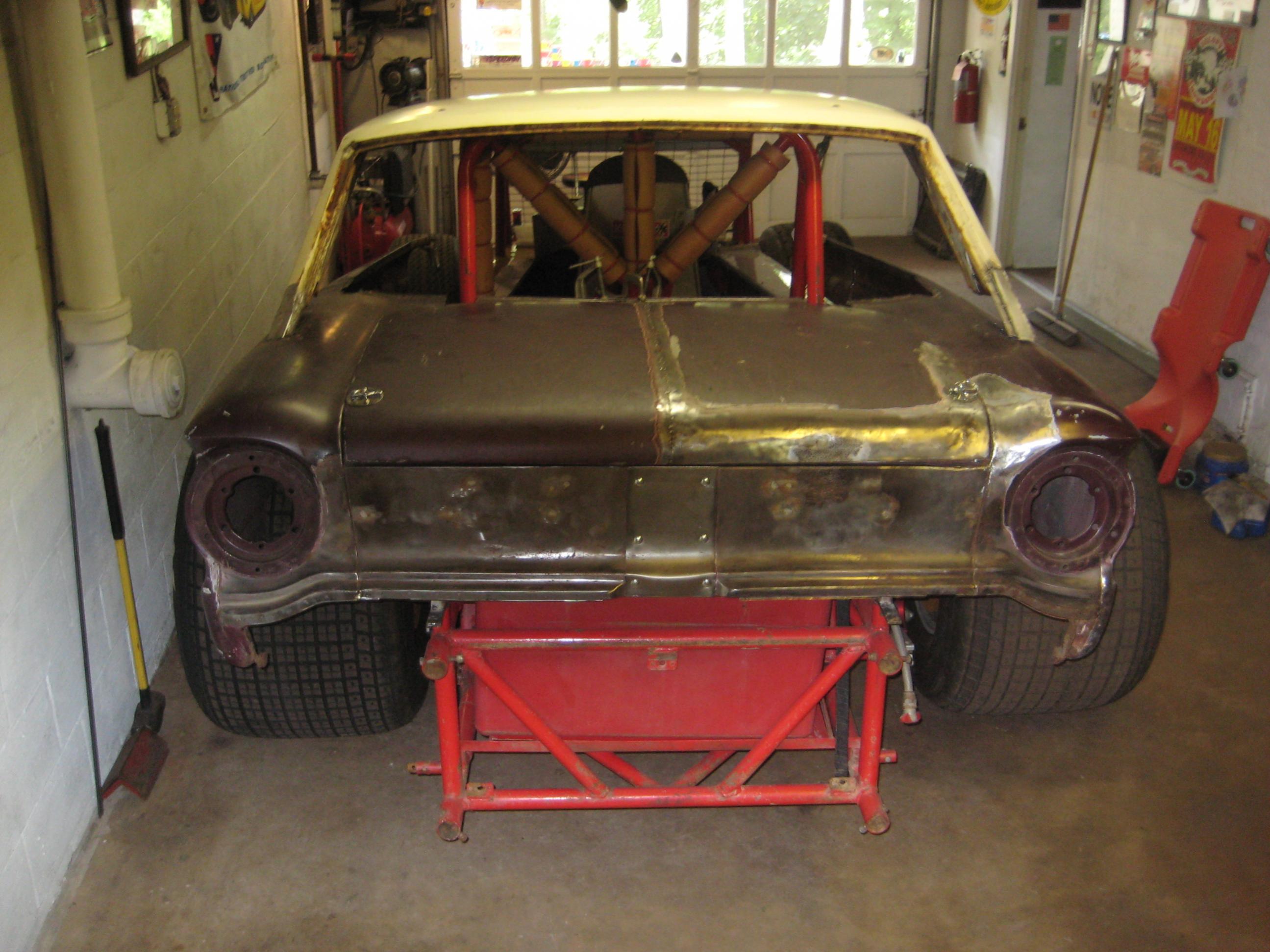

    Shaun, sorry I didn't get back to you I lost track of this thread. Here's some pics of my 62 Falcon. I run with the Blast From The Past Vintage club out of Reading , Pa. We run at Grandview Speedway Bechtelsville, PA. My car won back in July and finished 10th. for the season. This was my first time at driving as I wrenched on this car back in 73 when it won the Grandview Championship. The car still handles and holds it on with a 450 h.p. 350 sbc. Most of the cars i run against have 500 to 575 h.p. You will really enjoy driving , i do and at 72 it gets hard to drive when it's 95- i00 degrees at the track. Shaun , your doing one heck of a job on your car can't wait to see it finished. I'm been to Claremont, Monadock and Rutland tracks, but not as a driver. What part of N.H. are you from, i still get up there once in a while. Keep up keepin up, Hank

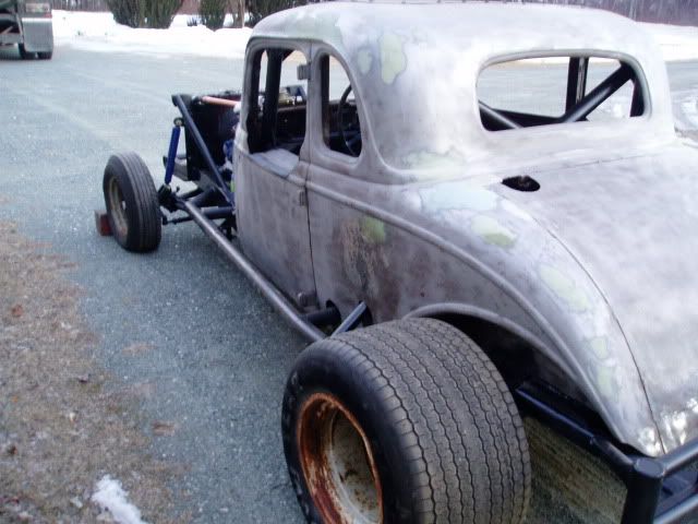

    NOW it's starting to look like something.....
    This was my first time driving it with the body on it, that was definately a good feeling!
    Been needing some encouragement lately, and I think this will help. I've got alot of the body work done, but it just seemed to be dragging on and on so I needed a change for a little while.
    Didn't have time to take pictures of it today, but I put a set of 6.50 x 16 tires I got for $40 on a pair of stock wide 5's on the back (only had $20 in those). At first it just didn't have the "cool" factor that those wide racing tires did, but I think it's growing on me now.

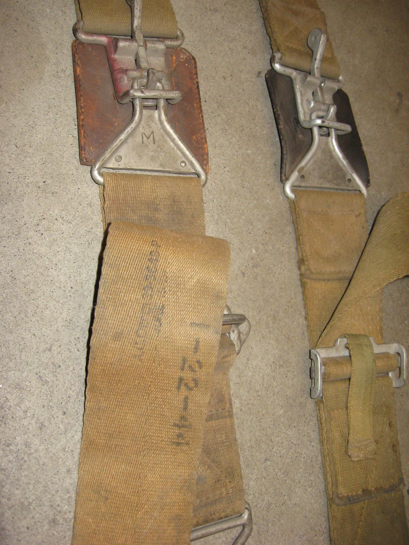

    Well, unless you happen to have an old airplane seatbelt

    Shaun,you wouldn't mean one like these, would you? We will work something out!
  22. Shaun1162
    Joined: Feb 22, 2010
    Posts: 973
    Shaun1162
    That's EXACTLY what I mean! Aside from the color, it's identical to what came out of my car.... Any idea what ya gotta have for em? :cool:

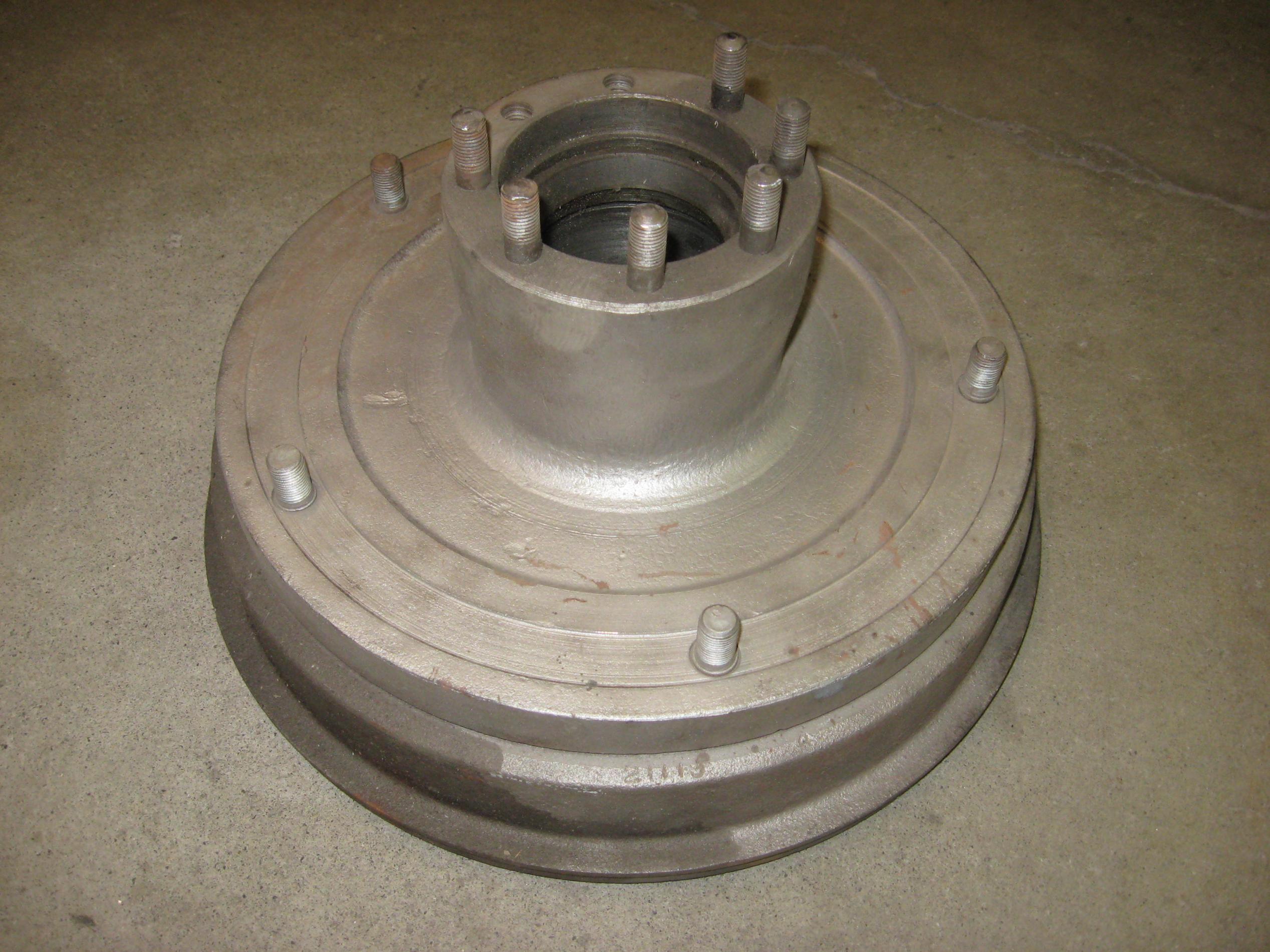

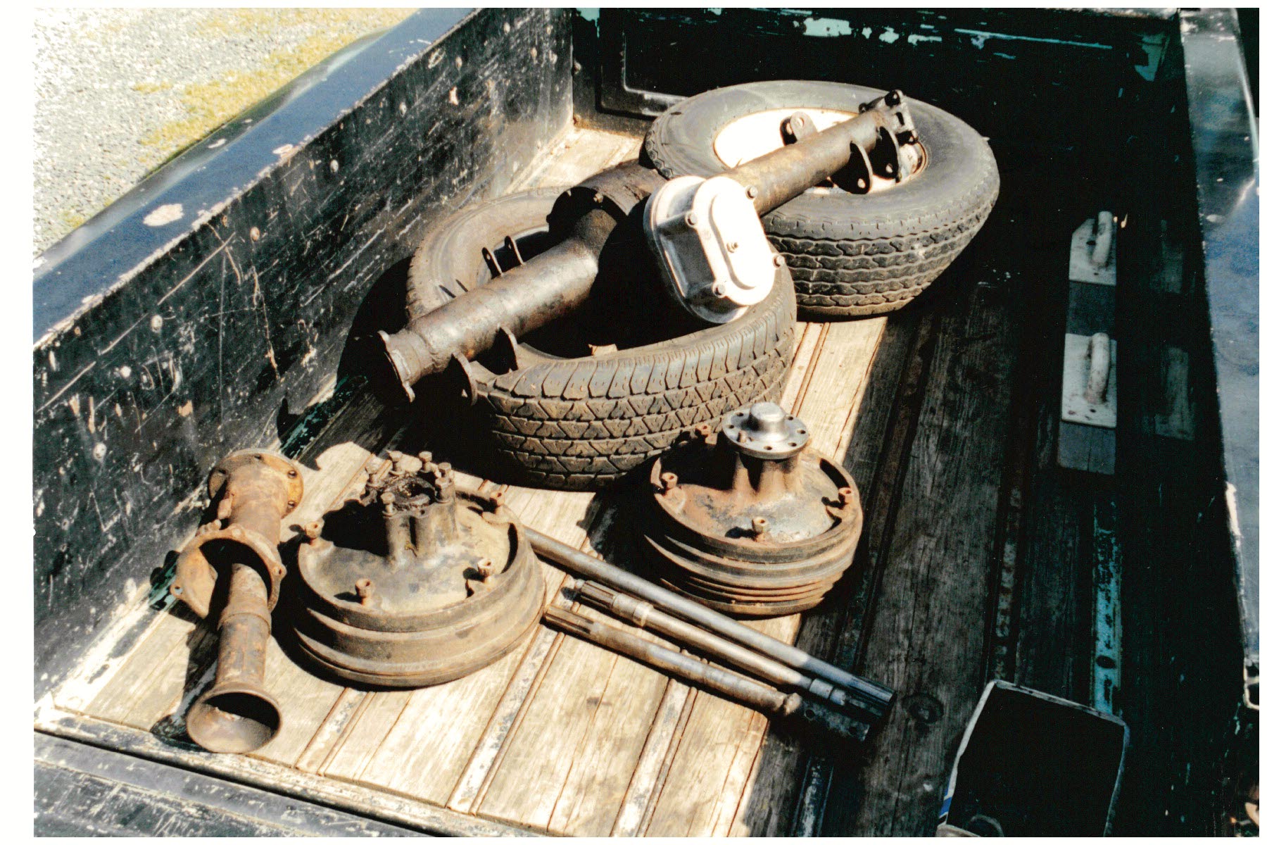

    Shaun, how would you like to have a wide 5 floater hub in the right front?

    Awwwww Marty, that there is pure sweetness!!!!! Is that OEM cast iron? It doesn't look like mine.
    Just awesome. :)
  25. Marty Strode
    Joined: Apr 28, 2011
    Posts: 9,707
    Marty Strode
    It is cast iron, and it is an odd one. Yours probably look like the ones in the pic, and the same on one of my track roadsters (my old friend Len Sutton) at the wheel. Shaun, maybe we can make contact this weekend.
