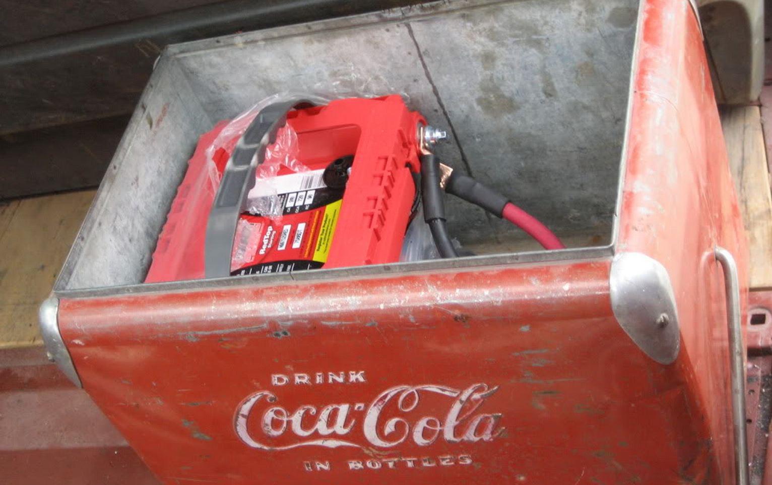

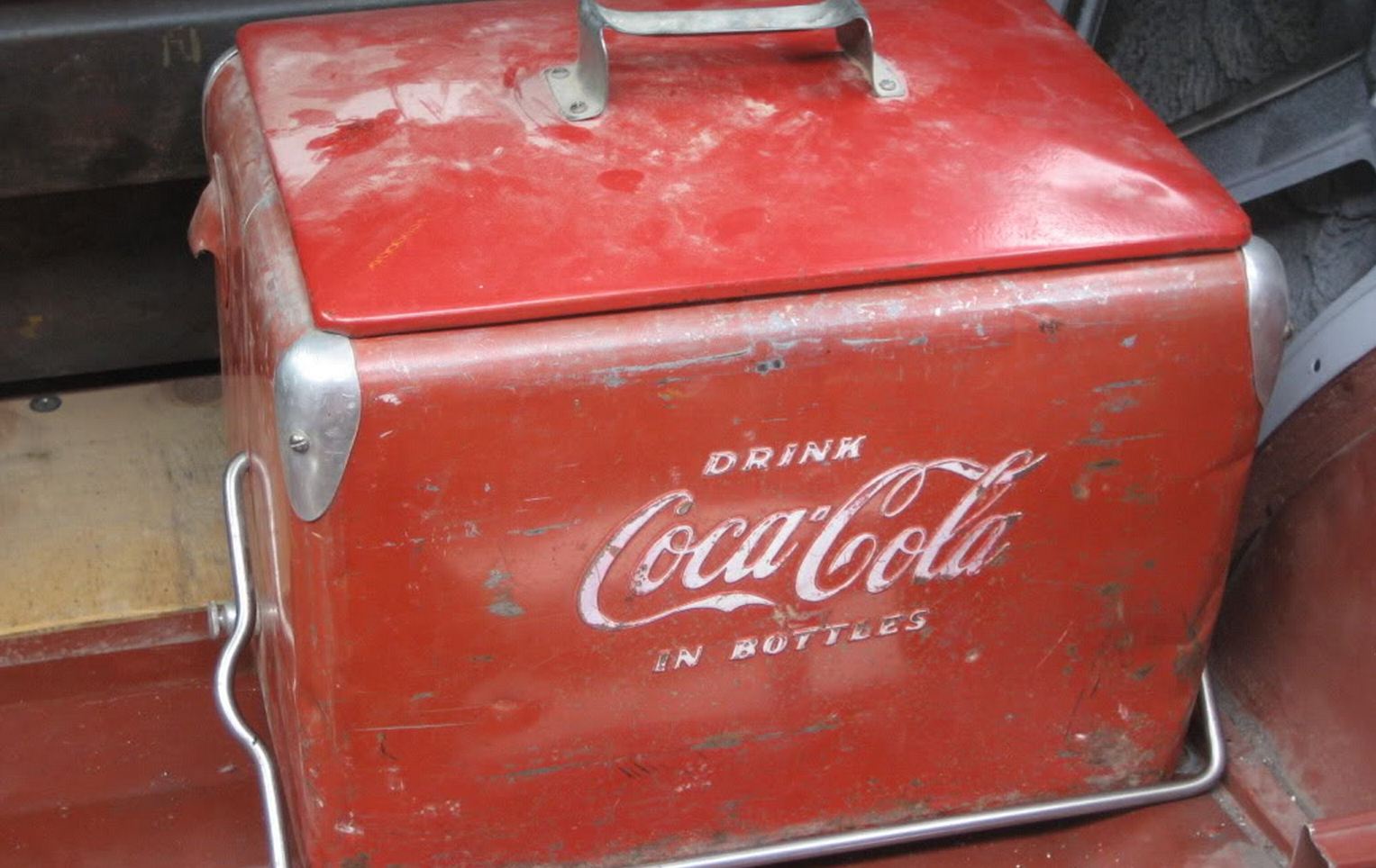

  12. Tnomoldw
    Joined: Dec 5, 2012
    Posts: 1,563
    Tnomoldw
    Looks real good, Shaun :) I saw this battery box ,got to thinking, you could use a Bread Box , a Tupperware container, Ice chest.picnic basket , what ever .... Nascar cars have the battery tucked behind the right front wheel so it s actually slipped inside on the right side floor be really close to the starter. Something else you prolly should add a relay in your lights hook system, to be gentle on switches. Bill aka Tnomoldw:cool:

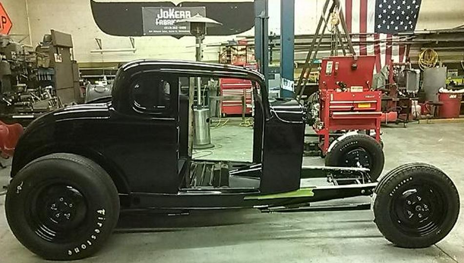

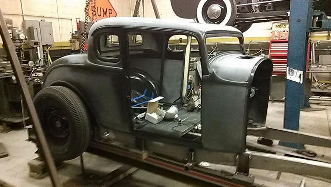

  24. Tnomoldw
    Joined: Dec 5, 2012
    Posts: 1,563
    Tnomoldw
    The three pictures above with the Firestone tires is named The Chemical City Coupe.It will be a the Detroit Autorama show .It was built in the Joe Kerr shop.It has full sprint car style torsion suspension.The olive car is an Ohio car as is The Chemical City Coupe. I'm guessing it will be at the Detroit Show also.note the big rear tires. Reminisent of a drylake racers, it looks cool and it would help your gear ratio. :D Bill aka Tnomoldw You can be proud of your car's heritage it was a real track racer. Do you have a tach yet ???? I saw an outrageously cool tach installation on a dutch guys truck, tack was mounted on the hood on a small flip over panel operated by a choke cable. :eek:
