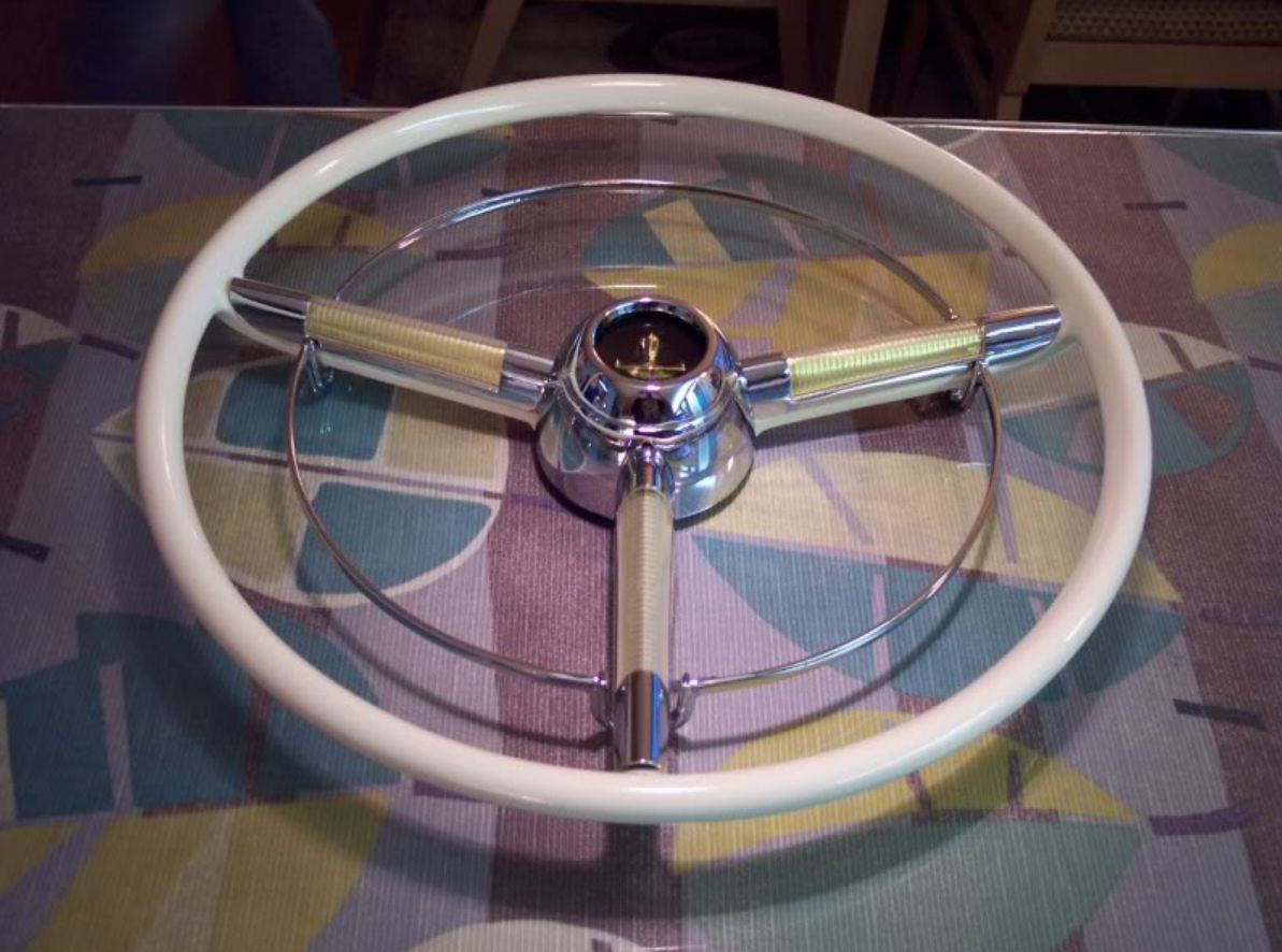

    http://www.bing.com/videos/search?q...3885C8819C770526B4FC38&view=detail&FORM=VIRE5 Steering wheel rebuild videos It's a 2 part rebuild part 1 refinish part 2 , looks simple enough , using epoxy putty. I heard tell of a boat builders trick of wrapping the wheel with nylon cord,I'm going to look for info on that. The old racers used friction tape.Story is have to wrap it the right direction for left-handed circle racing. If it's done wrong it will get you hands bleeding,or blisters at the least. Bill aka Tnomoldw picture below is a rebuilt and painted wheel. I am ***uming using epoxy paint. :cool:

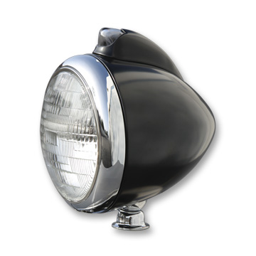

    :)Hi! Shaun, my travels today I found some pics resembling your car. I also did some art projecting your attempt at making the car street/road legal. Like keep it simple. I think with a bit of simple planning you make a nice headlite setup not using high-dollar hotrod headlites, and have a super look.A trip to the local junk yard you could find some headlight buckets , say 1958 Chevy or Ford quad headlites . Parking lites and turn signal should be simple enough. I also thought a trip to an old motorcycle shop may be a good place to check for old headlit buckets. Just need to think outside the box .;)

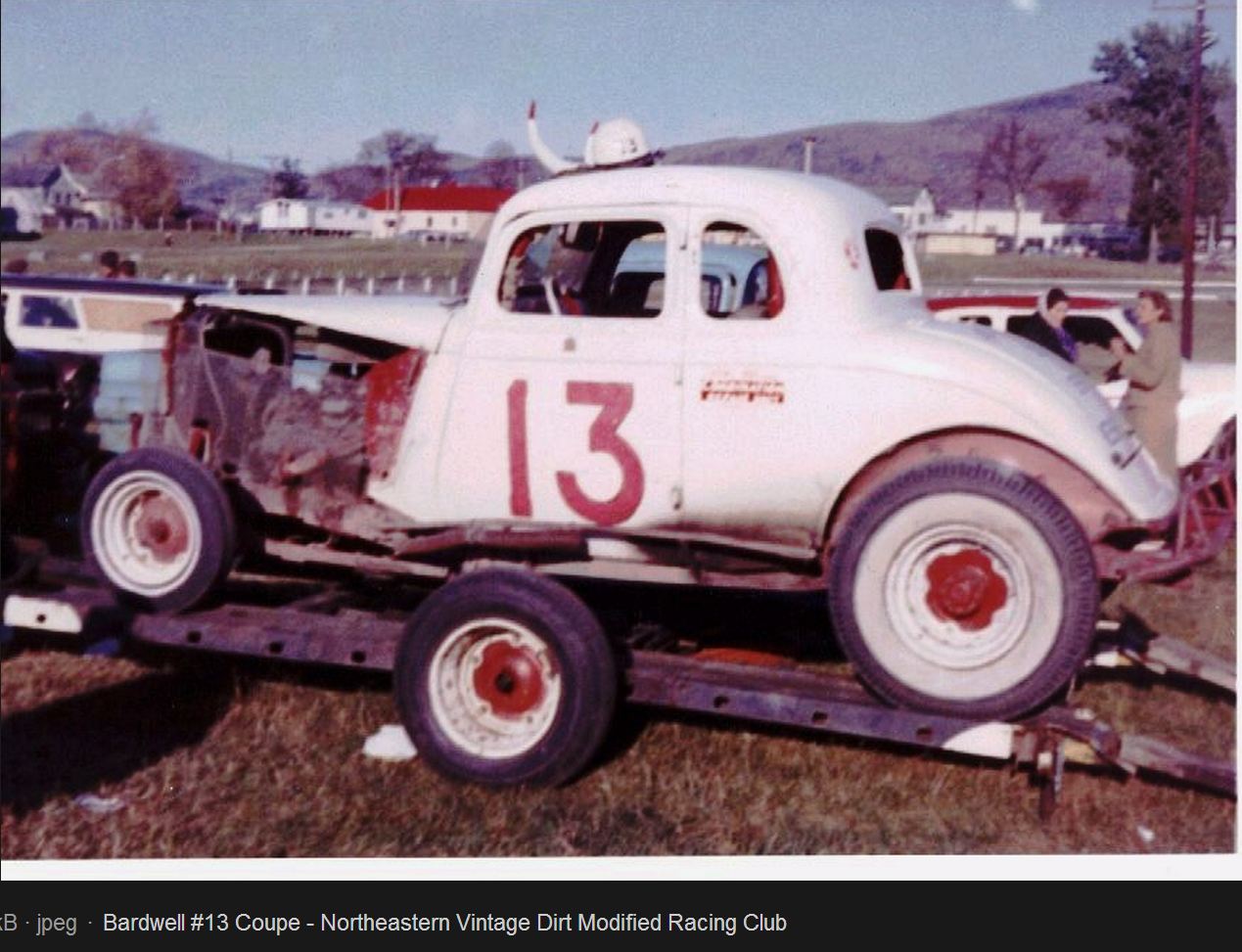

    Hi Bill, funny you post that picture of the number 13 race car... That's actually the guy that used to own my car. He never drove it, but he bought it about 30 or years ago I believe and it just sat outside by his shop.
    Looks like you had some fun doing some creative designs! I actually just bought a set of these lights last night off of here (original ones- not repro). Still had to pay for 'em, but I've always like this style headlight, looks real "clean" to me

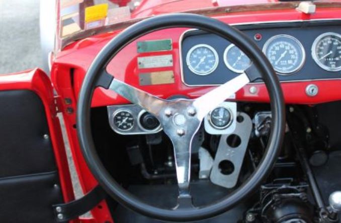

    So I ended up getting my quick release steering wheel hub in the mail today, so decided to weld that on and see how things look. The steering wheel was just one that was on the shelf, and I didn't really like the looks of it at first, but it's sorta growing on me now...
    I also started to hack up the old transmission cover I had.... Still needs alot of work, but I think it may look alright when it's done.

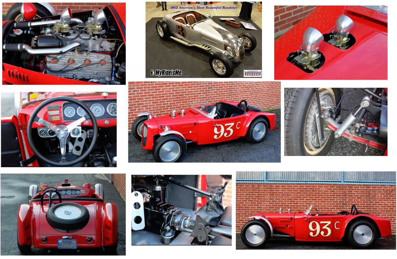

    Hi Shaun ! Steering wheel looks familure?? Couple nice cars Bill aka Tnomoldw

    Thanks for the comment Mike. I'm hoping not to hijack this thread while trying to encourage Shaun and to keep him from being bored with his project. The red roadster ''The Ingalls Spl.'' is in the museum building (brick wall) in the pictures with tons of other cars and a staff of nice people so the article read.

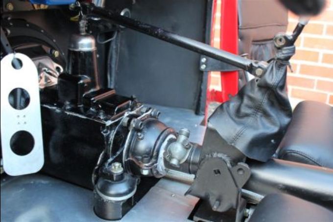

    :)Here is a pic of ''see the trany''. Crazy but cool heh ? Bill aka Tnomoldw :D

    Finally just decided to bite the bullet and bull into the trans cover today...
    There was too much open space around the transmission/bellhousing (my own mistake for not fixing that before I painted it!), so I started off by adding some around there...
    Then I bent a piece of plate for the hoop, and cut out a piece to close it in..
    It kinda looks goofy and big, but that was actually on purpose... There wasn't an easy way to seal the firewall cutout to the rest of the ch***is. So by making this cover big it'll hopefully be a little bigger then the firewall opening and help to keep some of the hot air from the engine out.
    Need to do some more fitting/cutting/welding, but this part is pretty well done. Just have to make a simple sheet metal cover for the actual transmission itself and I should be all set on this part of the project..
