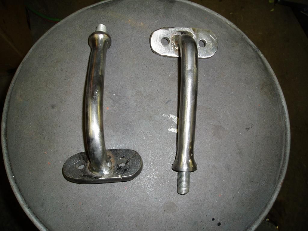

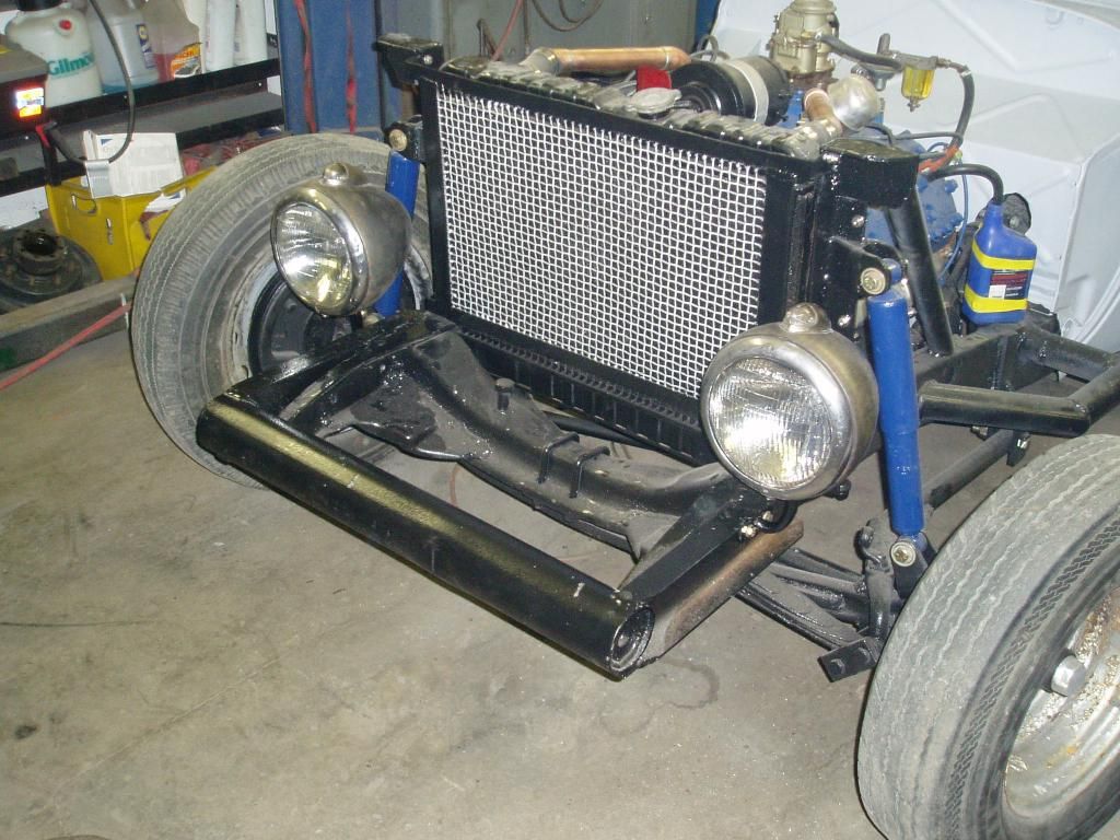

    Worked on the headlights today...
    Built these brackets out of some tubing I bent and some extra plate I had, then added the threaded rod and a taper washer to dress it up a little. I put another tapered spacer/washer on top of the one that's welded because of how the bottom of the headlights are (no idea how they mounted to the original vehicle- could have been on the fender or something)..
    They look kinda goofy in these pictures being only of the front of the car, but in the "big picture" of thing I think they look pretty good
    Maybe tomorrow I'll drive it out and see how they look outside..

    It is definately nice to do that now! Especially with all of the seat and steering figured out... Now I just need to do all the wiring so I can actually start it from inside the car haha!
    It was kinda tough to find a decent place to mount them.... Can't mount them beside the grill because of the shocks, and that's about as far out as I can go because the tires would hit them otherwise

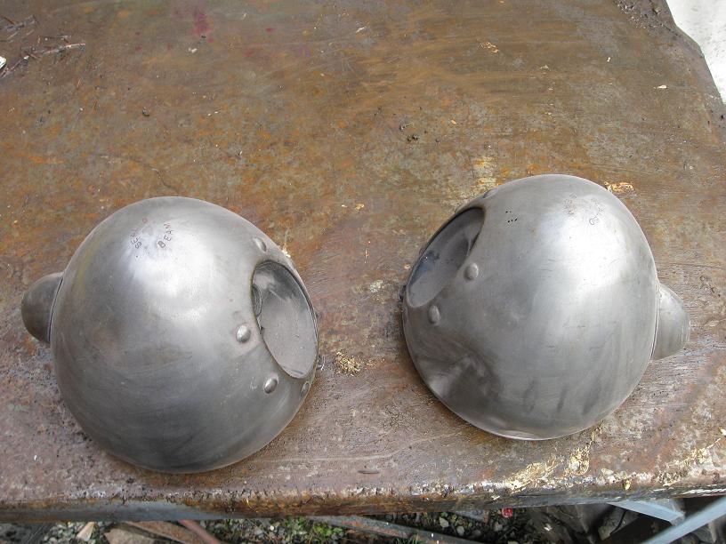

    Actually my headlights are kind of the reverse of those, they have an "indent" underneath where they mount... It's curved, so by adding a tapered spacer it's basically the same thing now, and allows me to move them. You are right about the adjustments, can only be done with the light out, and I did add a locking washer to the inside to make sure they stayed where they should. Here's a picture to show what they look like underneath....
