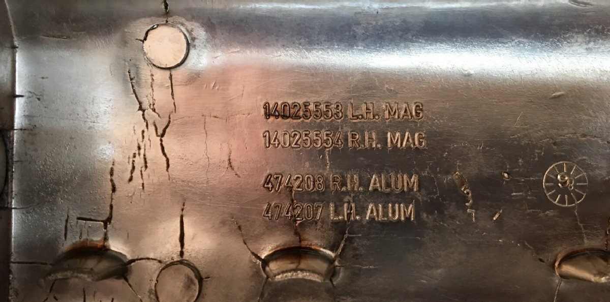

    OK guys, thanks for all the input! Let me provide you with an update to my dilemma on the fuel injection's fuel meter ( I originally referred to this as the fuel pump) interfering with removal of the driver's side valve cover. By loosening the fuel injection unit where it bolts to the intake manifold we were able to remove the valve cover. It only required a minimal amount of additional clearance. I've attached a photo showing the actual interference before loosening the fuel injection unit.
    In looking at the valve cover I am still curious if it is aftermarket or original GM. I've also attached a picture of the numbers in the casting . . . no evidence of a GM symbol.
    Lou, do you know if your valve covers are GM or aftermarket? Could the fact that my unit is supposedly a '65 make any difference in the size/shape of the fuel meter? And are those shrinkage (?) cracks on the inside of the valve cover typical?
    Thanks again for all the comments . . . they all help!
    Jim
    Jim: My Z28/LT1 valve covers are GM and the numbers on mine match yours.I have compared the Z28 covers to stock 56-67 corvette covers and can find no difference in height. I have had every variation of the Rochester fuel injection over the years and the only one I had the problem that you are going thru was a 1957 unit that required loosening the bolts and lifting the plenum just like you did.

    I've been told that when you encounter a problem you have three choices . . . fight, flight or compromise! So I compromised and ground the edge of the valve cover that was coming into contact with the fuel meter and buffed the raw aluminum to a pretty good gloss, almost chrome in appearance. Where it sits it is impossible to notice unless you've got a flashlight and a mirror!
    I still have no idea why I had the problem to begin with. My best guess it that it was a unique application of parts that combined to create a tolerance stack up. Problem solved, thanks to Lou and everyone else who offered up thoughts and ideas.
