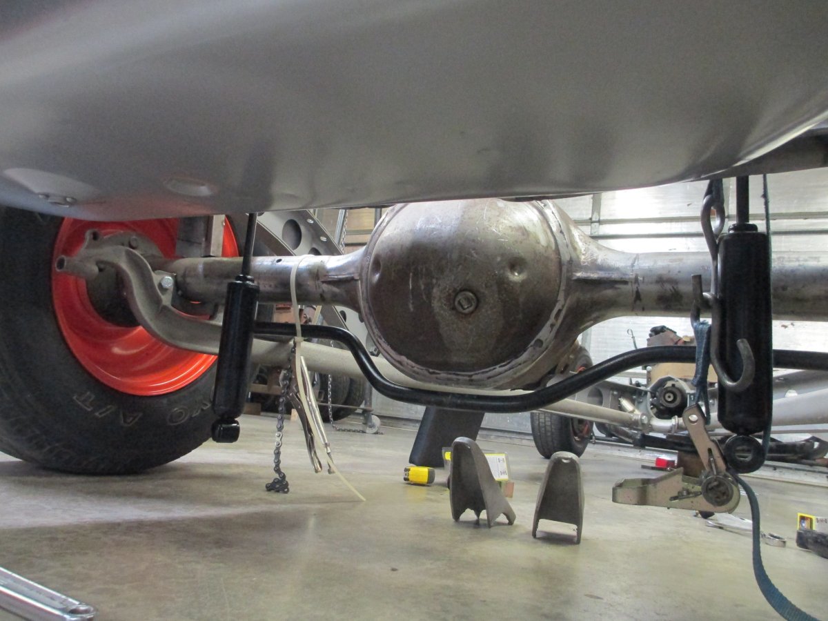

    The only thing we are not sure of is the rear end. We think its 9" out of a truck, if anyone has an idea let me know. The bolt patter is 5x5.5"

    The 5.5 x 5 bolt pattern is late 50's ford wagon or possibly a Bronco rear axle. HRP

    Awesome find and bumpers are 1967 to 77 bumpers 1966 are different and rearend is a 1966 bronco and I bet it’s a 4:10 as early bronco had a 170ci 6cy plus the only year to have a drain plug in the rear

    Thanks for the info, I was thinking it might be a bronco, the previous owner must have parted out a bronco for the rear end and the bumpers.
    the drain plug is directly on the bottom of the axle housing, so that was a 66 only thing?

    Yes 1966 only awesome truck and would love to have one like it

    63-65 Pickups had 2 dimples, and from the width of the welds on the axle tubes, it was probably narrowed at that point. Good luck, I am sure you and CJ, will make a nice truck out of it. BTW, I sold CJ a 34 Pickup back in the 70's ! IMG_4077.JPG

    The rear end being welded up in that location also caught my eye Marty, never have narrowed one in that location but on many occasions I have given it some thought! Seems like cheating!
