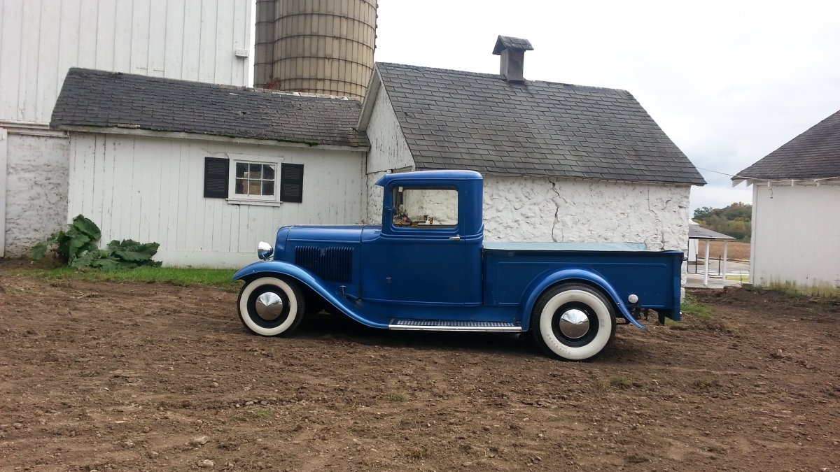

    Been awhile since I posted about this truck. It did the turn of being a bigger nightmare than we thought. Had the cab blasted and it was just full of rust covered in bondo, so the truck has become a flipper. We still fixed all the metal properly, but just so disgusted with the work it needed that it will be going down the road. Picked up a small block to stuff in it and get it down the road. but here are some recent pictures. The truck has been painted currently re***embling. Dealing with part shortages now with most places as its going back together.
    242829505_6910200145660347_7649723892563638333_n.jpg 243072527_6910200138993681_1439634266018234756_n.jpg 250462592_7096221080391585_7551796248323294835_n.jpg 250716278_7096221077058252_8553001214713533889_n.jpg

    Still a great looking p/u, you may change your mind once it's together!
