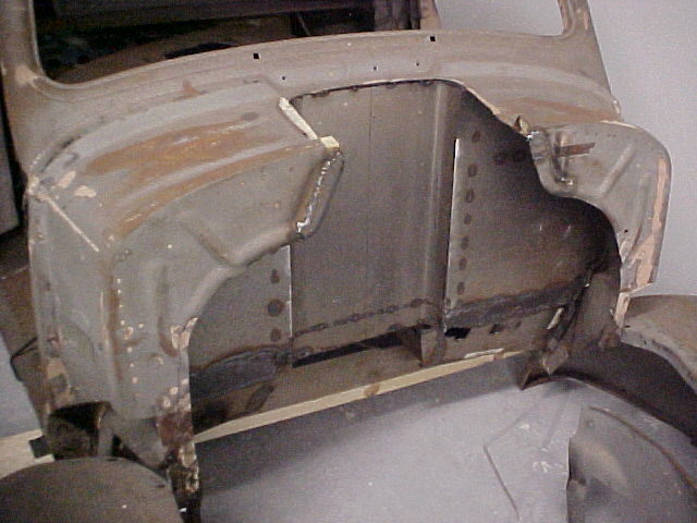

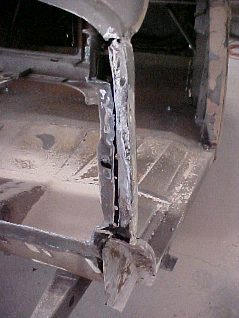

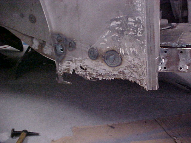

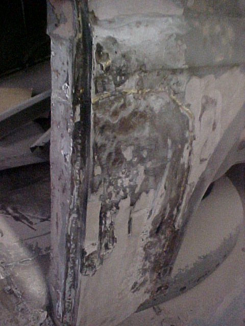

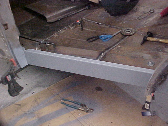

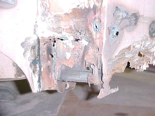

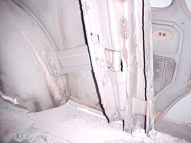

    Here are a couple pics of when I first got the car in. The "A" pillars were cut apart and hacked up behind the firewall they (the previous owner) installed. The floors were the direct sheetmetal replacement pieces, they mig welded them in without stopping the welder so they were warped horribly then they stuck 2" flatbar underneath to try to plug weld the seems to flatten them down, it didn't work. The doors didn't fit the holes so they were stuffed in and screwed to the door frames. The tailpan was swiss cheese and the drivers quarter was made out of bondo with galvy flashing as a backer. Had to totally cut out the "B" pillar as it was hacked beyond recognition. The floors between the "B" pillars were 3/16" plate and when the welded it in, the "B" pillars were 4" too wide. The whole roof on the p-side above the door was sagging down, you would have sworn it rolled onto the roof on that side except the sheetmetal was crushed. The trunk floors and inner fender wells were trashed and almost non-existing as well as the tailpan being made prtially out of bondo with no metal behind it. The deck lid skin was rotted at the botom and there was no inner skin. There was a ton wrong with the car, nothing was square or symetrical, everything was made of bondo and hack fabrication.

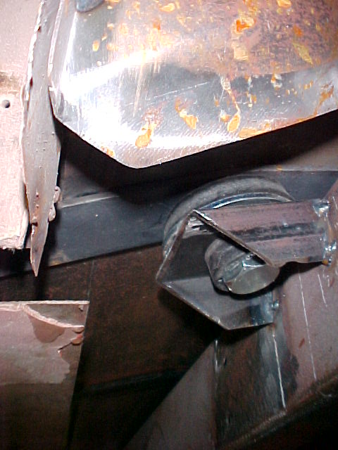

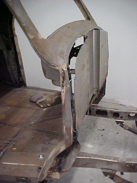

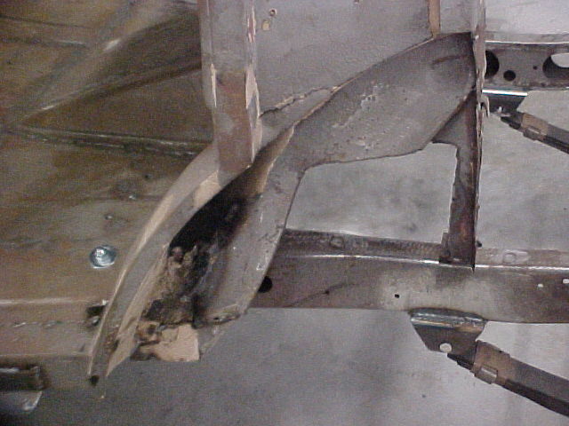

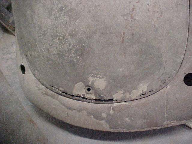

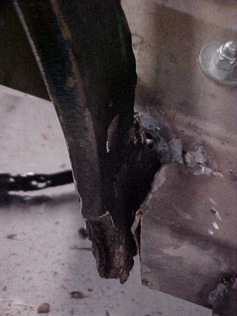

    couple more. The frame was a disaster too.
  9. Damn, nice work!
  10. Morris
    Joined: May 9, 2009
    Posts: 46
    Morris
    from UK
    Excellent save!
  11. Dayuuum!! Sweet!
  12. Brad saves another Willys from becoming an organ donor.
