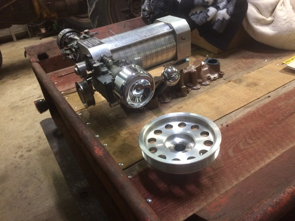

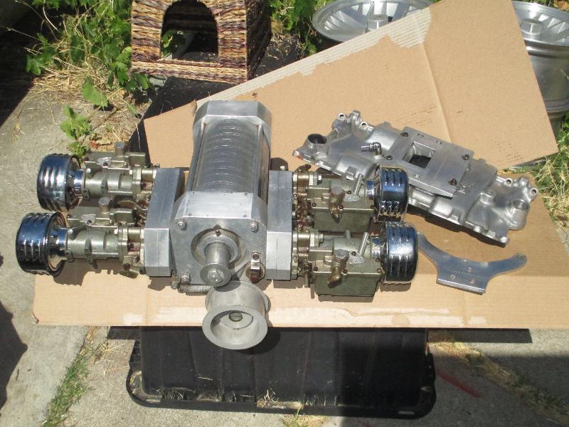

    Almost two years ago, I came into possession of the above described Latham. Today I received a second Latham more suitable for adapting to my 1954 Buick 322 Nailhead.
    When I got the Latham supercharger almost two years ago, it wasn't the best fit for the Nailhead but I figured it could be adapted to work. The biggest obstacle to overcome is that it appears to be a reverse rotation model built for a boat engine. This would require a custom serpentine belt, or gearing to make it work on the Nailhead. Such an arrangement would take away from the look I'm trying to achieve. I kept looking and a couple of weeks ago, The "test mule" for Motor Trend's June 1959 Cover story came up for auction on eBay. I won the auction and it arrived here at the Krash Kubicle around lunch time. Included were two belts, the pulleys, manifold and magneto that were on the small block Chevy test engine. It spins freely and the throttle linkage works well. This will be much easier to adapt to the 322 Nailhead and will keep its vintage appearance as well. The Latham tag still exists and this is a Model 28-A Serial Number 001359. I'm a happy camper. [​IMG]

    How was the Latham packaged and shipped. I have one to sell and am concerned about how to ship it safely. Thank you.
  15. LAROKE
    Joined: Sep 5, 2007
    Posts: 2,088
    LAROKE
    It was shipped pretty much as shown with the carbs still attached. The pulleys were in a cardboard box inside the main box packed with foam peanuts. The belts were in another cardboard box inside the main box. The chevy fuelie intake manifold and the magneto were separate and were wrapped in several layers of bubble wrap as was the Latham carb assembly. All this was in a cardboard box, 36" x 36" x 60" high with two layers of cardboard facing inside the box and packed to the top with foam peanuts. Took me about an hour to unpack it and clean up the peanuts. Came from Wyoming to South Florida via UPS ground. The whole package was listed as weighing 78 pounds and cost about $128. Outside of the package took a moderate beating but there was no evidence of escaping peanuts and nothing was broken, bent or gouged.
