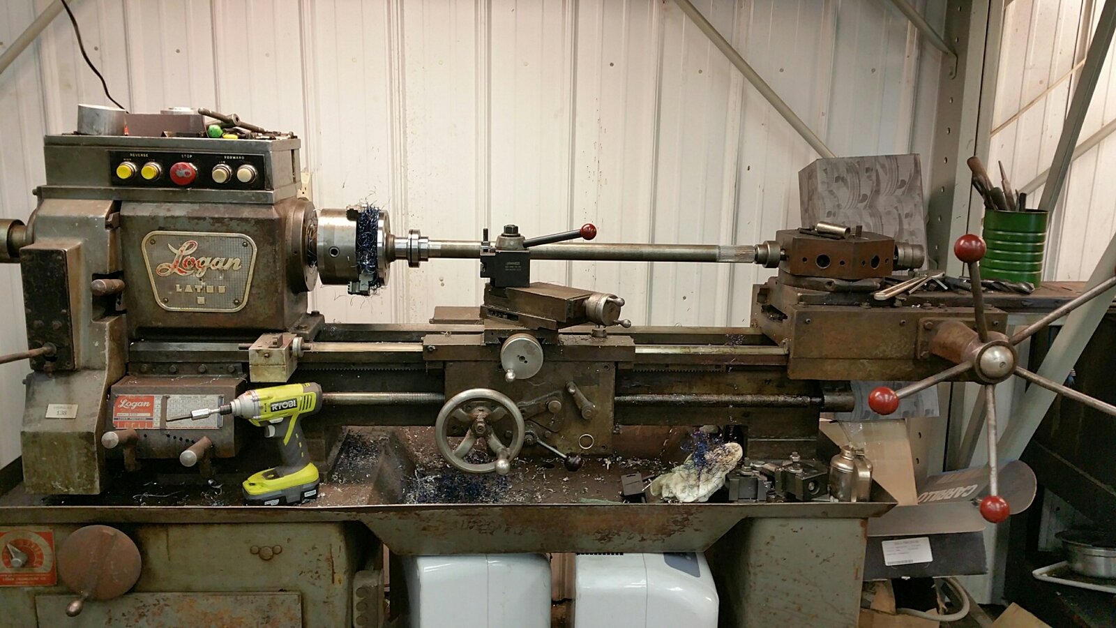

    Any lathe is better than no lathe, but a 6" will be very limiting for a hot rodder. I have a 14" Logan, and sometimes it is just barely big enuff.
