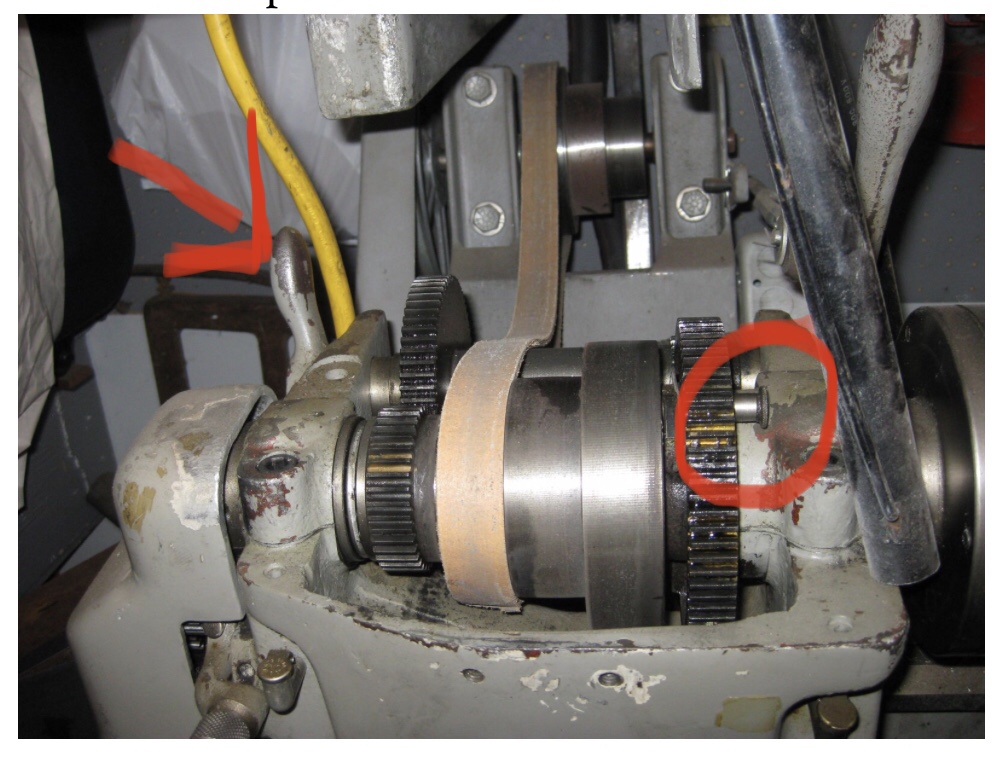

  11. goldmountain
    Joined: Jun 12, 2016
    Posts: 4,990
    goldmountain
    Feeling rather dumb here. I always ask for pictures when replying to a technical question, but somehow forget this concept when I'm in need of help. IMG_1523.JPG IMG_1524.JPG IMG_1525.JPG
    Deuces likes this.
  12. Boneyard51
    Joined: Dec 10, 2017
    Posts: 6,838
    Boneyard51
    I think that lever by the yellow cord is your back gear lever, shift it and see what happens.

  13. RmK57
    Joined: Dec 31, 2008
    Posts: 3,292
    RmK57
    Lift up the belt cover and see if the big gear in the back is meshing or engaged with the spindle gear. By position of the lever it looks like it is.
  14. goldmountain
    Posts: 4,990
    goldmountain
    The red lever does forward, reverse, and neutral. Gears are engaged. The belt drive is on the fastest of the three pulleys and it doesn't spin the lathe very fast.

  16. RmK57
    Posts: 3,292
    RmK57
    If the back gear is engaged you need disengage it by pushing the lever by the yellow cord forward. Do this with cover up so you can see how it functions. After that with cover still up you will need to push the spindle lock ****on on the big gear on the spindle. You may have to turn the spindle by hand to line up the pin with the hole to lock it. That is if it's a Southbend knockoff.
    One other thing is NEVER EVER engage the back gear mechanism with spindle lock engaged.
    One other thing is find yourself a manual for that thing.
    Good luck

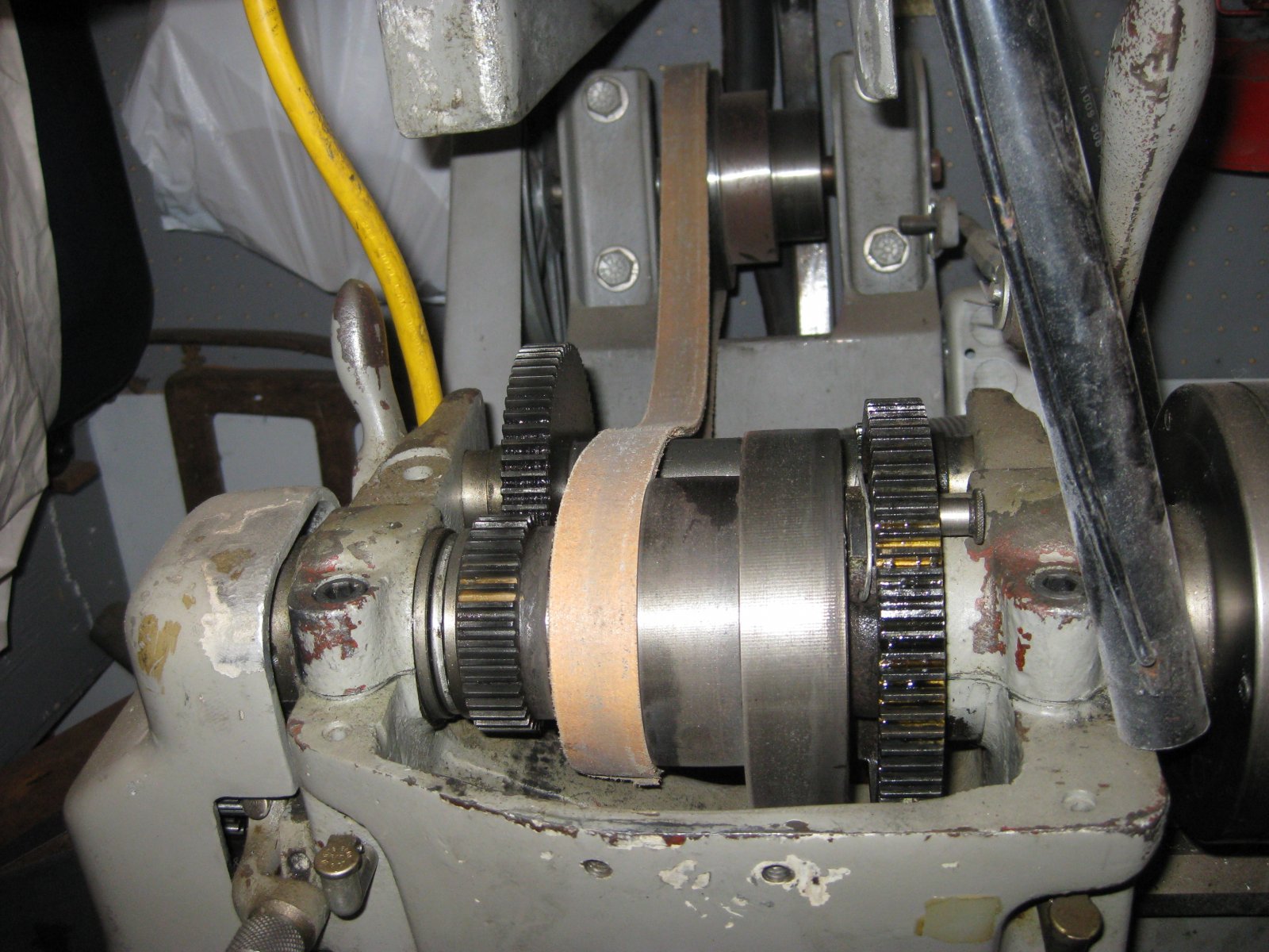

  19. 34 5W Paul
    Joined: Mar 27, 2020
    Posts: 506
    34 5W Paul
    from Fresno CA
    Hey Goldmountain, all good. I have an old 1950's USA made version of the South Bend Light 10. It's remarkable how similar that one is to mine. The cover you have open is the power feed ***embly. The lever is in neutral and up and down give you infeed and outfeed.
    What you want is to open the headstock cover. It's on top, and the power lever is mounted on top of that cover. I have mine on the front of the machine.
    Open the headstock cover and you should see what you are looking for - the pulleys via which you can change the operating speed of the, you guessed it, spindle. Mine is a flat leather deal like the photo below but your Daejung copy could have anything under there. Shoot some photos and let us take a peek.

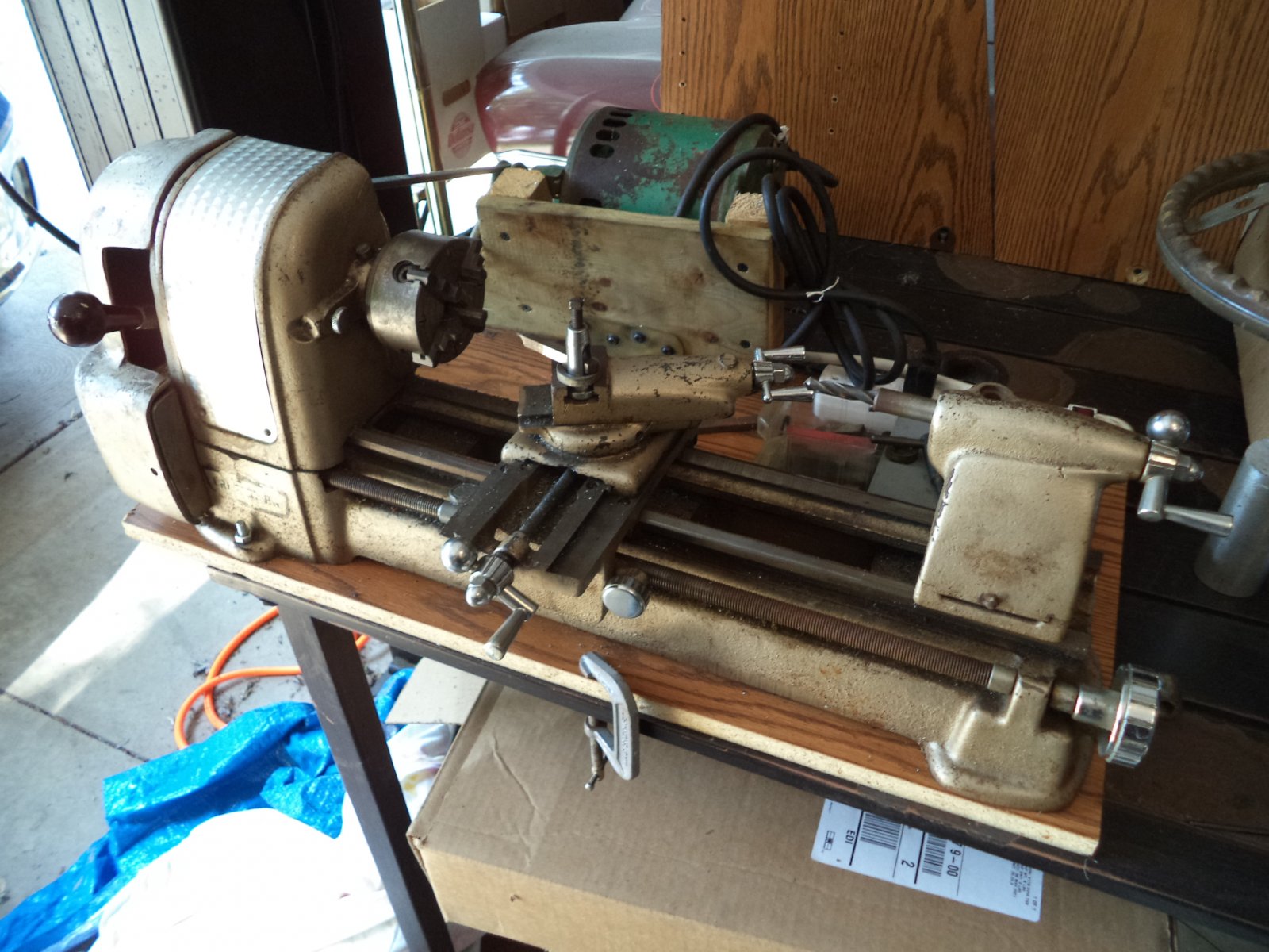

  21. patsurf
    Joined: Jan 18, 2018
    Posts: 3,416
    patsurf
    well-that's high gear-is the motor the right rpm?
  22. Boneyard51
    Posts: 6,838
    Boneyard51
    Like I said, in a previous post, that lever by the yellow cord is the back gear lever! Make sure your spindle is unpinned when in back gear, pinned when out of back gear! You can see the pin at about the top, a little this side, of the spindle gear! You have to index the pin!
    Probably the reason your lathe spins slow and stops when you touch it is that the back gear is out and your spindle is unpinned!
    PS, nice lathe
    Bones
  23. goldmountain
    Posts: 4,990
    goldmountain
    THANK YOU THANK YOU! If you look at my last photo, you can see the bull lock plunger is disengaged. Sure helps to have that "How to run a lathe" book to tell me what the parts are. Now it runs at a reasonable speed. After all this time, I might have an actual working lathe.
  24. RmK57
    Posts: 3,292
    RmK57
    It does look like the countershaft ***embly is ****eyed in your photo. That will throw the belt off in a jiffy if not aligned properly. There are online tutorials on how the align the pulleys up also using a carpenters square.
    As I mentioned before is to NEVER EVER engage the back gear without pulling out the lock pin. Could result in broken gear teeth.

    Joined: Oct 16, 2018
    Posts: 386
    TRENDZ
    The pin (in circle) is pulled out. You must line up the spindle with the pulley pin hole by hand, and push it in. Once the pin is in, you have direct connection. Be sure the handle (arrow) is now in the position that disengages the gear set. 489A4F3F-1FF6-4C52-9309-58D4BA756EF1.jpeg
