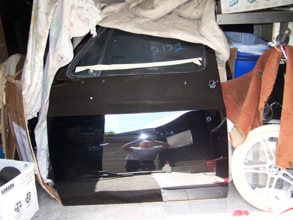

    as what has been stated, it is important to get the surface as smooth and straight as possible and it starts at the metal. if filler is needed it should be sanded down to 180 or 220 grit paper. i then seal with one coat of epoxy, followed the next day with 2k filler primer. i then let it sit and get hard. i block that out with 220 grit dry. then spray it again with 2k filler primer. let sit to get hard then wet sand with 400 or 600 grit. clean and tape off the shop and car. come in the next day with clean clothes,don't pet dog or cat, no coffee, tack rag and spray. wet sand and buff.
    painted in a barn
