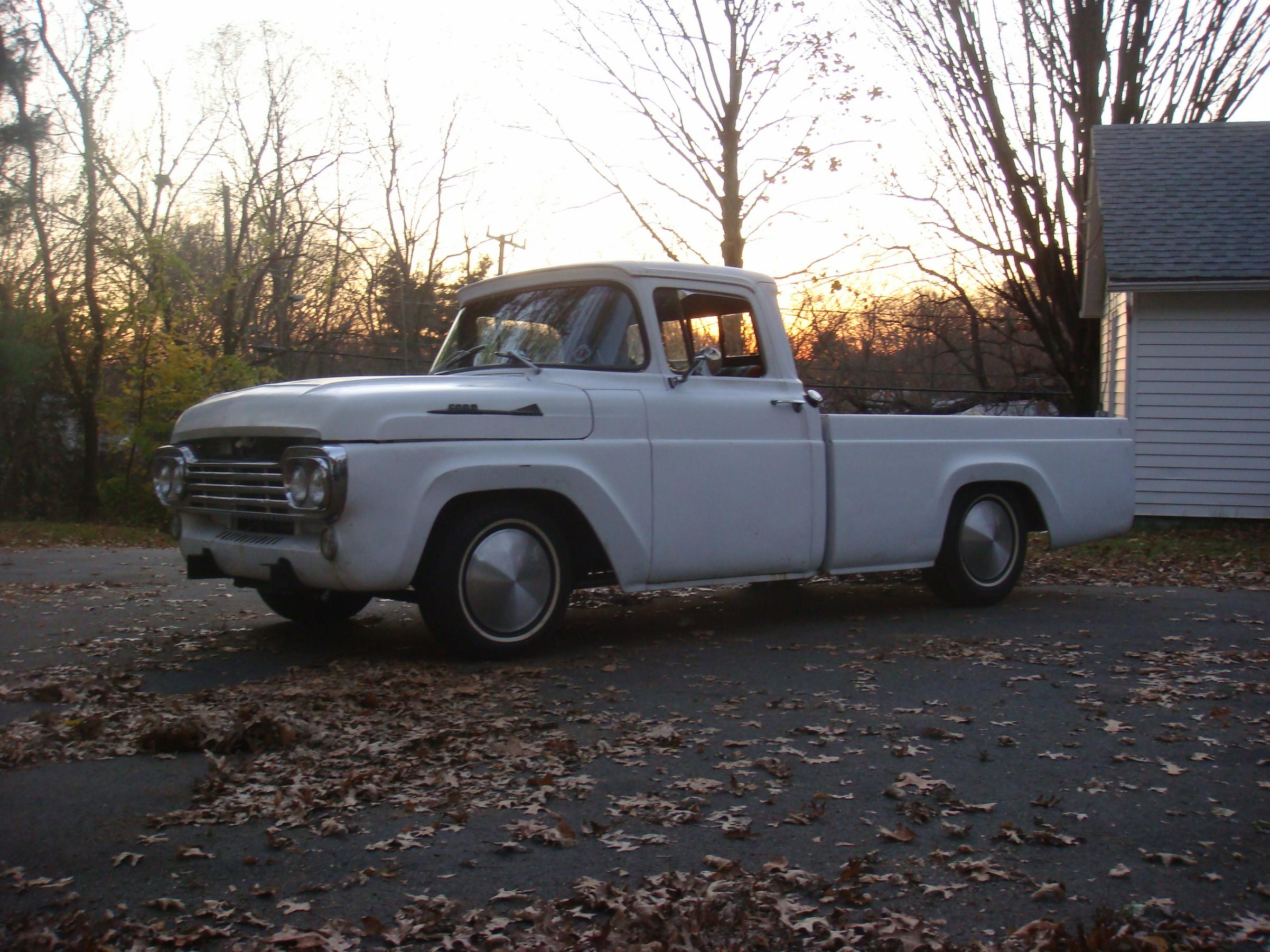

    sorry i missed that... it has a mor drop 3'' with stock springs with 3 leaves removed.. the rear leaves have been robbed also including an axle flip and a c notch.

    Cool, thanks. How's the ride? Bump steer?

    im gonna switch to monoleafs..it rides rough

    FYI My monos ride ruff too..............

    I have mono leafs in my 58 upfront. The ride isnt horrible but I do avoid certain roads. I did an axle flip in the back and the rear sits super low. My leaf springs are de-arched thanks to age.

  12. choice truck! what size Firestone's did you use?

    6.00 out front and 7.50 in the rear.
