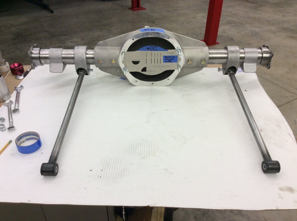

    When I fabricated the rear suspension for the Comet I used leaf springs with tubular bars mounted under the housing going forward to the front eye of the spring. The leafs are relocated inboard 2 1/2”, the front of the bars mount to the same through bolt that locates the front spring eye, the rear of the bar in in the center line of the axle under the housing. I put 1,000 miles on the car before the weather closed in and I am very pleased with the way the rear suspension works. There is no bind and the car rides well.
    My opinion is that if the geometry is correct a Leaf/Link system a good option.
    6C8E6F2B-30D2-4D04-82E4-495C80D34434.jpeg 58700AEB-461E-446E-916D-6527BD4B67BF.jpeg

    I was thinking of adding 2 lower arms to my rear end similar to what @kabinenroller has above but longer and made of 2x2 box. I would then be adding airbags to that. I can not see any downside but wanted to see if anyone has tried this or sees something I am not. (I know how to set up arms so there is no binding and all that fun from my off road fab experiences)
    I currently have 2 leaves and 3 inch blocks in the rear. It is an air over leaf setup and rides pretty stiff/bouncy due to the high pressure needed to get the car up and as many know with minimal leaves we get axle wrap which will eventually break the leaves. Also the suspension travel is limited to the bag travel which would only come into play if I needed to change a tire.
    I thought if I could add some 2x2 "traction" bars to the bottom of the rear end and run 2600 bags off those arms to provide the lift that would work. It would minimize the axle wrap acting as a traction bar which would extend the life of the leaves and it would provide me a better ride due to the 2600 bags being an air over link design. I am not wanting to go to full 4 link because I do not want to modify the body (Rear seat area). Also if I tried parallel 4 link the pan hard is right where the gas tank is. I have searched everywhere and could not find any info except this thread.

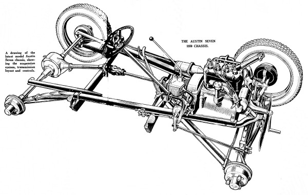

    Austin seven rear suspension. Quarter eliptic springs and torque tube.
    Doesn't get much simpler than this.

  26. Gofannon
    Joined: Feb 8, 2007
    Posts: 1,003
    Gofannon
    Austin 7s handle like ****, something to do with wheelbase changing with suspension travel.
  27. '29 Gizmo
    Joined: Nov 6, 2022
    Posts: 1,214
    '29 Gizmo
    from UK
    Bruce Mclaren's first race car was an Austin 7. They are still popular with vintage race series today.
    rod1 likes this.

    I know this is an old thread but '29 Gizmo's post a few posts back seems to have hit on what the original post was asking about. I think the Austin 7 with an addition of upper links to handle torque is on target. Seems many posts went different directions....which is traditional HAMB practice.
    Someone who I think was from Iowa built a Model A with quarter elliptics and upper links a few years ago and actually did some drag racing with it. As I recall I think it worked quite well.
