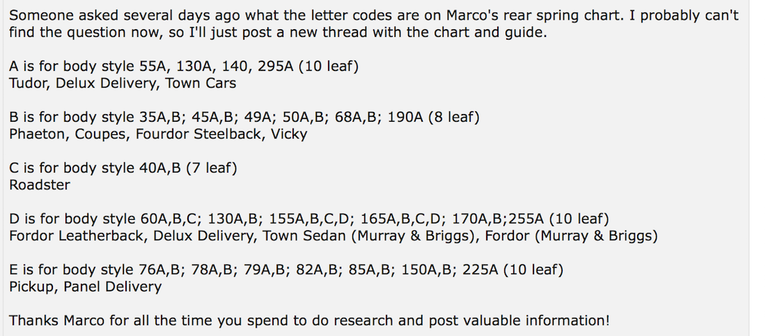

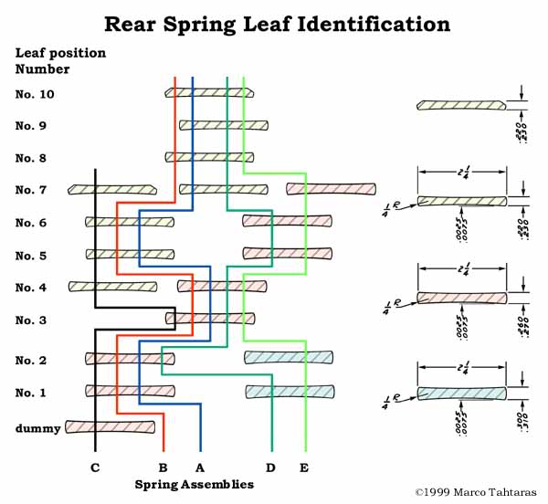

  6. BigEd
    Joined: Aug 12, 2005
    Posts: 248
    BigEd
    Don't know if this will help, but here it is.

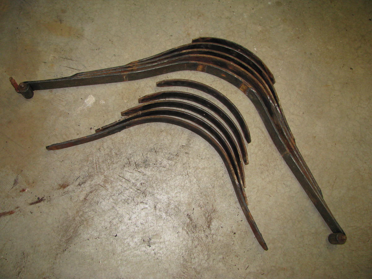

  7. 48fordnut
    Joined: Nov 4, 2005
    Posts: 4,215
    48fordnut
  8. 48fordnut
    Joined: Nov 4, 2005
    Posts: 4,215
    48fordnut
    this is what the model a spring looks like now. removed 4 leaves.

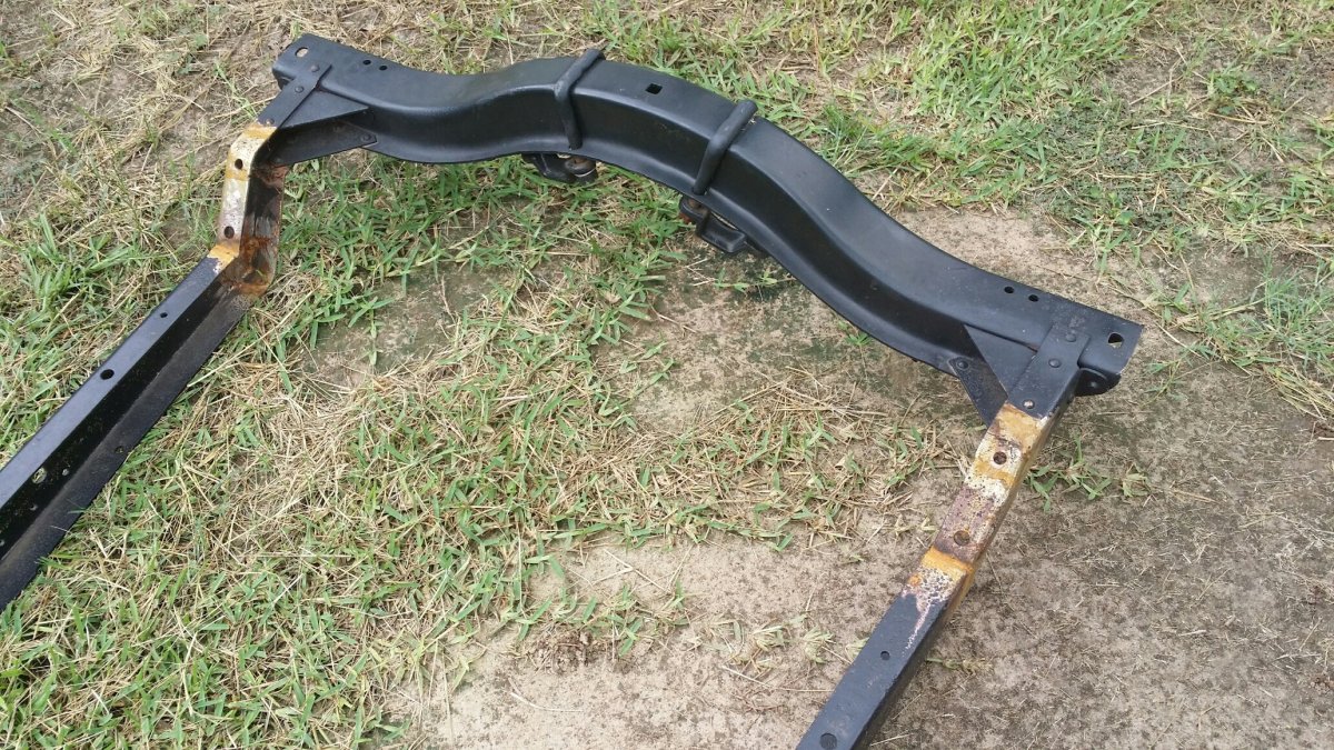

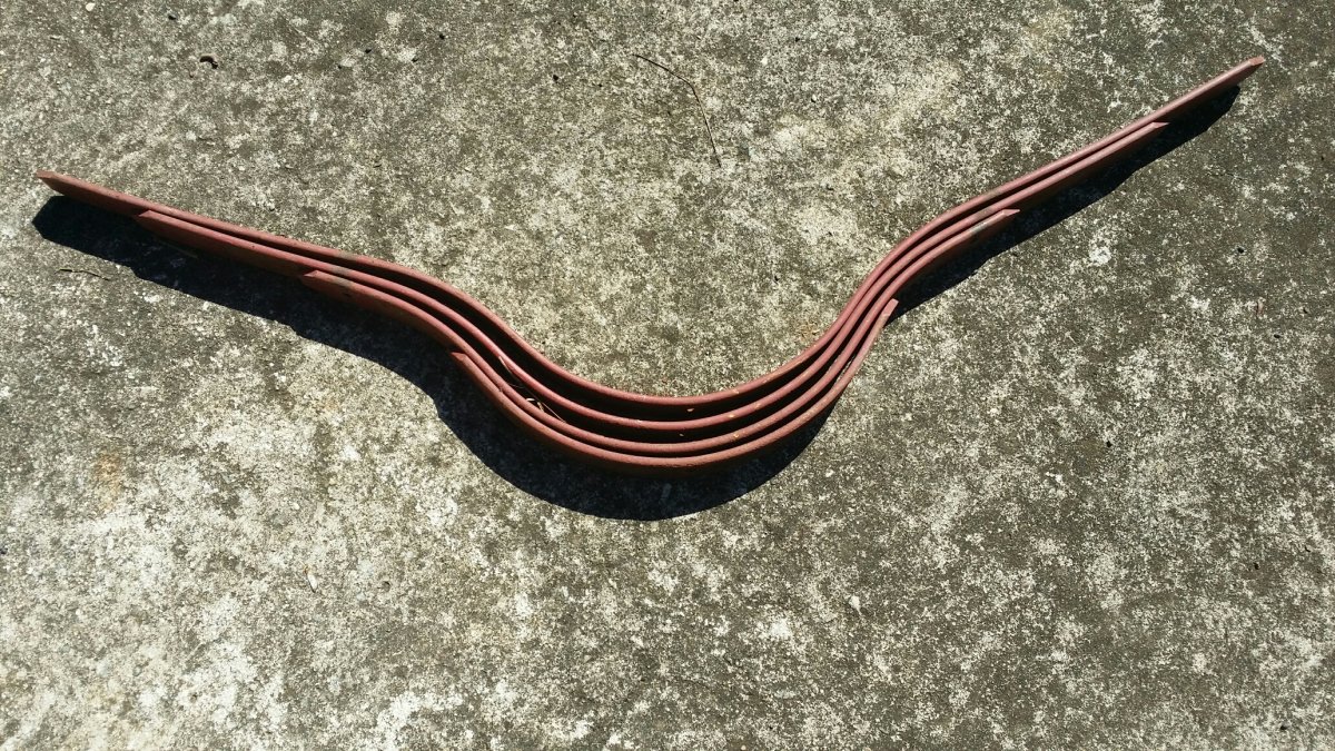

  9. Blake 27
    Joined: Apr 10, 2016
    Posts: 1,554
    Blake 27
    I kept the four longest leaves and the shortest tapered leaf (to fit the inside of the cross member). I shortened the second leaf after I reversed the main leaf.
    I also welded spacer shims to the U bolt clip bars to make up for the skinny spring. 39-001.JPG
