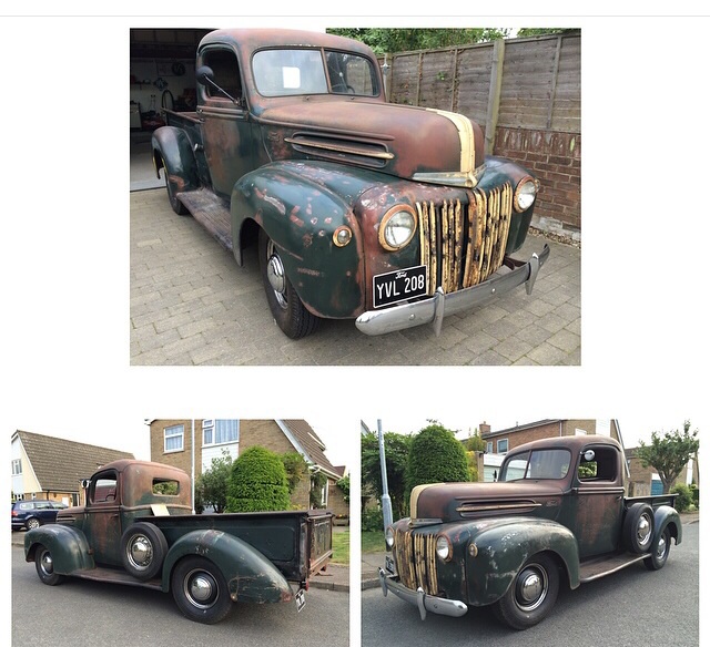

  22. Ian hall
    Joined: Aug 30, 2010
    Posts: 179
    Ian hall
    from Uk
    Finally back together. Not super low but looks so much better
  23. Ian hall
    Posts: 179
    Ian hall
    from Uk
    Front suspension is very firm, make that very very firm!!
    I have only removed the shortest leaf, should I put that back and remove a longer one? Don't mind if it drops a touch more but would like to soften the ride
    Ian
