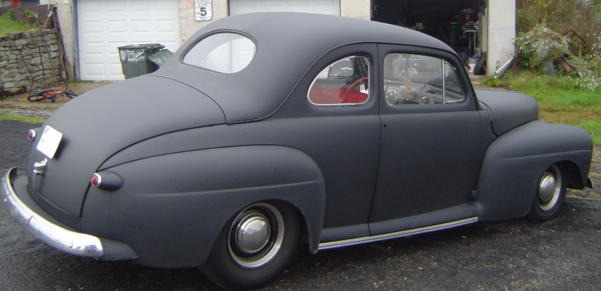

    Here's the story, the short version........I have a '47 ford which has been converted to leaf springs in the rear.........and the axle is already on top of the springs.......................
    I am trying to lower the car..........Blocks won't do enough, the leaf springs are already looking a bit flat, so no removing leaves..............
    So, I started thinking that the thing to do is to get reversed eye springs and then blocks.........So, I measured the springs, eye-to-eye and came up with 52 1/2" Does anyone know where I can buy reversed eye leaf springs that are that length? And no, I don't know what the springs are from.....
    And is measuring eye-to-eye enough or do I need to measure something else as well?
    Thanks in advance for the help.
