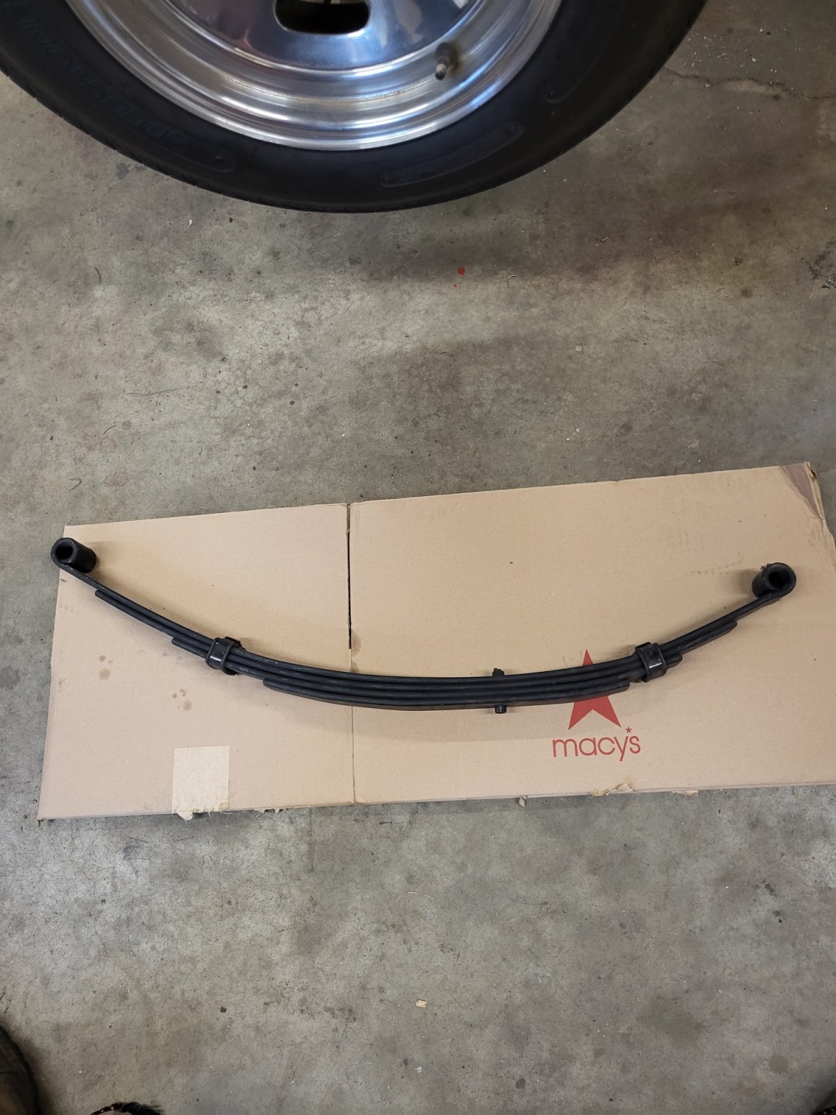

  13. I need to keep the axle where it is, moving it foward would look more akward then it already does. I thought about re-drilling the main leaf, but the way the spring was made, there is a nice flat spot for the axle seat. I think you can see it in the picture. I'm just going to use it in reverse. I feel pretty sure it will be ok. Thanks again for all the input, Gene. Resized_20230628_202300.jpeg

    Looking at your picture of the spring, I think the only thing you will gain by drilling a second center bolt hole in the main leaf is a better chance of having the spring crack. The old hole will be in the flexy part of the spring. If you stack the springs backwards on top of each other with a couple of bolts through the bushings, that will help you visualize how reversing the lower leafs will look positioned on a new center bolt hole. I'm pretty sure you are going to find a gain of net zero, or very close to it.

    The Chrysler engineers made the springs offset for a very good reason. And even springmakers can't give you good advice [because they don't know the whole suspension design]
    If you are "hell bent" on turning the springs around 180° you need to make the springs very stiff [adding leaves] or add some forward control arms [to alleviate axle thrust]
    Now, the longer the spring [overall] the softer it is. And vice versa!!
    Chrysler offset the spring centre on Long Springs so the front half was stiffer to control "Axle Thrust" "Pinion Torque Reaction" and most importantly "Brake Torque" without sacrificing ride quality [by keeping the overall length longer]
    They also changed the angle of the spring so the Arc of suspension movement [red arrow] cancels out the spring lengthening [blue arrow] along the datum line. This prevents /minimalizes "roll-steer"
    Crawl under any factory built Leaf spring rear and you will observe the rear spring eye [shackles] is always higher than the front spring eye [hanger]
    This is roll-steer [RH turn with Body roll to the left]
    It doesn't stop there either
    you need to know the spring stiffness and the sprung weight , to calculate the spring load for static ride height and suspension frequency etc.
    If you turn the springs around , add a block of wood under the gas pedal [it is not good engineering practice ], regardless of what some "phone jockey" from Detroit Spring told you.

    Is that a trailer spring?
  23. Ebbsspeed
    Joined: Nov 11, 2005
    Posts: 6,479
    Ebbsspeed
    That's exactly what I thought when I saw the image. Sure looks like a trailer spring.

    seb fontana
    from ct
    I think its not; if it were the center bolt would be centered? All I've dealt with have been on center.:)
    lothiandon1940 and Johnny Gee like this.
  25. No, it's not a trailer spring. Most trailer springs are 1 3/4" wide, these are 2" wide. I had them made at a local spring shop when I was thinking of changing my '40 to parallel leafs on the front. I did a little more checking and it looks like I could move the center pin 3". That would give me enough room to put the springs in, short side foward. And I'm going to have to drill all of the leaves or they would stack wrong. Gene.

    Trailer springs also have very small eyes on the ends that are only 3/4" so they don't accept bushings that are very large OD like car springs use.
