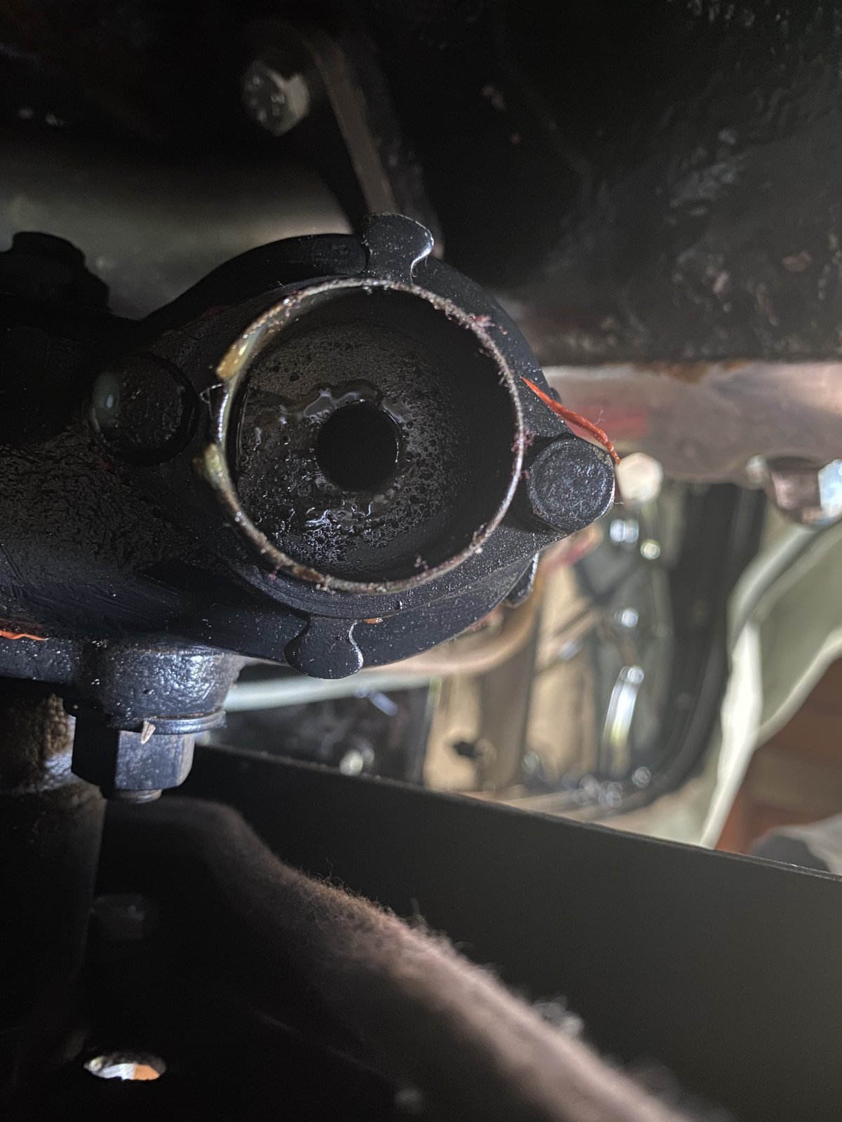

    Have a stock '32 box....was rebuilt many moons ago.
    It leaks off the very front end (open) cap area.
    I would like to remove it, clean it, reseal it up.
    Looks like the rebuilder used some orange RTV years ago and it failed.
    Any helpful hints on steps to take on doing this would be welcomed.
    I ***ume I remove the 2 attaching bolts, clean it up, put on a new gasket & sealer?
    Are there gaskets available and from who?
    What flavor steering box lube is preferred for the box?
    Thanks!

  10. jimvette59
    Joined: Apr 28, 2008
    Posts: 1,146
    jimvette59
  11. hemihotrod66

    In 1932 they had a tube attached to that plate that went above the level in the box...Make sure that is still there....It is available as a repo part... I used old main bearing packing rope to make the seal around the pitman shaft...Work fine on my restored 34...Had no leaks and used 140 gear oil...

    I believe the use of the tube started in 1933 and was also in 1934. The later tube will fit into the '32 steering box. Most of the repro's are made for Model A steering boxes and will not fit the later units.

    I see the tube leaking in the picture replace it or silver solider it.

    I hath remove the end cap & tube.
    Is the tube supposed to appear like the Leaning Tower of Pisa?
    Could this be contributing to my leak?
    It slid out of the steering box smoothly.
    It had a gasket and that ugly orange RTV sealer on it.
    Thanks!
  19. Only after a head-on crash. Just cut the bad end off, clean up the plate and re-solder square and true at right angle.

    Straighten up the tube and solder it solid to the plate.
