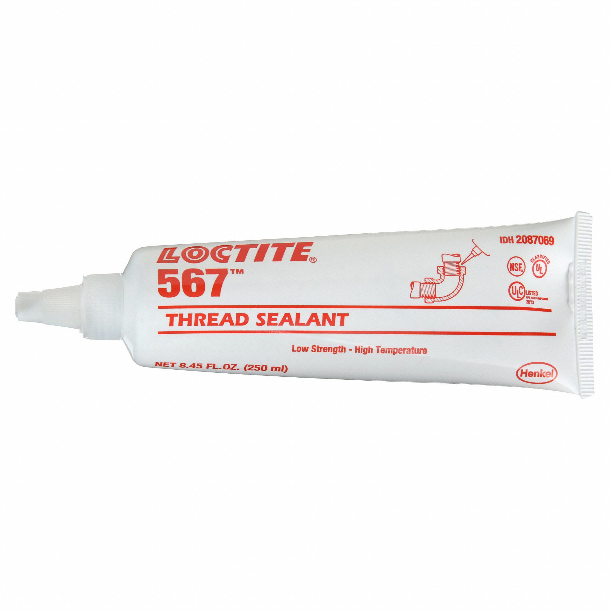

  19. deathrowdave
    Joined: May 27, 2014
    Posts: 5,105
    deathrowdave
    from NKy
    Lock ***e thread locker. Fittings must be dry
  20. Check if it's a inverted flair fitting, straight thread or pipe thread.
    IF it's a pipe thread:
    Or
