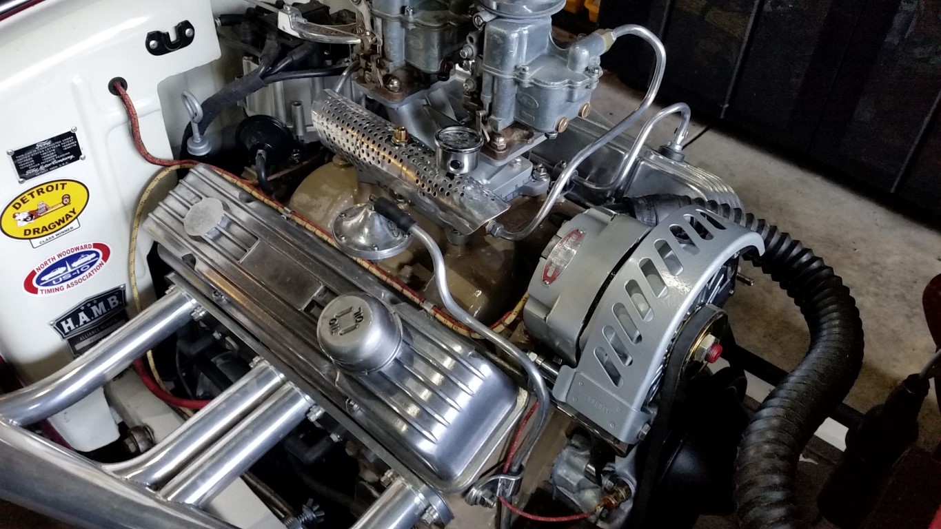

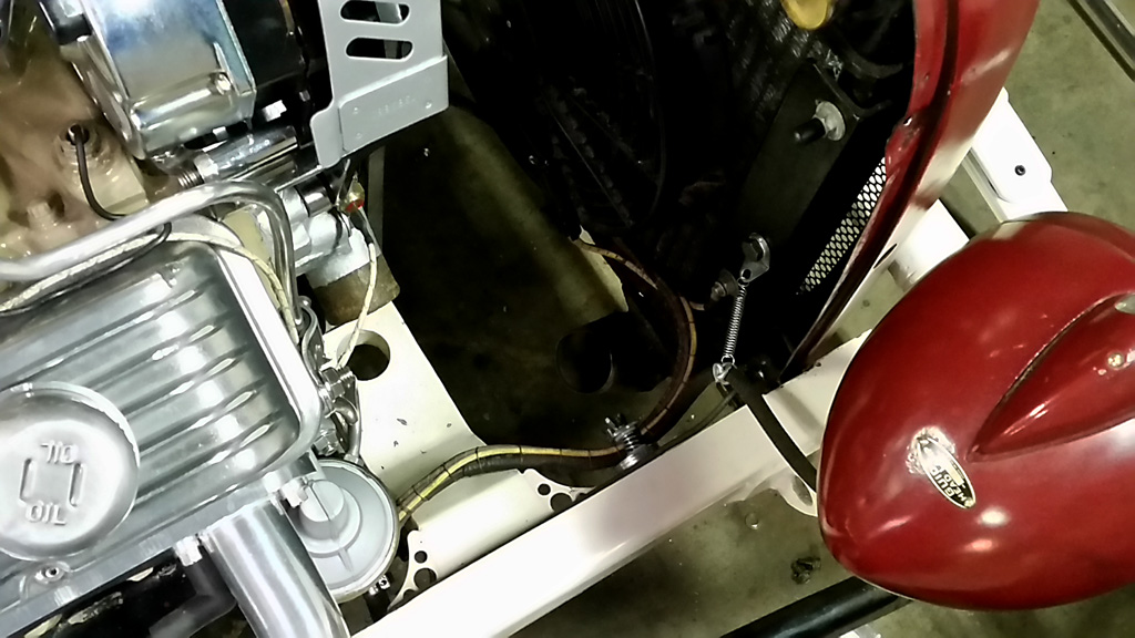

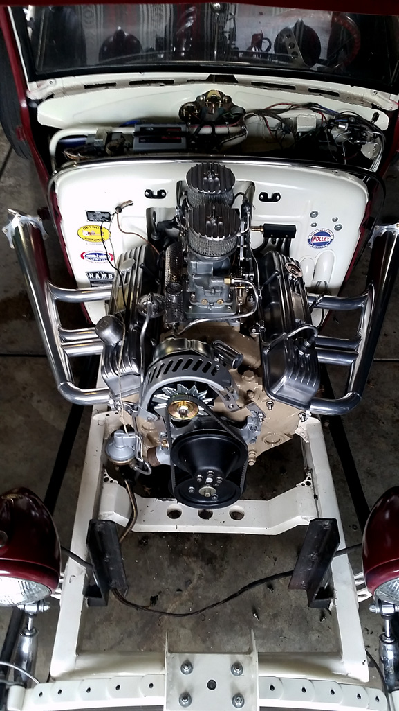

    Last night I only had a little bit of time to spend on the A so I just did a few miscellaneous tasks, including finalizing the fuel system layout. Next step for the fuel system is to tighten everything, a little polishing, and possible re-route of the hard lines.
    and since its become a pattern now, how it sits this morning.

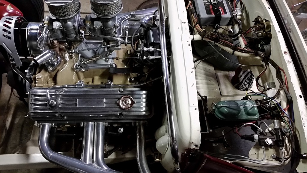

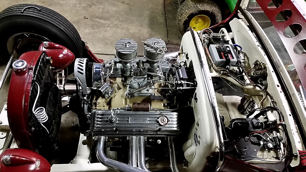

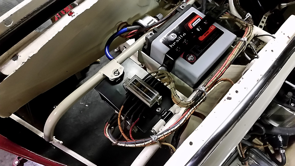

    I finalized the under dash/cowl wiring, mounted some of the wire standoffs, radiator, and overflow.
    The fuse box tucks up into the cowl, however a Dzus fastener can unlock and swing it down for easier access from the p***enger compartment.
    Harness mount, headlight wiring
    and of course, how it sits now.

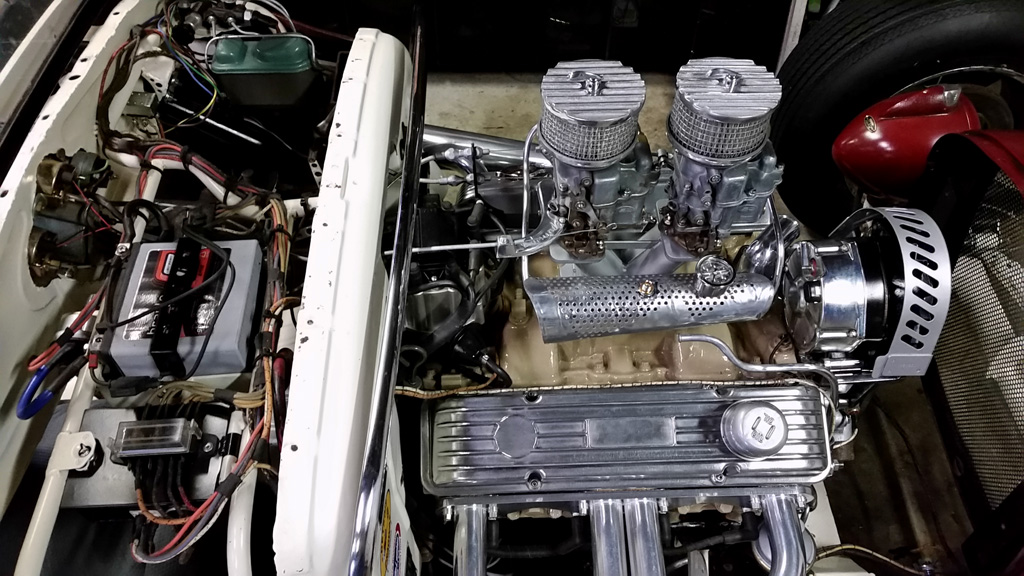

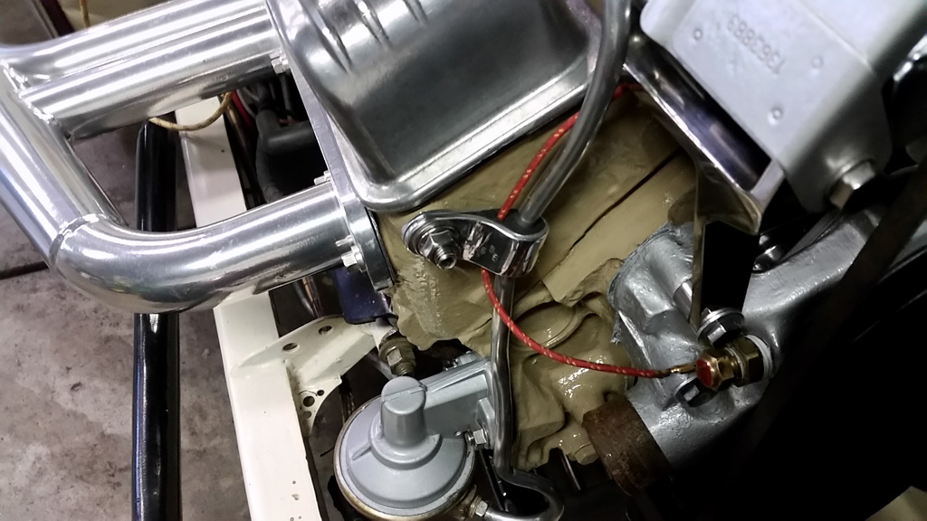

    I spent some time doing this Sugru mount project here so I only have a few updates to share.
    I redid some of the wiring(again) to further clean things up

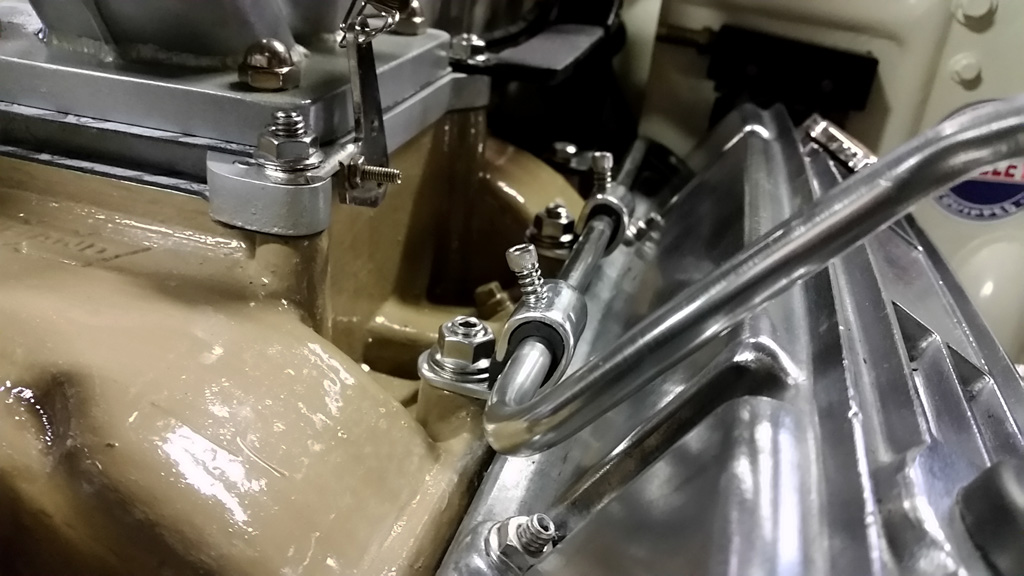

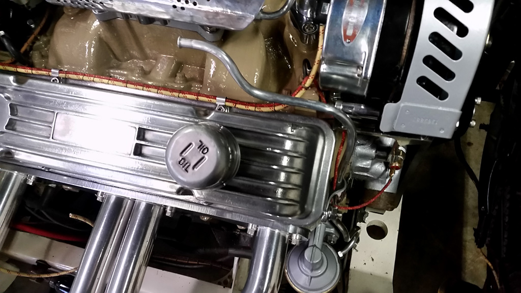

    Finished the fuel line mount which previously had a piece of tubing and a dab of Sugru to hold it in place. Now I have made the entire insert from Sugru.
    While I was at it I also did the PCV line mounts for the same reason, simplified the design and replaced the hard line as it had been bent and scarred enough.
    Closeup of same, you can clearly see the mounts now.
    These last few shots are after some body cleanup time was spent.
    The only things left are the oil pan, finish the fuel system, make all connections, fluids, and then fire it up. This week it's looking like unless more things pop up of course.

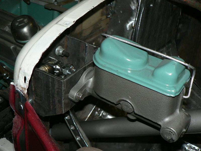

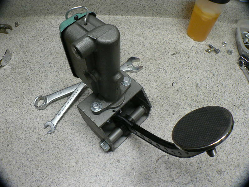

    Do you have any pictures (Close up) how cowl removal is accomplished? My son and I are building a 30 closed cab pickup. I planed on a 90* peddle ***embly . WOW do I like how you did yours. I am going to copy.
  15. Probesport
    Joined: Feb 15, 2007
    Posts: 1,105
    Probesport

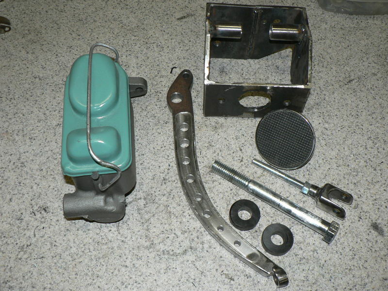

    Thanks, lots more pics on my blog - modelabuild.blogspot.com but the cowl is screwed on as they normally would be so I do have to take out a handful of screws. The tank was removed from the cowl top, and a portion of it became the dash.
    I believe on the blog there is a complete writeup of the pedal ***embly including all the parts, I would have to dig through to find it and I can't access it at the moment. I am more than happy to ***ist with any questions though.

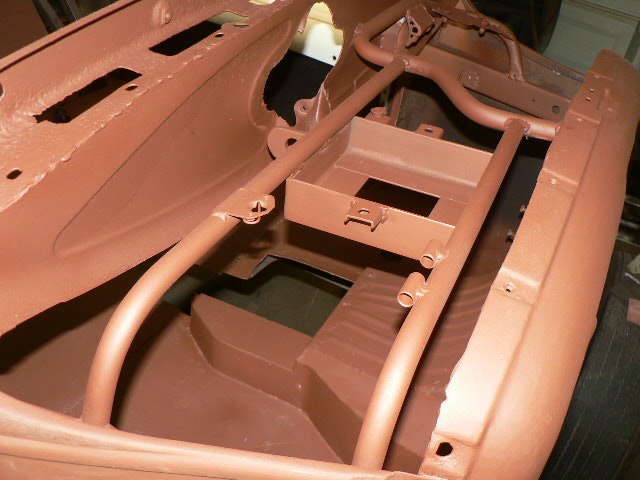

  16. Probesport
    Posts: 1,105
    Probesport
    Here's a few pedal pics I found
    The bare ch***is, with cowl off and "dash" remaining
  17. Probesport
    Posts: 1,105
    Probesport
    more
    and more pedal
    Hope that helps!

    Looks really nice. I really like the lift off cowl cover exposing the wiring and master cylinder. How do you do the wire lacing? what is the material and how is it secured?

    I would like to know more about the battery in your cowl. Is it just for audio and or alarm or is it for cranking. The size is just right for tight installs. I am close to wiring a new build of my 29 A RPU. Thanks

    Wire lacing is done with lacing tape or string, a wax coated line that si specifically used for wire lacing. It's actually one continues run only tied at each end. Check out this link for more info http://www.dairiki.org/hammond/cable-lacing-howto
    That battery is my only battery, it powers the car - I currently have no audio in there - not that you'd hear it anyway. It's been in there a couple years without fail, I have a battery tender lead that I can access through the original gas cap

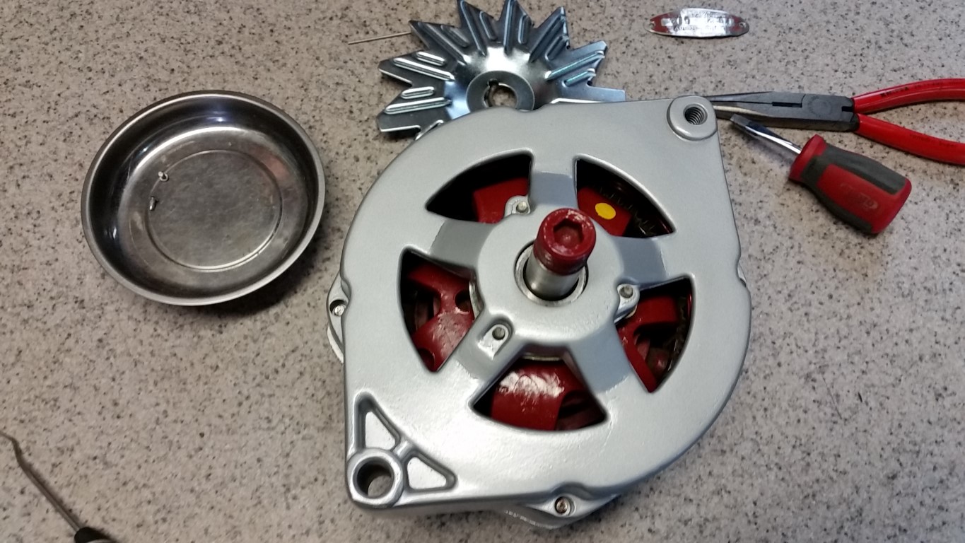

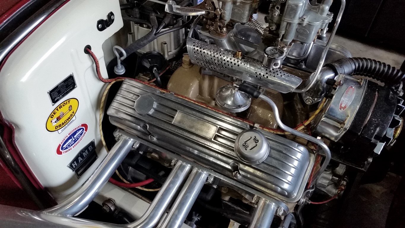

    Alternator now on and done. I didn't care for the black paint that I did previous so I had to repaint, and since I was in there I refreshed the internals.
    KoolKat-57 likes this.
  28. indyjps
    Joined: Feb 21, 2007
    Posts: 5,393
    indyjps
    Beige is a better match with the maroon, that green is a nice color, may have to use it in the future.
    If your looking for opinions: the alternator cover draws my eyes to it in each pic, stands out and doesn't tie in with the rest of the engine. Maybe it's just the slanted cut outs.
    Overhaul looks great, keep the details coming.
  29. Probesport
    Posts: 1,105
    Probesport
    Perhaps, but I like it so I have to just deal with it not looking good :)
