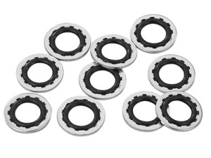

    Help! Can't get my front brake hoses to stop weeping brake fluid at the crush washers. I have tried just about everything to stop the leak. They weep just sitting there, no pedal pressure on them. 2 sets of hoses, many new banjo bolts, many copper crush washers, and I even tried "Stato Seals". Tried kinda tight, tight and very tight. Speedway disc brake kit using Chevelle metric calipers. Hoses professional made. Any ideas?
