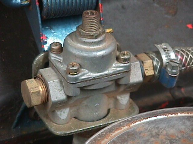

  13. YES. You will need several pounds of extra fuel pressure when the bost goes up.
    Like someone else said here, it needs to be several pounds more than the boost level.
    I turned a Holley fuel regulator into a boost-referenced regulator. I used a small copper tube that ran to the carb enclosure for the boost signal to tell the regulator to increase the pressure.
    I don't have my old drawings, but here are the basics...
    The Holley regulator used a diaphragm that was exposed to the atmosphere on one side (by a tiny notch in the case under the adjuster screw), and the other side of the diaphragm was exposed to the fuel pressure.
    At the bottom of the regulator case was a setscrew with a locknut where you could adjust fuel pressure by turning the screw against an internal spring. It used the very same principle that a mechanical fuel pump uses for regulating it's own pressure, only the spring is adjustable.
    In a normal mech pump, the diaphragm spring keeps the fuel pressure about 5 lbs over atmosphere. When you stiffen up the spring, the pressure goes up.
    The regulator does exactly that in the same way.
    In fact, the Holley regulator we used is built just like a mechanical fuel pump, but without the cam lever. Basically a diaphragm, valves, and spring in a can, but without the lever.
    If you send boost pressure to the "atmosphere side" of the diaphragm, it tricks the regulator into raising fuel pressure to 5-7 lbs (or whatever you set it to) over BOOST pressure instead of 5-7 over atmosphere pressure.
    That is also the exact method Studebaker used to modify their mechanical fuel pumps for their supercharged models- They simply took the stock mechanical fuel pump, drilled the tiny vent hole in the pump case to accept a screw-in fitting, and then ran a small line to the carb in order to send boost pressure to the pump diaphragm so the pump would always stay a few pounds ahead of the boost pressure.
    We did exactly the same thing with a Holley regulator that regulated our high-pressure electric pump.
    That way the fuel pressure will follow the boost pressure and keep you supplied. Without it, the fuel flow will simply stop when boost goes up enough to counter the low fuel pressure.
    I wish I could find my old drawings of what we used on our race car.
    If you have 9 lbs fuel pressure, then reach 7 lbs boost, you are most likely starving it of fuel. You need a bigger pressure differential than that to keep it flowing fast enough to feed the engine, especially when it gets thirsty.

  16. You're welcome.
    Here are a few pics of regulators of the type we used.
    I will have to describe what we did to them. I can't find my old pics.
    The fuel fittings are the normal "IN" and "OUT" with a gauge port that you can either plug or stick a gauge into.
    You can see the fuel pressure adjuster screw with the locknut on it. That is how you set the pressure. Turn the screw against a spring inside the case.
    What I did was to take the adjuster screw out and replace it with a drilled, hollow screw that I could attach a hose or fitting to.
    On one car, I simply drilled the screw (it was made for an allen wrench, so I drilled right into where the allen wrench was supposed to go) and brazed a copper tube right to the screw, then put the screw back in. That became the boost-port to tell the regulator what to do.
    The "boost-port" hose must be connected to the carb bonnet where the boost is, or to the carb enclosure, but NOT TO THE MANIFOLD.
    You MUST get rid of the small opening or small p***age that the regulator uses to reference the atmosphere.
    If you look very closely at the first picture where the locknut touches the case, you can see what looks like a small notch in the case right under the locknut. It's on the right side of the picture under the nut. (click to enlarge)
    That is the tiny p***age that lets the regulator compare itself to the atmospheric pressure.
    You need to completely block that small notch/p***age, and hook it to boost pressure.
    On mine, I filed the case surface under the nut so it became flat, then used a soft copper washer/gasket between the case and the locknut. That kept it from sampling the atmosphere pressure.
    You could probably use a small dab of epoxy to fill the notch if you dont want to modify the case.
    The drilled adjuster screw with the copper boost-tube attached became the new "vent" that told the regulator to regulate the fuel pressure a little bit higher than "THIS BOOST PRESSURE AMOUNT" when I connected the tube to boost pressure.
    Instead of only a few pounds over atmosphere, it was several pounds over BOOST pressure.
    Next, you need to find a pump that will deliver at least 8-10 pounds above whatever boost you expect to reach at the highest levels, then adjust the regulator to deliver only about 4 or 5 lbs over, or 6-9 lbs over whatever the boost happens to be at any given time.
    With experimenting, you will find the fuel pressure you think works best with your usage. (4 lbs over boost, or 7 lbs over boost, or 8lbs over boost, etc). Just remember that it has to stay at least a few pounds over boost level at all times or the fuel won't flow.
    With ours, I think it liked just a few pounds fuel pressure over the boost pressure at the lower boost levels, and more like 8-9 or so pounds over boost level when we reached 12 lbs boost and higher.
    When we eventually pumped in boosts of 22 lbs and higher, the fuel pressure skyrocketed, and we had to come up with a modified version, but that is another story that you probably won't need quite yet.
    This was all a number of years ago when I couldn't get enough of racing. I wouldn't be surprised if I hear that they now sell boost-referenced regulators to the turbo people, and you don't have to modify them like we had to.
